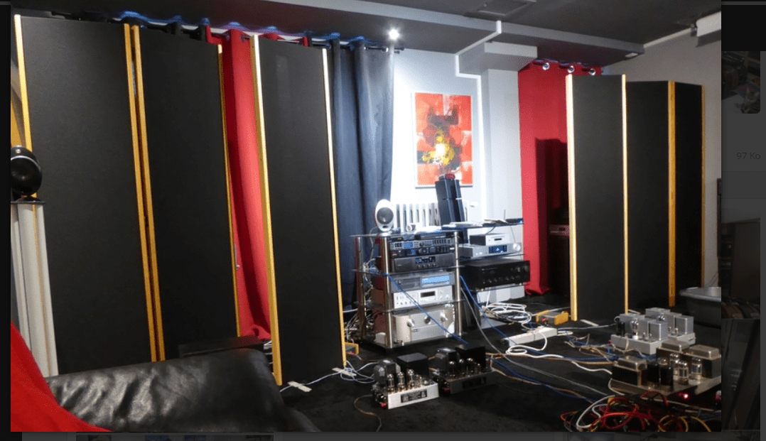

The only class D "wide band" amp that I heard was a 4x900W by Behringer, driving a pair of Magnepan Tympani IV though an active crossover. That Behringer class D amp is in the left rack, second from top - I don't remember the model :
My listening impression was mixed... Of course this amp was capable of the huge power to drive loudly the 84dB/W/m of the Tympani IV, but it seemed somewhat agressive, piercing to my ears in the highs, which were possibly too much set at the forefront ? My friend relied on its microphone + DSP room equalizer... 🤔
When we shifted to my tube amps (on the floor), we had to reinstall the OEM passive crossover of the Tympani IV, and while the power and loudness were inferior (even with the 2x70W KT88 amp at the extreme lower right), I felt that the tone was more balanced and smoother... I wasn't too surprised but, to be honest, since the setup was completely changed, I said to my friend "IMHO, we are comparing Apples and Oranges, you know !". We draw the conclusion that the comparison was... Inconclusive ! 😀

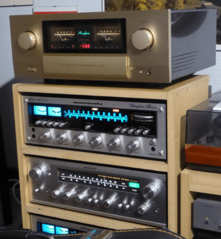

Yes, at least for now, I would not trade my oldies, my tube amps and my Accuphase E-560 (2x30WRMS Pure Class A) for a class D unit...

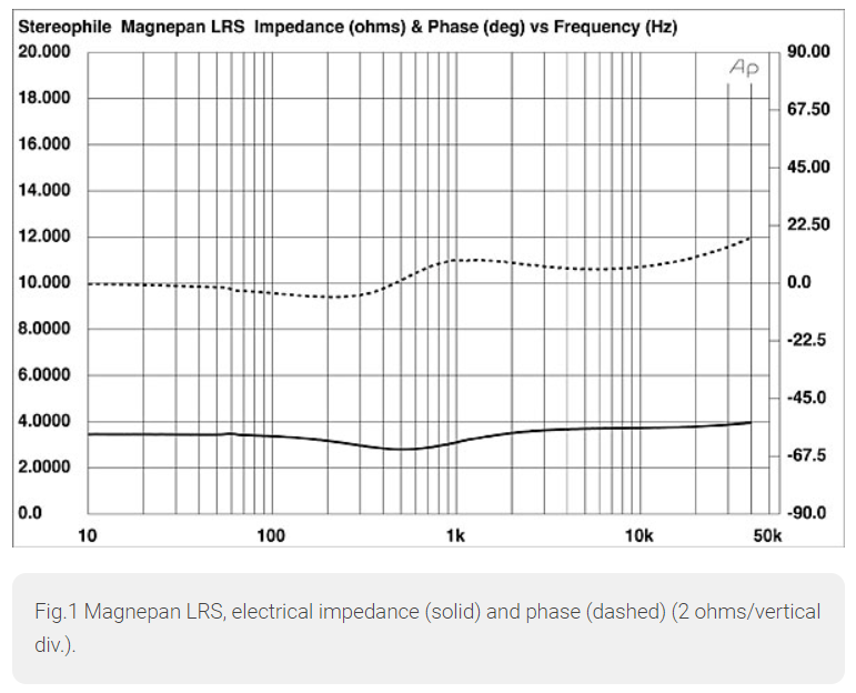

The Tympani IV are magneplanars, not electrostatics but electrodynamic plane speakers. Conversely to the statics, they are very easy loads for the amplifiers, so the Berhinger had no issue driving them...
Here is for example the impedance and phase curves of the new little Magnepan LRS :
In my 4-ways project, I'll stay passive, but indeed I'll avoid a crossing frequency in the 800-2500Hz, which is the crucial midrange band, where any imbalance, any rupture in tone homogeneity is usually detrimental... I plan to go circa that way :

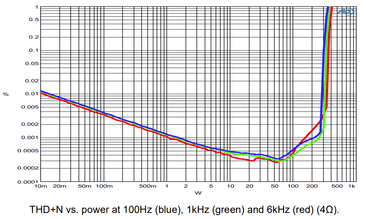

This is the performance from the datasheet NC500 provided to OEMs:
A higher level of performance has been available for DIYers since at least as early as 2012, albeit lower power. We can all thank Bruno Putzeys and Jan-Peter van Amerongen, founder of Hypex. At this time, it had already leapfrogged B&O Icepower, Pascal and Powersoft in terms of lower distortion at moderate amounts of power (20dBW). This is the DIY-only nCore400- not available to OEMs:
So that is 0.0003 THD+N (-110dB) as it approaches 20-80W (4 ohms)

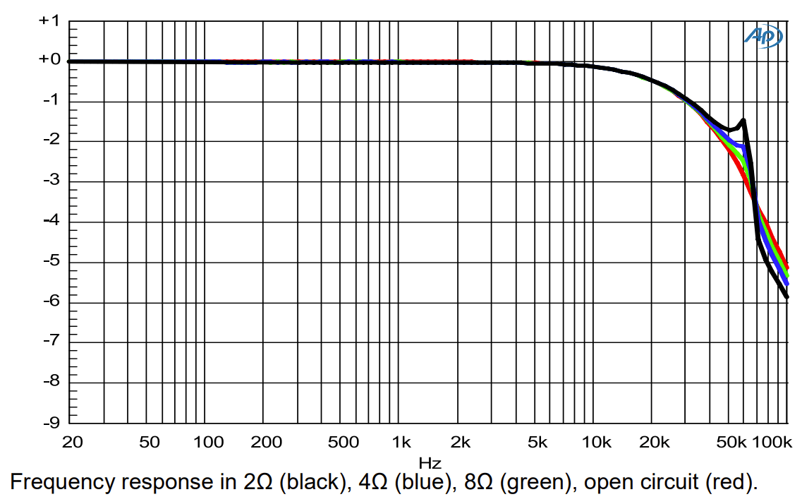

Here's the frequency response showing a -3dB point of about 60KHz:

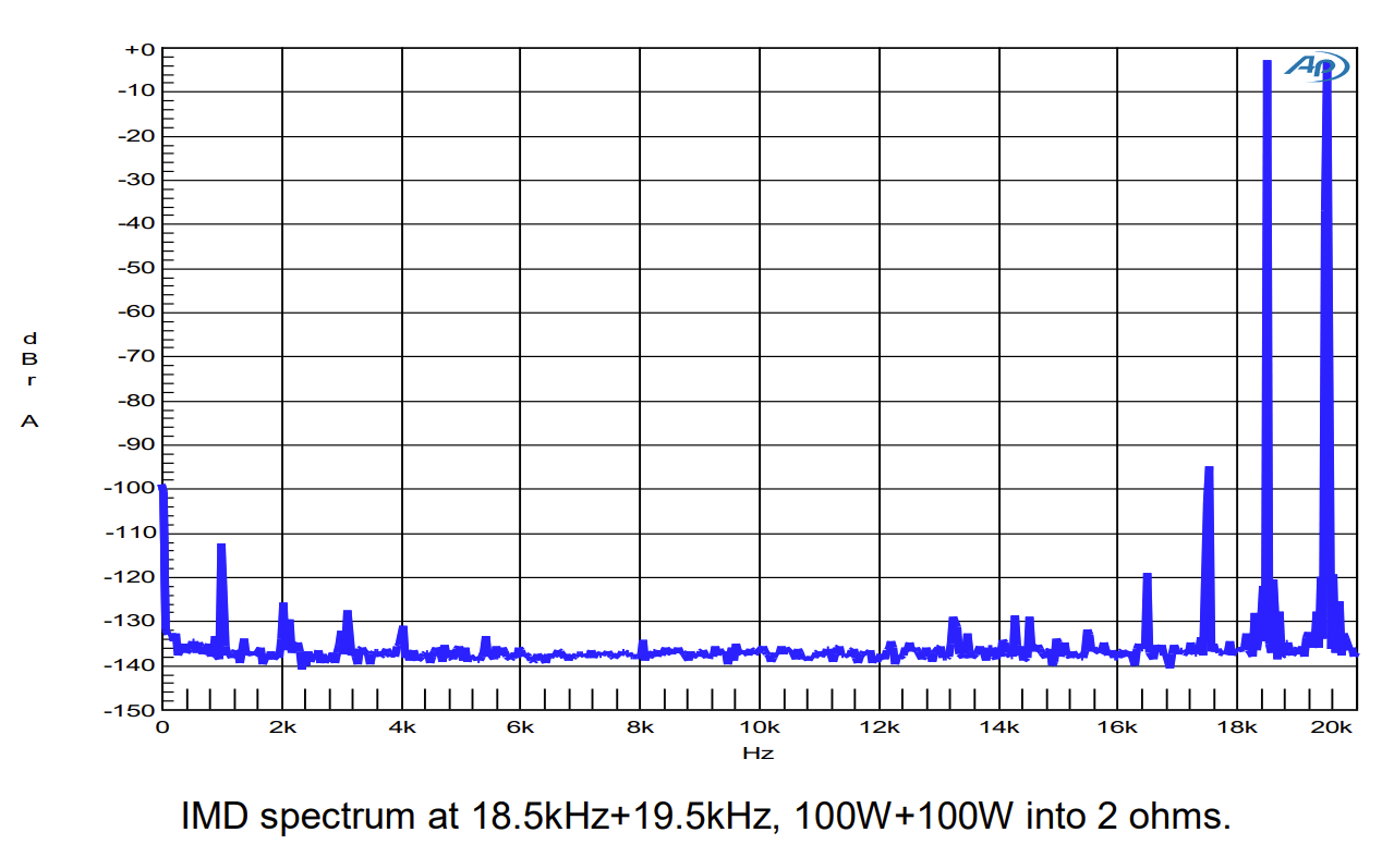

2 tone IMD:

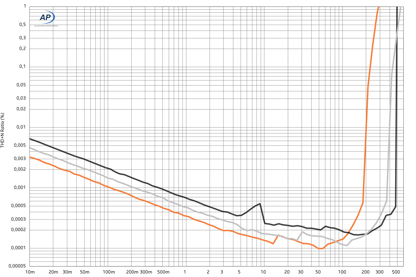

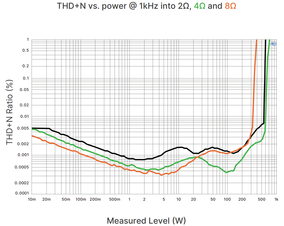

The latest generation DIY-only product from Hypex is the Nilai500:
THD+N vs Power into 2Ω, 4Ω and 8Ω
The font sizes are a bit small, but as @IamJF pointed out- that is 0.0001 (-120dB) as it approaches 10W- 100W, which is 10dB lower than the nCore400. On the right it approaches hard clipping at 600/400/200W.
The original founder of Hypex, sadly, passed away some years ago. And Bruno now works at Purifi.

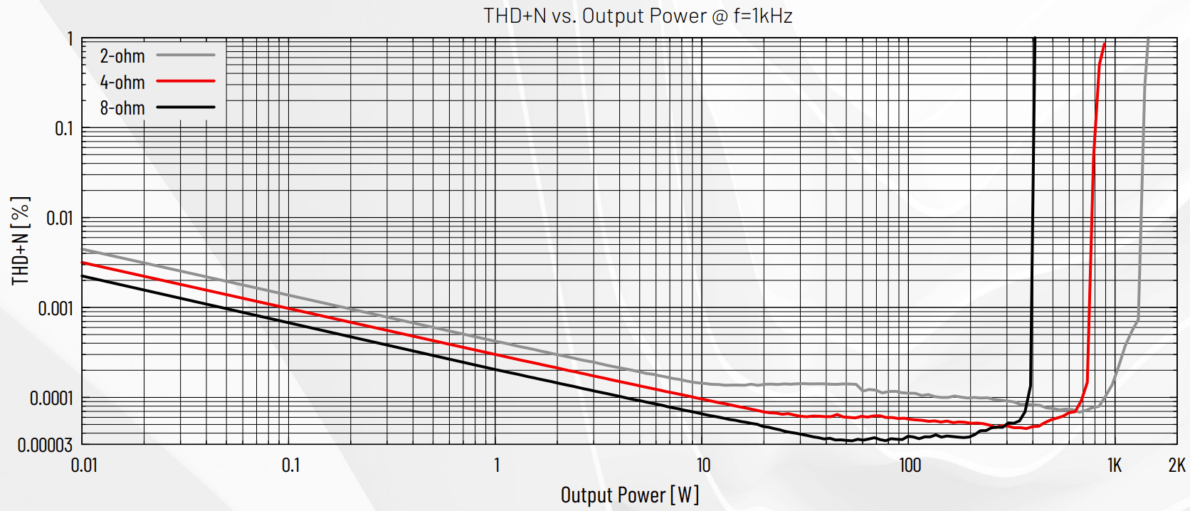

This is the latest DIY-friendly product called Eigentakt, model 1ET9040BA:
4 zeros before a significant digit-
0.00003 THD+N is -130dB

@tktran303 Very informative post. Looks like the switching frequency is 120k which is very good. The double hump typically found with class D isn't pronounced, so it may be worth another listen. The specs look good but it may still need some more specific "flavor" in the form of a little 2nd order HD. Their smaller modules may be a good option for bi- and tri-amping.

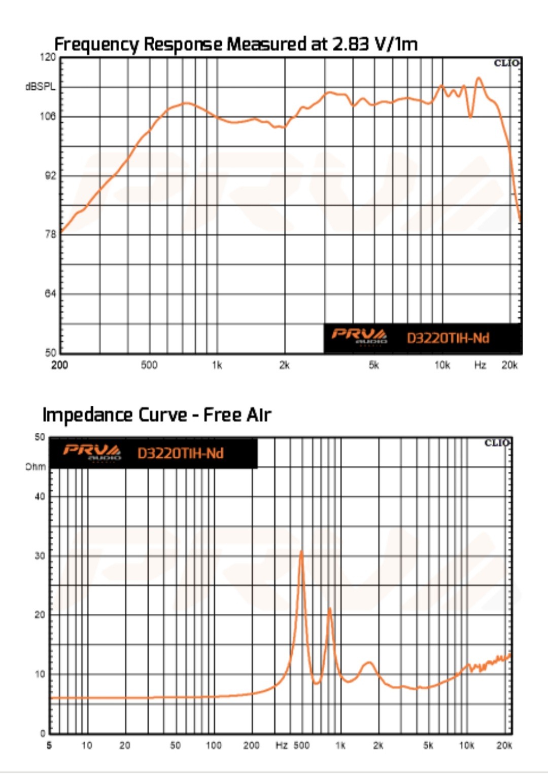

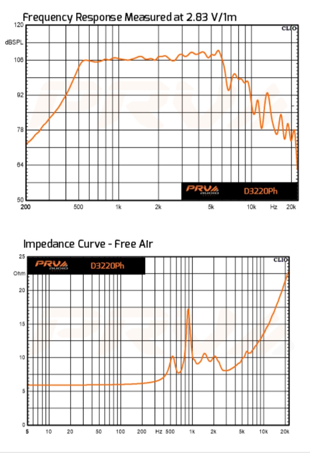

Well you can look at some of the hybrid compression drivers with 3" titanium/PEEK suspended diaphragms. The PRV D3220TI (2nd pic) plays well past 10k with the rear chamber removed and reasonably flat. The phenolic diaphragm calls it quits earlier but still very linear. There is also a pure Ti diaphragm available.

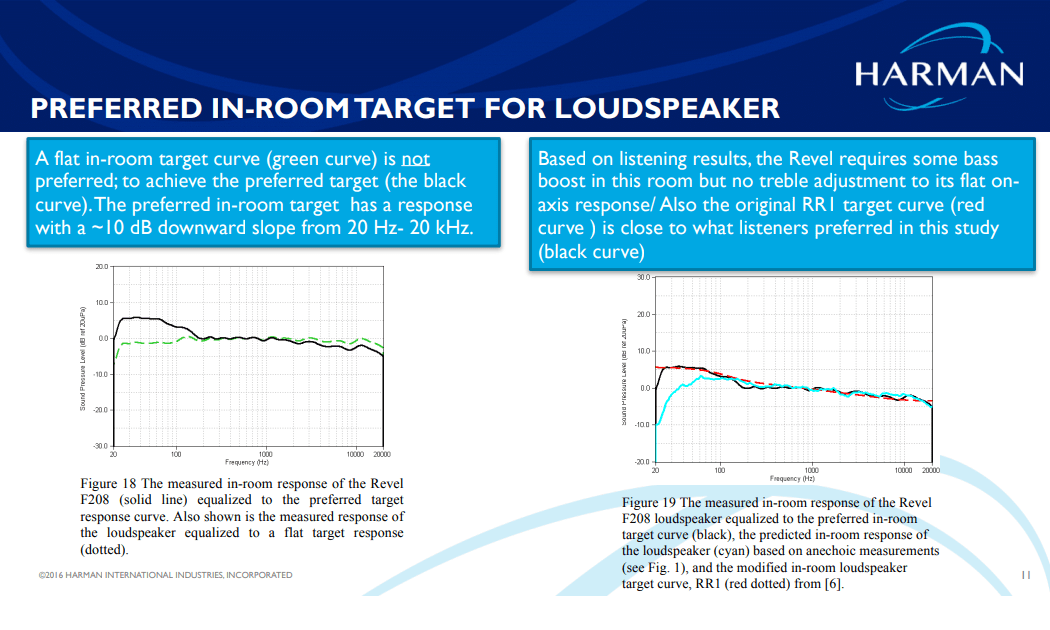

Quote below from here as it is freely available and has a lot more graph's and explanations that would be useful to anyone not familiar with this research
https://www.researchgate.net/public..._and_Calibration_of_Sound_Reproducing_Systems
"In the double-blind tests, listeners made bass and treble balance adjustments to a loudspeaker that had been equalized to a flat smooth steady-state room curve."
There is another graphic from one of Olive's headphone presentations that might be helpful to see what was changed vs the speakers native in room response without processing
All the listeners did with the tone controls was undo the EQ that had been applied and bump the bass a bit. Trained listeners don't go for quite as much boom and tizz as the untrained listeners.
I tested the same approach when I was equalizing my line arrays. I equalized the speakers to a flat in room target and then used a parametric EQ with shelving filters spaced an octave apart. I adjusted the gain of the shelving filters until the sound was balanced and then made some other slight modifications by ear until it sounded as good as I could get it. I preferred the bass to level out at 100Hz, I have the same dislike for rising sub bass in the Harman headphone target.
What is silly is to try and take the curve and apply it to all speakers with all different directivities and listening levels and expect it to work the same. It won't.
An approximate 1dB/octave fall in room for an ordinary cone and dome speaker with rising directivity at 80dB or below will sound good. Crank it 10 or 20dB and it won't sound so good, make the directivity much more constant and it won't sound so good.
Have you heard the Revel F208?
An interesting choice because they are quite flat/recessed sounding speakers.The dip in response 2000-3000Hz has been blamed for that.It does not look like much but the lack of presence and projection is very obvious when you hear them.Average punters might like that presentation I suppose because it sounds warm and smooth.I would just call it flat and dull.

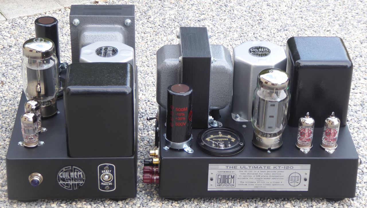

Sorry, I am also not the kind of tribune who think that when it comes from China and is cheap, it's Junk... I have at least on example :

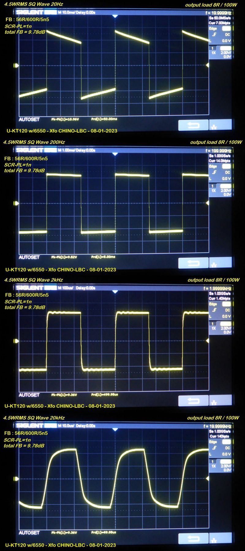

The output transformer of my DIY Ultimate KT120 Single Ended mono blocks comes from China, unknown brand. I paid 120 Euros for the pair, 2nd Hand :
Looking to the waveforms below, these Chinese transformers could hardly be qualified as Junk per se :
