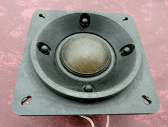

Anyway i have two of these quite old Vintage ITT lpkm/105/37/120
i wonder if they are of any value I liked the little lens
German domes look quite well built usually

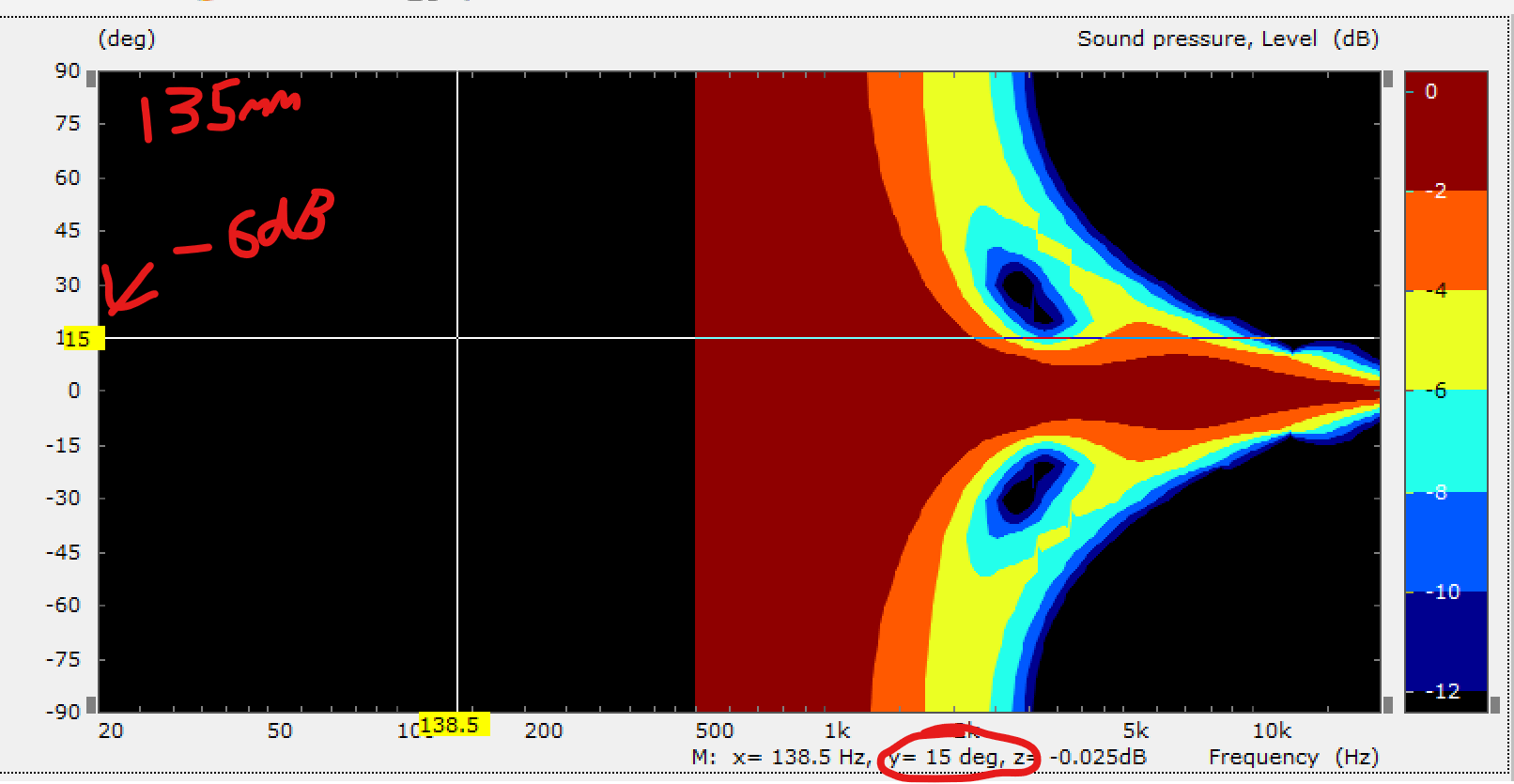

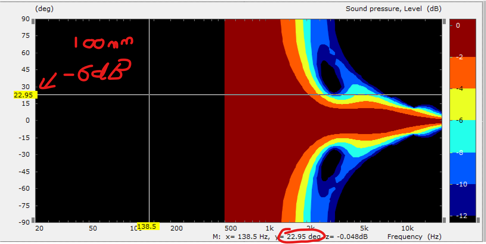

Quick sim of two 100mm drivers (could be 100mm mid-bass with tweeter in 100mm waveguide). 3 KHz LR-24 xover.
Driver spacing of 100mm (0.9x 3KHz wavelength) gives us a -6dB point in the vertical axis occurring at 23 degrees.
Driver spacing of 135mm (1.2x wavelength) gives us a -6dB point in the vertical axis at 15 degrees.
The 'black hole' in the polar response with 135mm spacing is closer to the listing axis, but on the other hand is less pronounced than with 100mm spacing. Depending how we weight the directivity index, either one might looks better than the other.
Reactions: stv
That's exactly the point - control the vertical off axis null so it is not in the ceiling and floor reflections.
This works for a "standard" listening position and shows better in room response when you calculate with these angles for the reflection. But when you have a different listening situation or a bigger listening area ... or even different listening heights ...

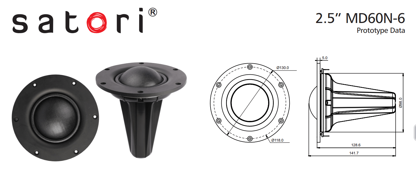

So I prefer to do room acoustics and put chassis as close together as possible. I routed the front baffle of the MD60 to get closer.
But my background is prefessional listening. Good rooms and also close listening distances, somtimes also listening in standing position. That's often not the case in an average living room, there a bigger distance can be beneficial.
And I am also a coax fan, close drivers get closer to that experience.

That ITT dome mid is very good. We used it often in the 80s for 3 way projects with the Audax TW025A0 soft dome and an 8" or 10" Heco woofer in acoustic suspension box. Those older 2" soft domes were good at playing back orchestral band and jazz. Philips, Heco and LPG also sold some nice mid domes back in the day. The Audax mates well with them, but tends to get a little muddled with louder, more complex and heavy brass sections. Some of the Seas tweeters performed better, but cost more. The Vifa D25AG35 was one of the best alloy domes available at a reasonable price back in the day. It blended very well with most dome mids, even the D7608.
The ITT dome mid performed well with complex, dynamic music. A decently behaved metal dome will mate very well with it, conveying the more dynamic and harmonically weighted material.
Not considering off axis response alone, while you can get away with crossing a 2" soft dome mid like the ITT higher than 5k to a soft dome tweeter, don't be tempted to cross the same mid much higher than 4k to a refined and metal dome. That usually makes the sudden jump in harmonic character more pronounced at the point the mid hands over to the tweeter, even if you discount the off axis behavior of both drivers. The mid won't be as detailed / clean despite what it's FR is leading you to believe. The linear response fools you into thinking its is still playing clean, but you're almost at the 2" mid's natural breakup mode at roughly 6 kHz, when the tighter and more present sounding metal dome is just taking over. That sudden shift in the harmonic balance will ruin continuity and draw negativr attention to itself. That spoils the entire tonal character of the speaker
Crossing higher to most soft dome tweeters isn't so critical because the tweeter is already starting to play in partial breakup mode and won't shift the overall acoustic character as drastically.
Most of the time you don't want to blend diaphragm types between mids and tweeters, but it depends on the type of cloth and surface treatment used on both the mid and tweeter. You can even mate a planar tweeter to a soft dome mid if the crossover point is carefully chosen, mainly due to the narrow vertical pattern most planars.
