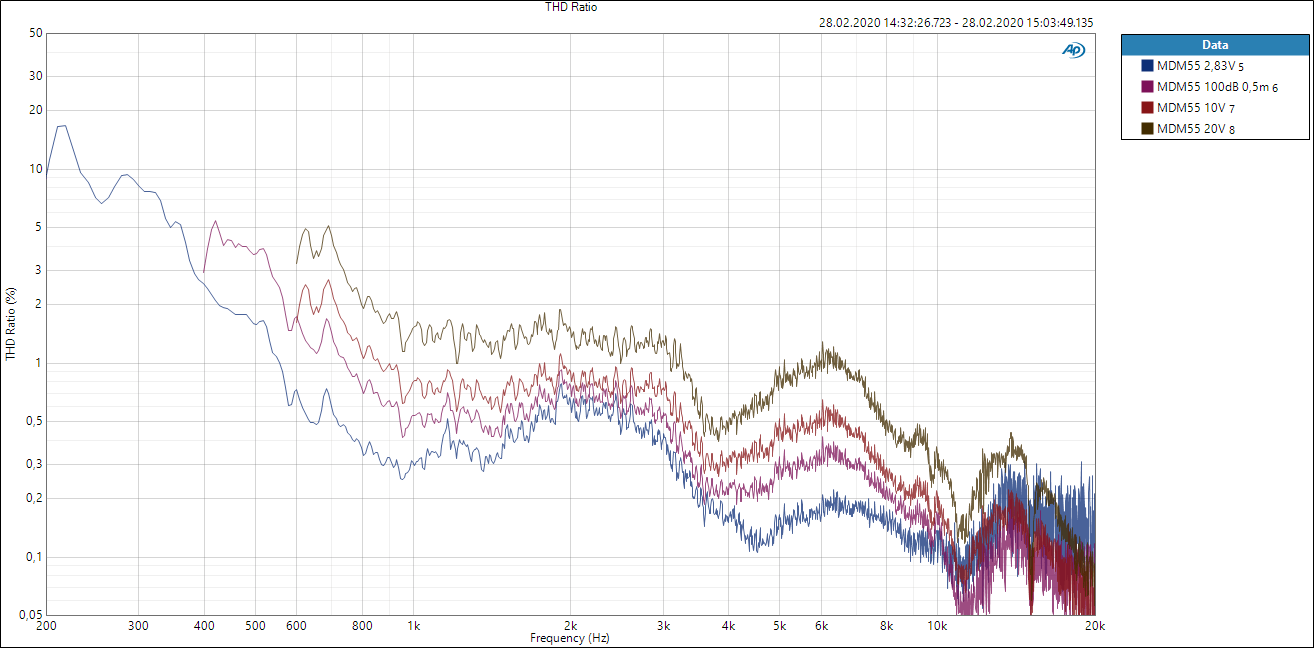

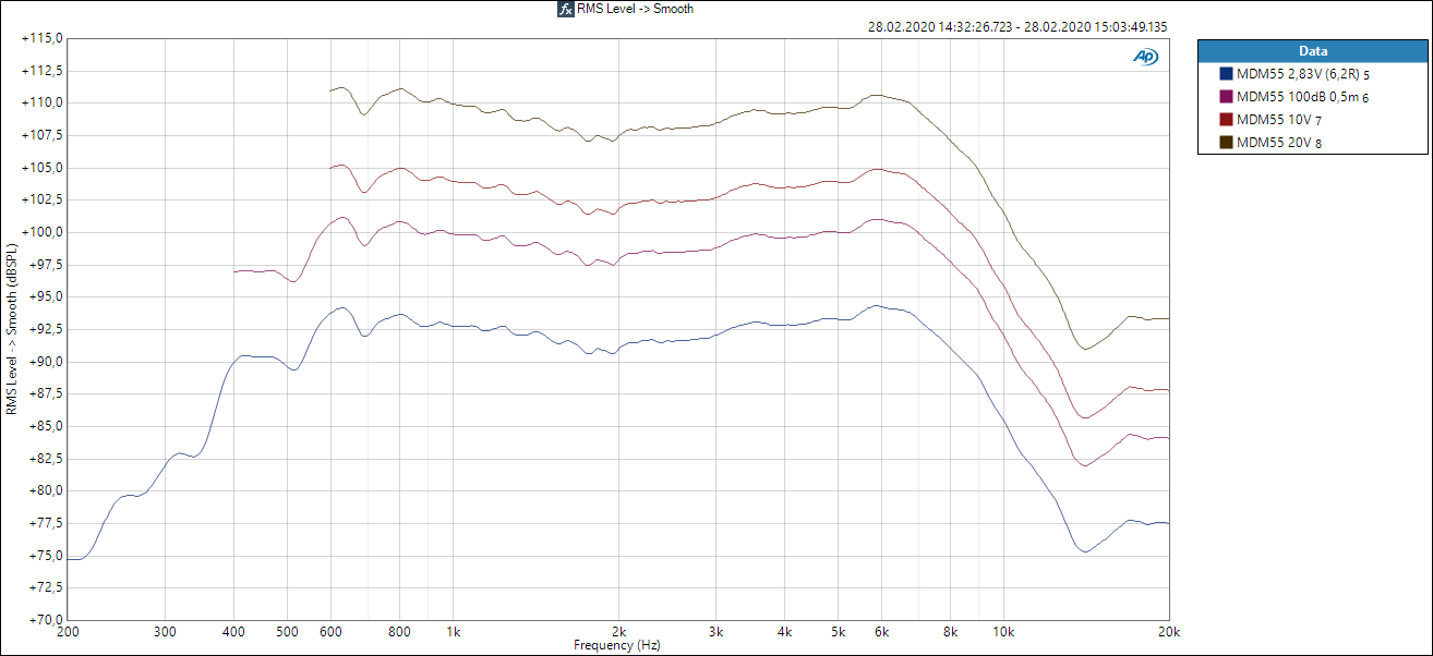

I have used a mdm55 crossed at 750Hz -12dB for a long time now. Imo it works great with a 15” woofer in a closed box. The 15” uses only an inductor in series. I’ve gone through 4 or more types that blew up, not one mdm55, but I do not blast it like I used to. I also use a mdt30 as a tweeter, crossed at 3.8k iirc. For the price, the mdm55 is unbeatable, not very many drivers have been in production that long, has to say something don’t ya think?
The ATC dome originally had a straight waveguide. The flare came much later.@ nicoch58: I don't think so. ATC waveguide is flared; this one is straight (Volt).
The MDM55 (or CAM558) is a great mid in many ways, especially for the price. I've used them crossed at roughly between 800 - 1000 2nd order with dual 6 - 8" woofers. They image very well and easily disappear into the room on the correct baffle. I like to use the CAT378 tweeter with it due to the acoustic center being already perfectly aligned. A 4k xover is perfect with these. The mid has the right sensitivity to work with dual LF drivers, each having 86 to 88 dB/2.8V.
The MDM55 doesn't have the last word in resolution but it has plenty of it to compete with alot more expensive mids which don't have the bandwidth or off axis performance. A way around the relatively high necessary HP is to use 2 of them with staggered LP filters so only one operates up to the tweeter LP. This also improves THD, raises SPL capability and reduces the amount of the BSC needed to work on a narrow baffle. You can drop the HP to about 600 hz 2nd order this way. The 2mm peak to peak xmax is more than enough to keep up with the LF drivers.
The MDM55 / CAT378 combo makes for a capable, transparent mid field monitor. I'm using this recipe in some smaller monitors for my son's studio with dual Morel CAW538s in ported 30 ltr enclosures crossed at 900 and 4k 2nd order. This driver package manages quite a bit of SPL and dynamics in a very small package flat down to 50 hz. While the smaller Morel 5s don't have the lowest THD compared to other smaller LF drivers, they have highly resolving midbass and no detectable power compression thanks to a pair of huge 3" VCs. This package is able to convey complex material precisely with good balance of harmonics and accurate timing. They definitely pass the piano test with flying colors thanks to their clarity and natural character in the mids which IMO only can be provided by a decent dedicated midrange dome.
So much cool info on the mdm55, something I took a chance on many moons ago. Great idea on using two of them with a custom passive crossover design.

When you search for a 2" midrange for low crossover the Dayton aluminium is the right choice. Couldn't find good measurements but it's very linear at low and high frequencies. But it's very high resolution, I put it 1-2dB lower to get a balanced midrange. And I also used 2 to get more membrane area.
How would you compare the resolution of the MDM55 vs. the D7608?The MDM55 (or CAM558) is a great mid in many ways, especially for the price. I've used them crossed at roughly between 800 - 1000 2nd order with dual 6 - 8" woofers. They image very well and easily disappear into the room on the correct baffle. I like to use the CAT378 tweeter with it due to the acoustic center being already perfectly aligned. A 4k xover is perfect with these. The mid has the right sensitivity to work with dual LF drivers, each having 86 to 88 dB/2.8V.
@Paul Ebert I'd rank the MDM55 just shy of the D7608 in terms of overall performance. Its a little more laid back in detail but is easier to use with other soft domes crossed above 3.5k. The D7608 has a bit more detail and air all round. It can seamlessly blend with a metal HF dome or a ribbon which the Morel has issues with being a little more vague up top.
