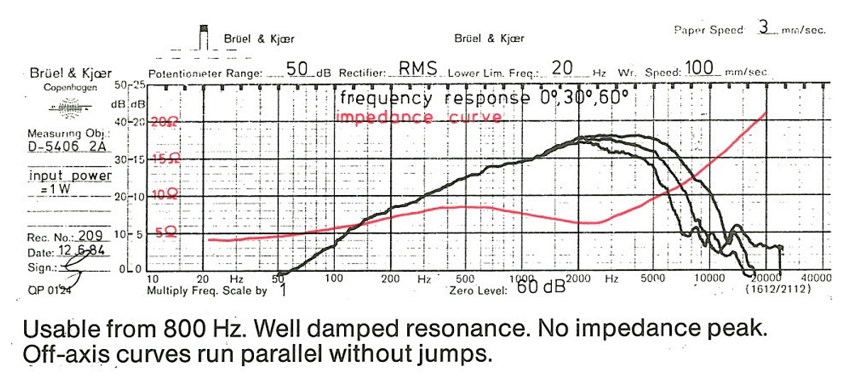

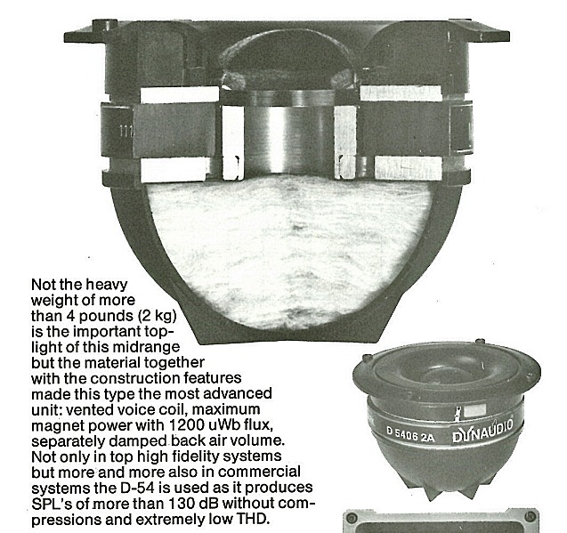

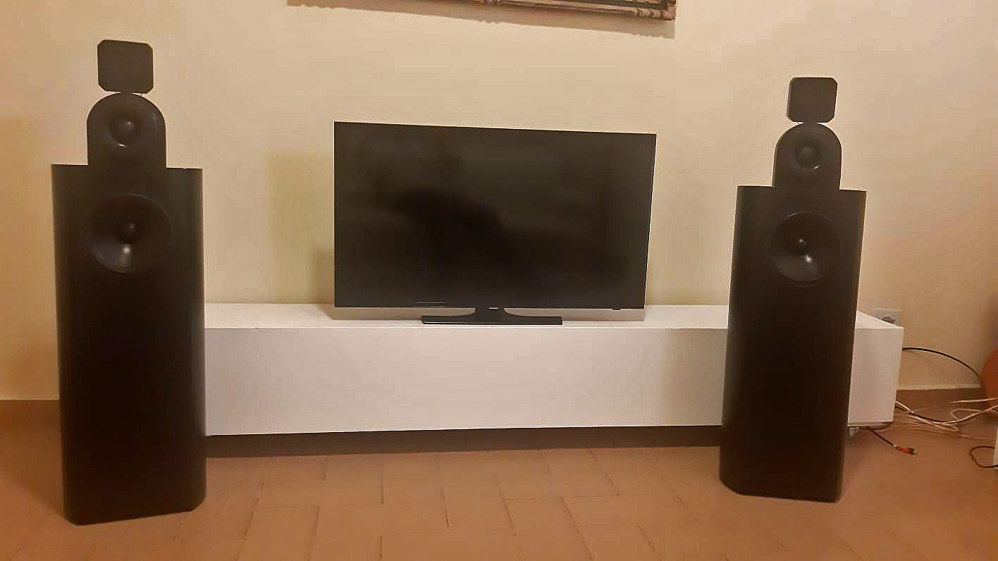

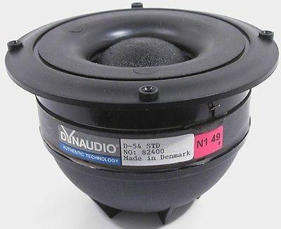

I am using my Dynaudio D54 dome midrange (54 mm dome) drivers for about 40 years now. I build some eletrostats in the day's which gave great clarity but i missed the more point source and punshy sound with more body in the mid range from my Dynaudio D54 drivers. They are limited about frequency range and i use them from 1200 Hz to 5 KHz where the Visaton RHT12S magnetostat takes over. They blend in very well with the mid range. My Vifa 21WP250 does all the heavy lifting in the bass and low midrange (40 - 1200 Hz) with a nice responce without ringing so i can use 6 dB filtering. The TL subwoofer does the work below 40 Hz. The D54 sounds great with all kind of music but excels with guitar, voices, saxophone and jazz in general, but is not shy from techno and other electronc music.

D54 is a great mid dome, even by today's standards. It can't be crossed as low as the newer breed of neo domes, but above 800 hz it does things very well, even better than most other 50mm soft domes do in regards to dynamics and detail.
I agree about dynamics and detail and also the benefit of wide dispersion of these domes. The frequency curve starts to be more flat above 1 KHz. Because i use 6 dB filtering i choose 1.2 KHz to avoid distorcion at higher levels. These domes have problems with lower midrange because of their limited size and excusion but for me, one of the best i heared, even compared with ESL. I am not a fan of line imaging.

@profiguy That's a great dome midrange as well, i think the same 54 mm dome with hexacoil and a smaller (but still big) magnet. Second order already makes a big difference, i crossed mine even lower, around 600 Hz 6 dB, but had a lot of distorcion so i double it to be sure. Sound wise i do not know if there is much diference between D52 and D54? These domes are still top of the line, i believe.. ;-) Looks like not so much has happend in the last 40 years about a major jump in basic speaker tech..

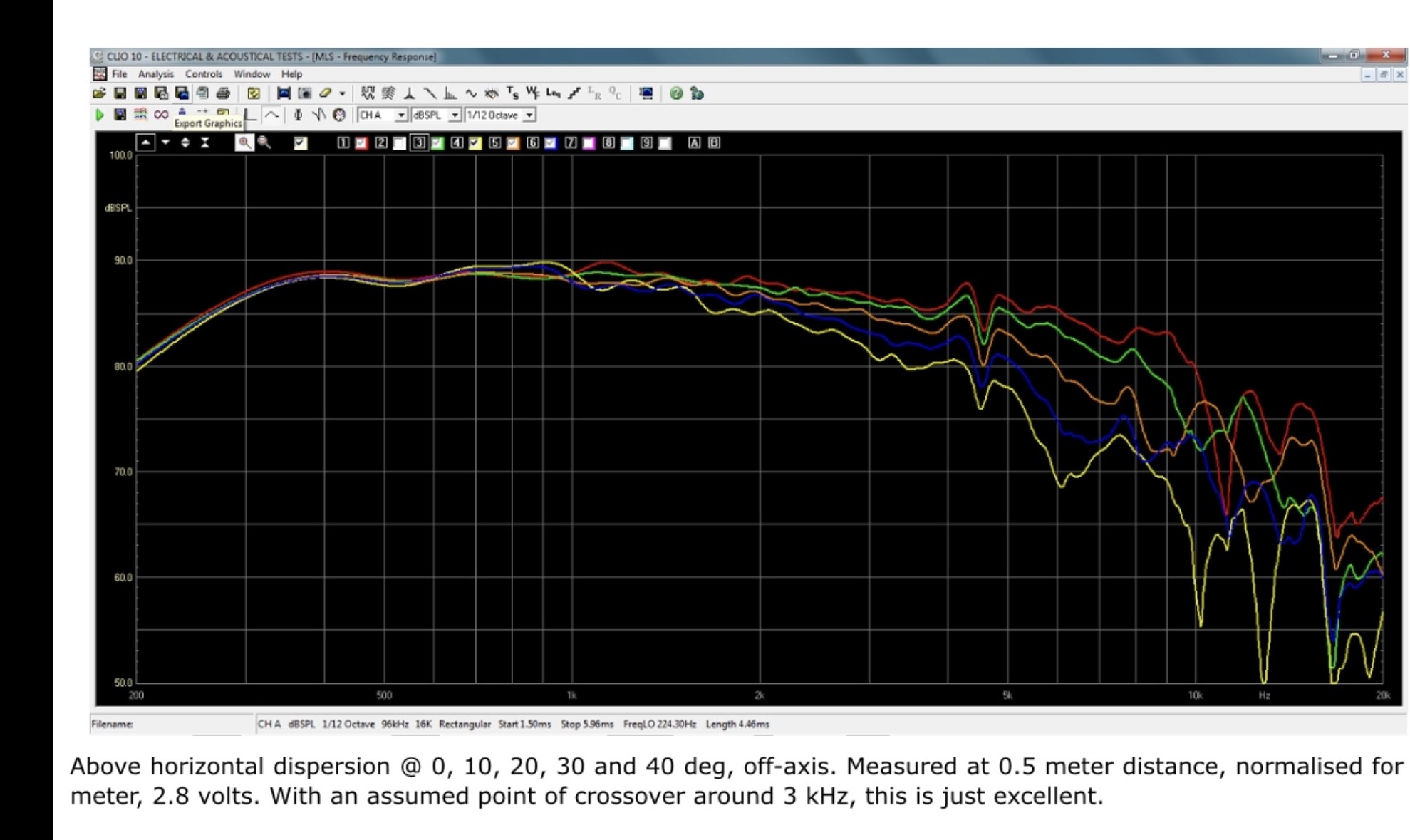

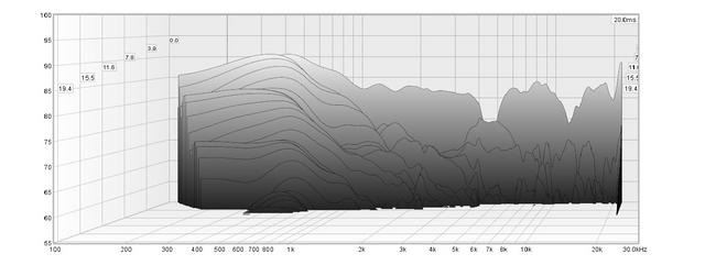

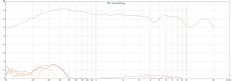

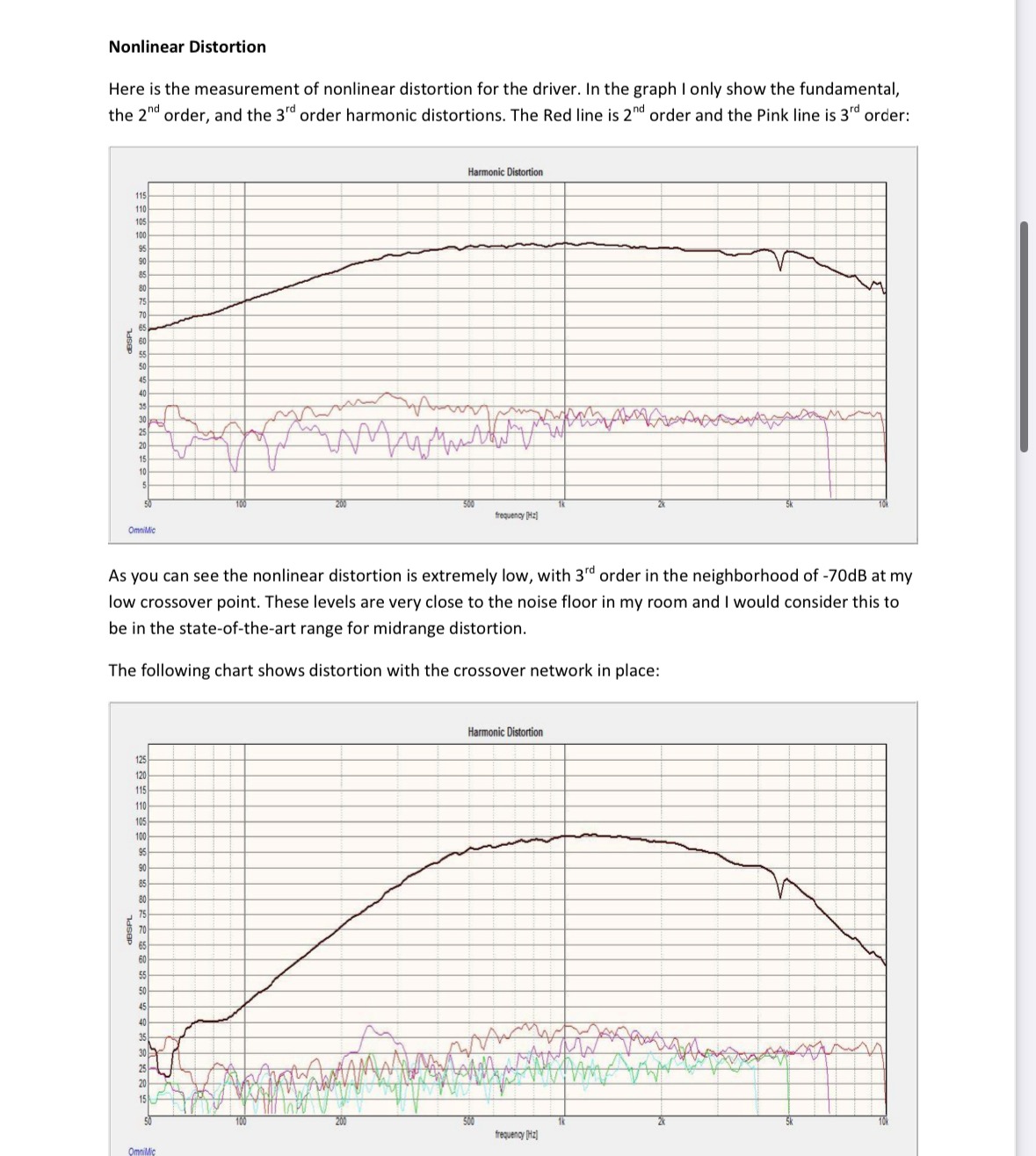

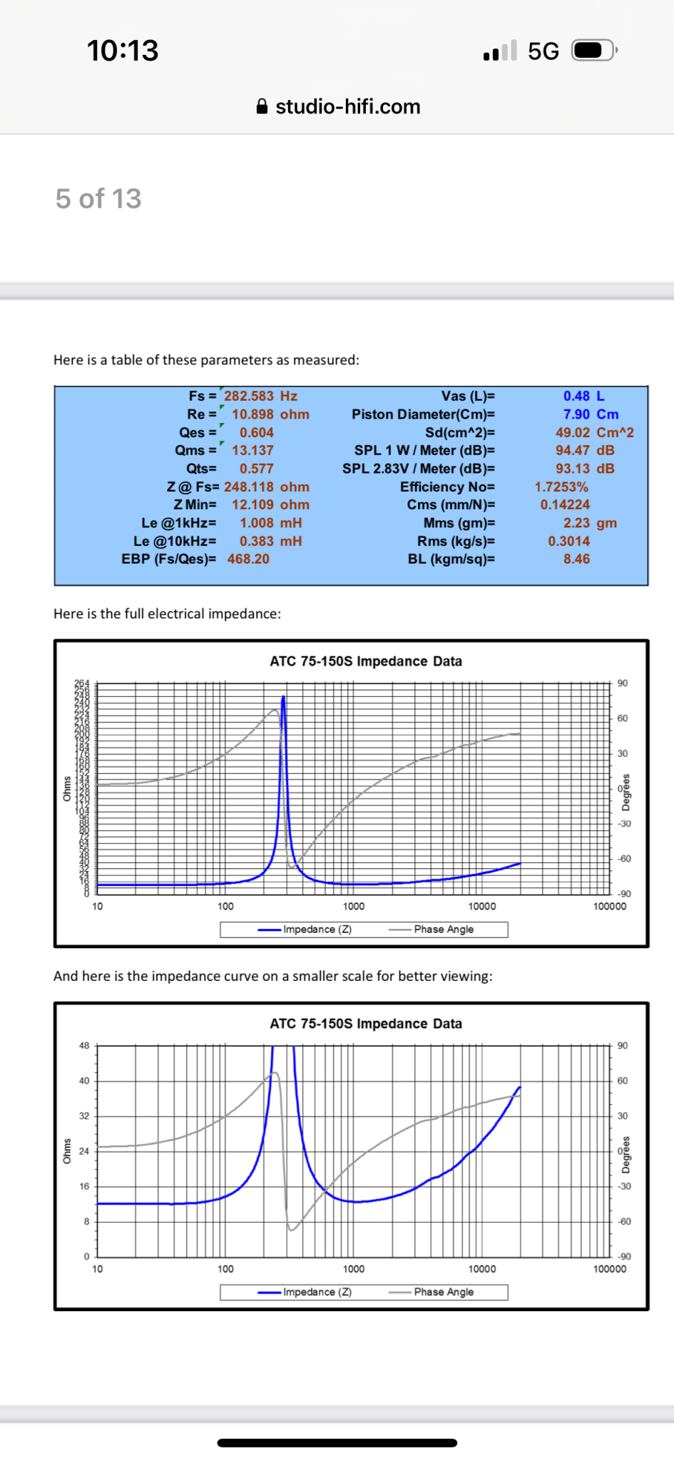

Troel’s G had some good measurements of the ATC dome. Some other data from the late Geoff Bagley.
