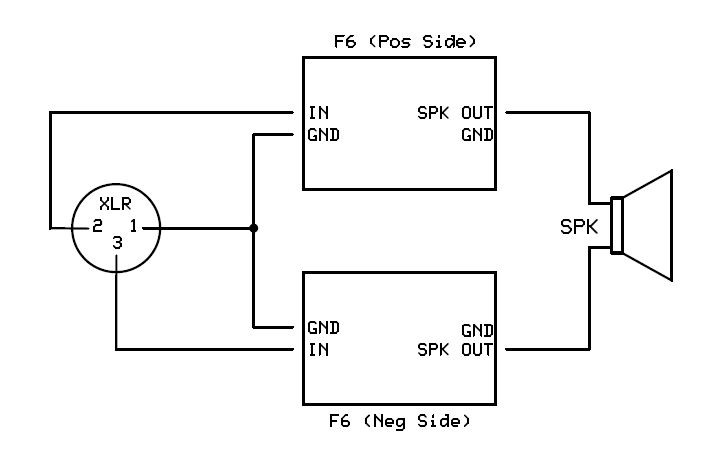

Hi all,
My first plan was to build two F6 for bi-amping, I had already ordered 2 set of boards, power and signal transformers, jfets, and all others components, but reading some publications the idea to setup a bridged style configuration come to my mind, not looking for more power, just to keep the balanced signal from preamp.
I had in my stock or I had ordered components in quantity that permits good matching between all boards, so matching should not be an issue.
I’m a newbie with very limited knowledge of electronics, but had some experiences building other DIY projects like Aleph 2, F5 Turbo v3, UGS and Borbely balanced preamps, NJFET RIAA, etc., so I want to ask some questions to see if the attached picture configuration is possible
1) The Idea is to feed the input of each F6 stereo configuration with positive, negative and ground signal from a single balanced output from preamp as in the attached picture, also no single-ended input will be supported.
2) My speaker’s nominal impedance is 6 ohms, as far I understand the impedance load that sees each amplifier channel will be in this case the half of the impedance of each speaker, so in this case will be 3 ohms. Does F6 support this low impedance?, There are something or component in the F6 or power supply to specially take care in this case?
3) The power output of the F6 will be increased, decreased or keep as is, compared to a standard F6 configuration?
4) Mr. Pass in the document “Talks at Burning Amp Festival 2012” where he present the F6 amplifier, shows two possible power supply’s, one for mono and other slightly different for stereo configuration, in the case of this bridged style configuration which should I use?

1.OK
2.just make properly beefed PSU - say 350VA xformer per channel , appropriate (minimal) amount of capacitance is 8x15mF , per FW recipe
3.theoretically , bridge config will give you 4x power comparing to origin (half of bridge) ; practically , count on 3x ; so - you're already in who cares area
4.use one common PSU for both halves of bridge

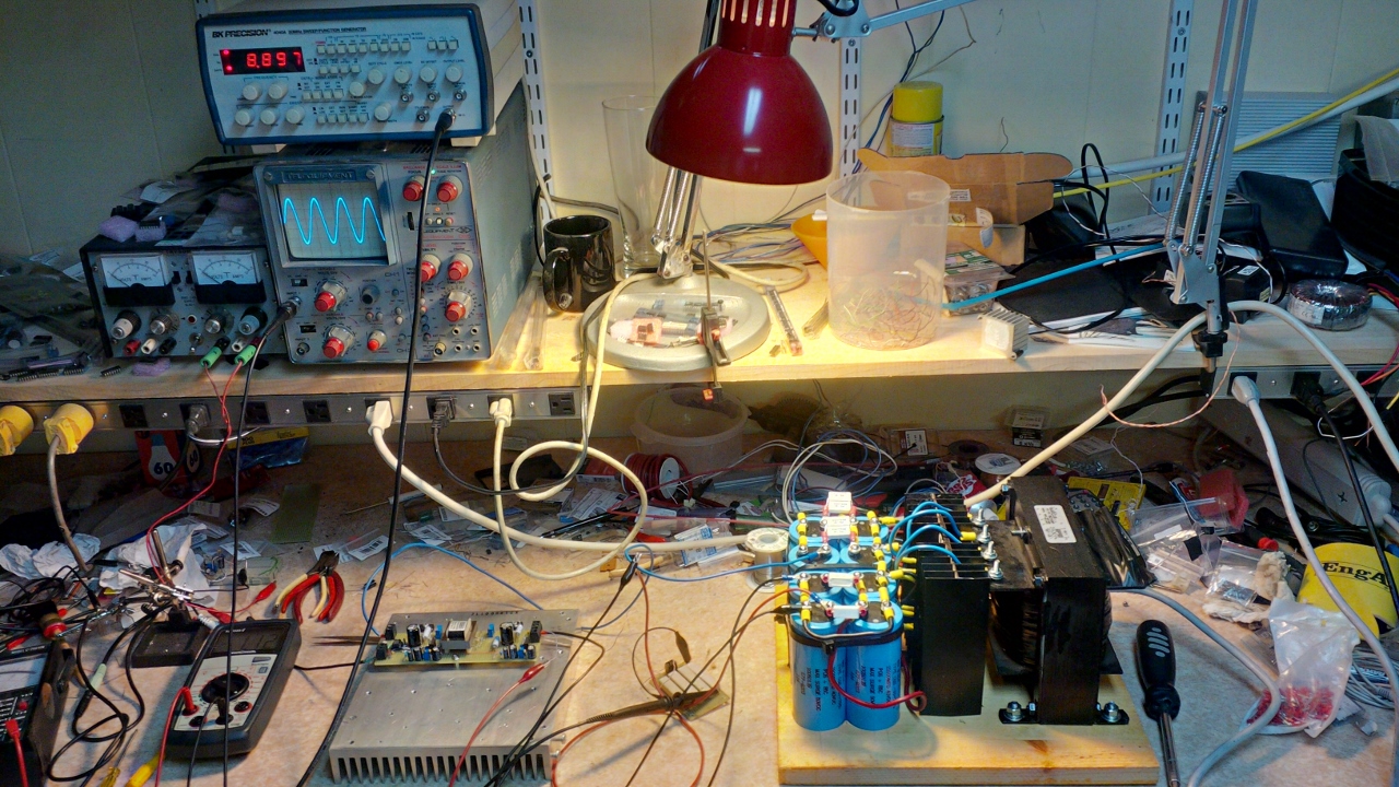

Just fired up the F6 running tests as we speak.
I built the F6 with the HA5002 buffer chip as the front end as I have plenty and is used in "The Albert". Since this is a high speed buffer chip it has excellent qualities for driving the F6 low output and high input impedance and a massive slew rate of 1500V/uS.
I'm running a slightly higher supply voltage of about 33V DC as the 1500VA 24VAC 24VAC transformer was available and have the buffer chip able to swing +20 -20V and as you can see I'm driving an 8 Ohm dummy load and getting about over 50 volts pp with just over an amp consumption. Yes the heatsink is getting toasty but the current has been stable for over an hour and the offset is steady at 1mV.
I will be conducting listening tests shortly.
