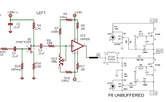

Hi ammel68 hope fully you can see this it is basically how it is connected.
I simply took the front end from Robert Nee Dance's preamp in Audioxpress and mated it together with the F6. The F6 I use the 9.1Volt Zeners for the Gate drive and I have used +- 20Volts for the supply to the HA5002 incredibly simple and effective.

Hello,
Okay...so you have several different voltages powering the circuit...+-18V going to the HA5002, 38V going to the JFET's drain through R4 and +-33V powering the F6 circuit?
Sounds like that's going to call for more than one power supply.
Does the 5002 not run too hot with 18V supplies? I see on the data sheet that 22V is the maximum.
Is the 50K trimmer for controlling offset?
I assume it's okay to hang a volume pot on the end of R34?
Thanks...

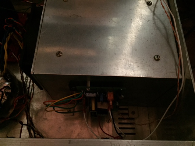

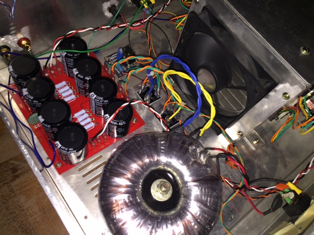

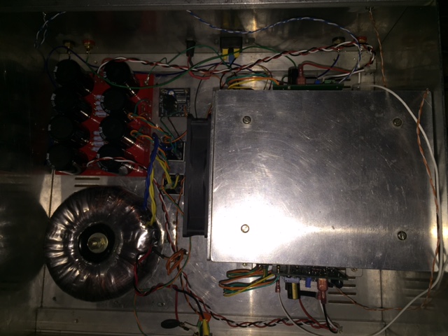

Second F6 Build
Thanks to Mr. Pass and forum members and this thread, I have been able to complete my 2nd F6 build. This time I built with IR MOSFETs unlike the first one with Semisouth ones.
I re-purposed a F5 chassis. The chassis design has a fan pushing air thru back to back connected heatsinks.
The amp is biased at 680mV measured on 0.47 ohms resistor, going close to target 1.5A bias current. Offset is stable around 4 mV. The fan design is quite efficient and there is luke warm heat on the heatsinks. I used the 9.1v zeners in this.
Quickly connected up and heard the amp. It has the F6 sound signature that I am used to. Clean, detailed with very high resolution. No hum or hiss. No startup or power-off thumps or cone movements. Cannot make out the difference between the Semisouth and IR based builds. To my ear, they sound similar.
Attached are some pictures taken in a haste. They are not fugly. I need to tidyup my wiring.
Thanks for all the help.
Cheers
Anil

Yes you are correct the preamp part of the circuit does indeed have various voltages. In fact the 38V is now 40V and the supply to the HA5002 is +-20V and they barely get warm.
I have been using this preamp for over a few months without issue. I will caution anybody working with these HA 5002 buffer chips they love to oscillate so careful grounding is needed. Since the Jensen transformer has winding resistances of 600 Ohm we are not driving the buffer too hard. Just a good clean sound is heard.
