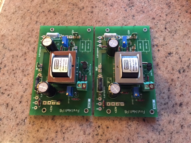

New F6 boards
Here are my new stuffed F6 boards. The boards are permaneder design. I managed to recycle the JFets from an earlier F5 amp.
Cheers.
