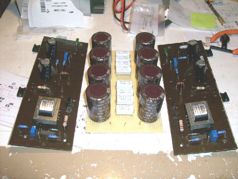

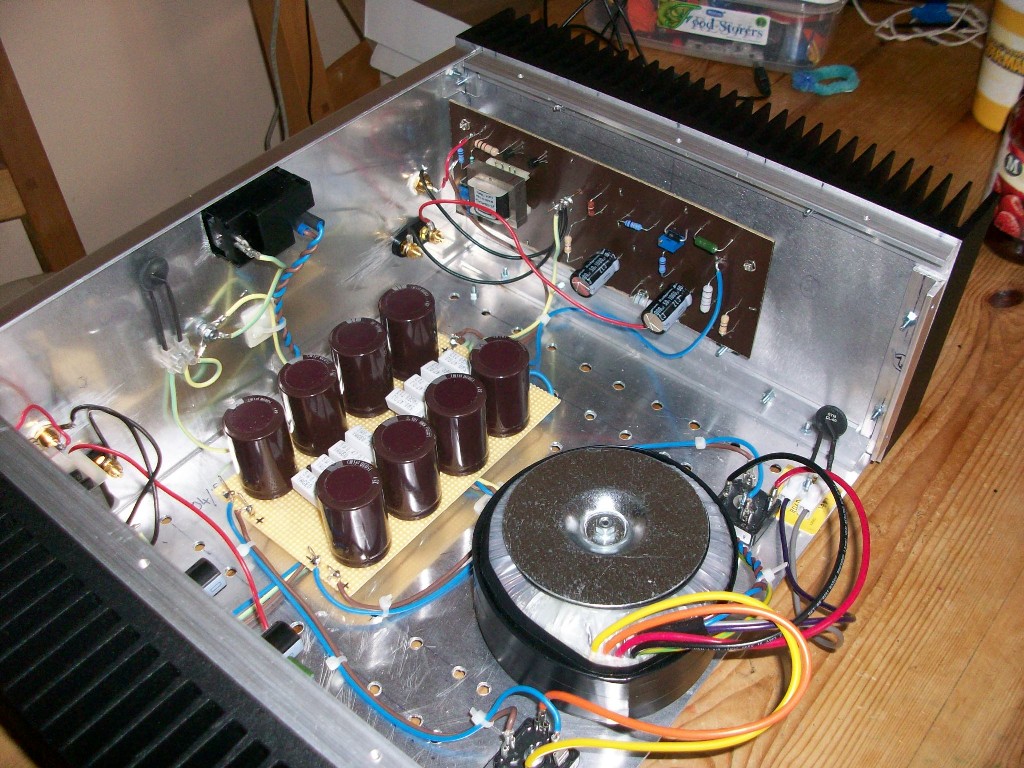

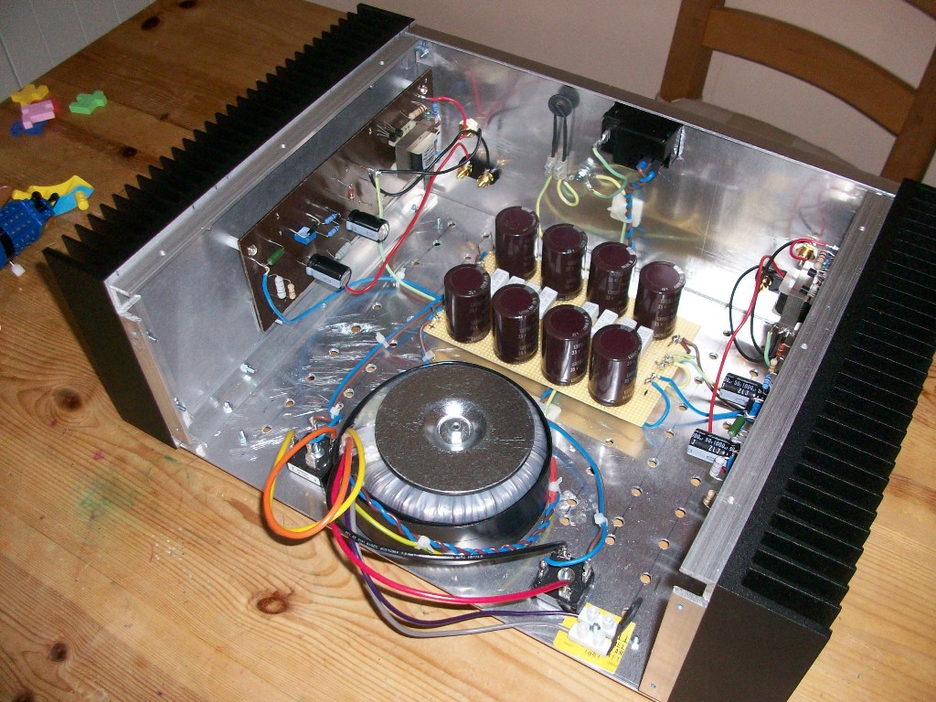

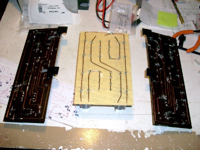

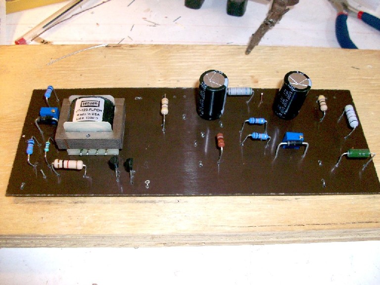

Would you mind posting big photos of your final assembly? It is always good to have another pair (or 2,3,4...) of eyes take a look 🙂

There are some pics I posted in post 296 which shows my build.If they are not big enough I can take some more and post later.
My amp uses a single supply with a 500VA toroid;standard block rectifiers feeding a CRC supply with Rifa 47;000uf R15 47;000uf.
Thanks for looking.

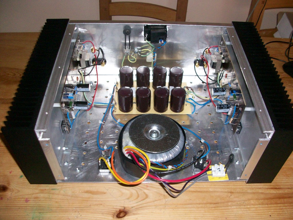

nearly there. I bought the semisouths for this in 2012 and the jensens off Buzz sometime in 2013 and then got side tracked.....finally put it together this week with irfp240s and the diyaudio circuit...casework is nearly finished so fingers crossed.....

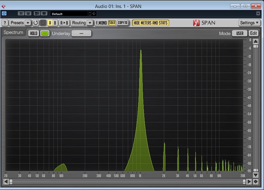

switched it on yesterday(left channel only) and default setting for pots was about 514mv across R2(1.09A) so left it to sit for a while. After 30 mins the idle point had moved to 570mv and the wall
monitor showed 72 watts draw for the amp....
today connected both channels and set bias at 700mv across R2, this quickly climbed to 740 and 730mv left and right. measured VGS
LHS : Q1 4.19v, Q2 4.29v
RHS : Q1 4.20v, Q2 4.19v
these were IRFP240s from the bit box so they didn't seem too mismatched at this stage.
after 6 hours LHS measured 721mv and RHS 709mv so it had settled a bit. Sinks were hottish and the wall monitor showed 173 watts consumed. I hooked up the THD measurement for completeness but havn't done the sums yet.
I felt confident enough to have a listen through my TQWP Fostex 206s and liked what I heard.
Onward.....
Onward.....
Ed
Vitalstates: What case and power supply did you use? One of the things this newbie has to figure out to build this .....

Hi Tom
heat sinks are from Conrad in Australia. Case is 1 piece of bent 2mm aluminium sheet with equal angle 15mmx3mm for jointing. I have 2mm sheet for the lid and 5mm sheet for the front. All up cost about £60. I used this method because I had sinks and bent sheet lying around for nearly 10 years after F2 and F4 builds. It may be possible to do it a bit cheaper, its certainly possible to do it more expensive.
edit: power supply is from Nelson's original circuit, same as I used for F4 some years back. Tx is an airlink 300va with all the shoelding added. Details on my website. I will post up the whole build detail on the web site in due course.
