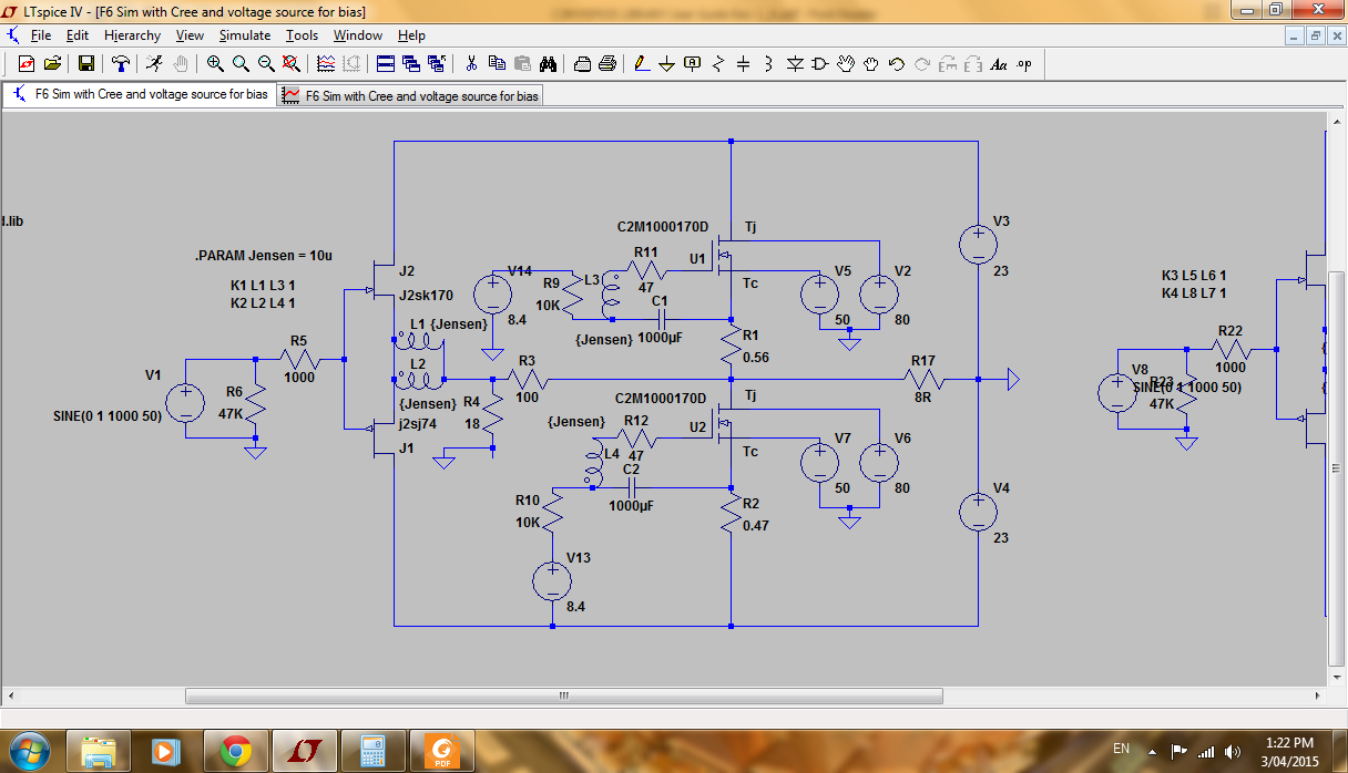

Just in the interest of trying something a bit different, any reason I can't sub a C2m1000170din for the IRF parts?. I've no particular reason to do so other than for fun and for experimentation. I see no reason why not, but I don't understand the reasoning behind the values for degeneration of the FET's and if that should be changed for the different parts.

in addition to the zen-masters comments ,
you'll also probably want to make sure you have enough voltage in the bias circuits to be able to supply about 7-8volts to the gates - see the datasheet curves - this looks like a purdy high threshold device. Maybe subbing 9 volt zeners for Z1 and 2 will do nicely.

Sim issues
Hey all, anyone a SPICE guru? I've simmed the F6 with the Cree part as well as the trusty IRF part's and I appear to be simming whatever the opposite of an amplifier is... Ie I've got less voltage swing at the terminals than went in!
If anyone has some input I'd appreciate it.

<edit> and I'm a donkey - the values I had for the inductance of the Jensen was way to low, and I've now solved that problem, although I've just thrown a number in as opposed to thrown the correct number in. Anyway, all good and back to work with the Sim!
Oddly enough, no. My thought was, adding that second device brings a lot of new options to the table, among them, some interesting feedback points. You also can switch the secondary windings and have non inverted phase. DF should do better as there is more feedback available, although not a ton. I would maybe even consider cascading the driver Jfet, just to improve conditions the transformer sees. Dunno. It's a thought that has been appearing from the shadows of my mind, on occasion. Not simple, but possibly interesting. Still my faves amp, and still like SS better🙂
