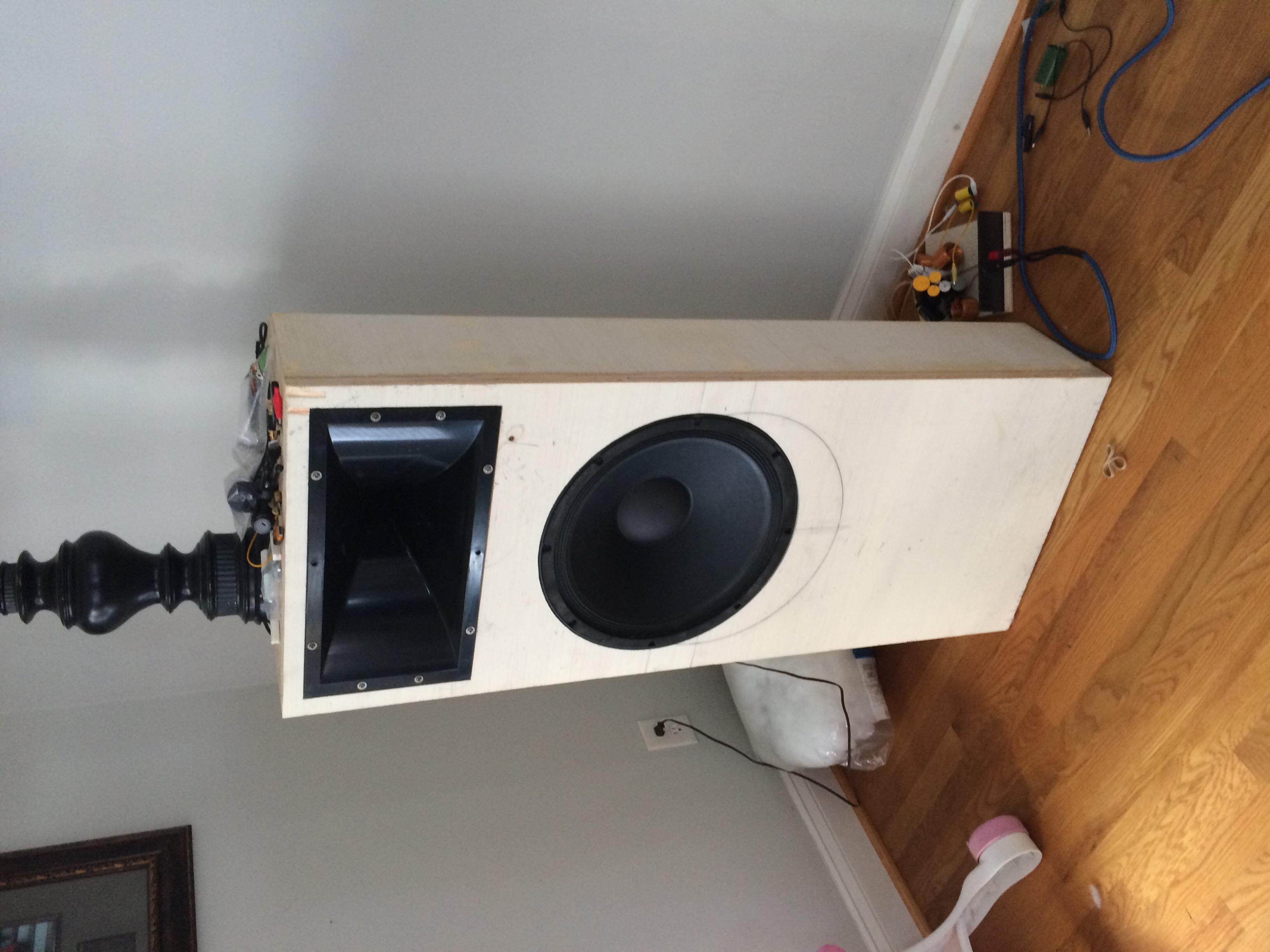

My speakes for reference

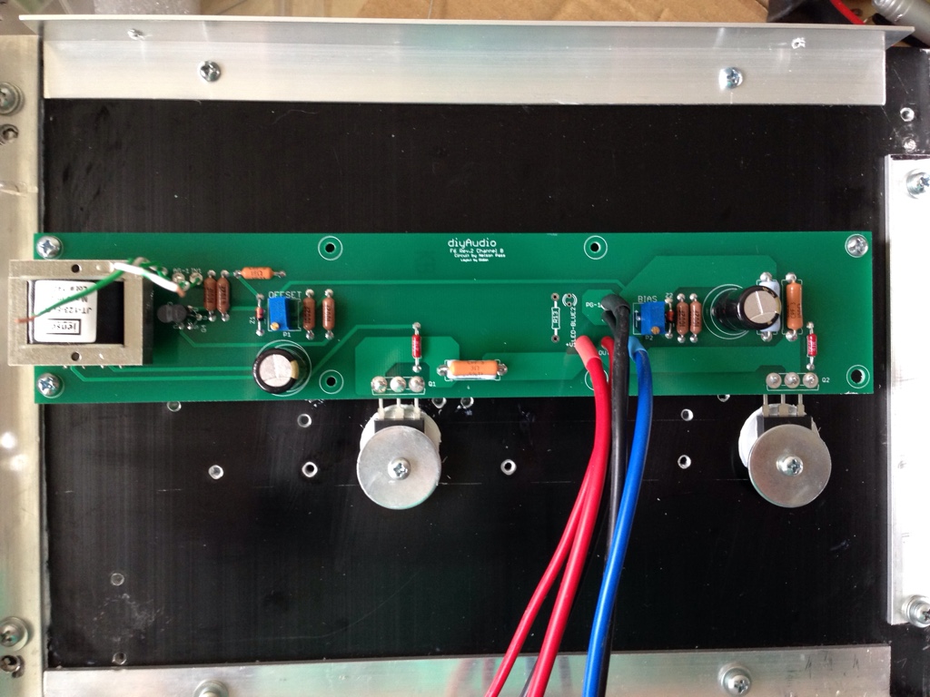

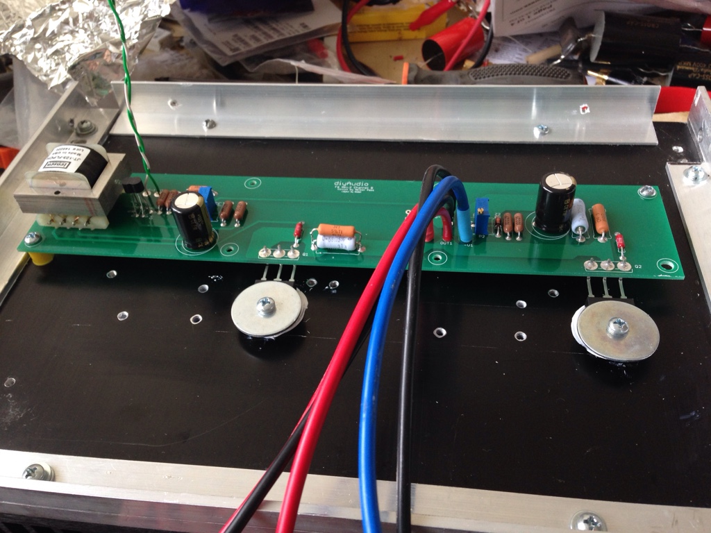

Did you scrape the paint off the chassis base for the chassis ground? It's near the purple wire and bridge?
