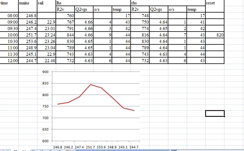

F6 update:
continuing my pursuit of fluctuating bias.
The original 240s have been replaced with a new set of matched 240s. The silpads have been replaced with mica and goop. I've attached the table of measurements with the new set up....a bit limited but I think it tells the story....Mighty ZM was on the money with his idea of mains fluctuations. I hadn't realised the huge changes that occur with my mains over short periods of time.
I've managed to get the 2 channels to track more or less together and set the offset to centre in the middle of my mains variance so it's down to listening now to see whether these variations really do affect the sound.
Any UK builders that have mains fluctuations like me might like to post their experiences.
