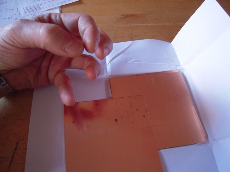

MU-metalfoil inside? ….is it a layer of copper and mu-metal? I have some mu-metal foil and copper tape on the way…...
answer to MEPER
Hello MEPER,
yes, I will make a case/box fitting on the EDCORs made of 1mm copper.
Inside I will use self-adhesive MU-foil.
The TEKO-cases I have bought do not fit. And they are steel with zink.
Greets
Dirk
Hello MEPER,
Greets
Dirk
I want to correct my impression of the M2x with the Norwood board. The drums and bass were exaggerated because I was developing a problem with my Whammy and a Lowther getting out of alignment. With Tea-Bag's help I got the PM6A back in alignment and removed the Whammy from my system.And with the Ultra Perm sheet suggest by Meper, I reduced the hum significantly by wrapping a piece of tape around the Edcor coils and mounted a cap on the entire Edcor. With the M2x on Hi and the F6 on Low, the sound is terrifically balance. Now I can try some of the other boards. Thanks all.
Do you have any pictures of your Edcor shielding for inspiration?
I second that request.
Please also include materials and their thickness.
