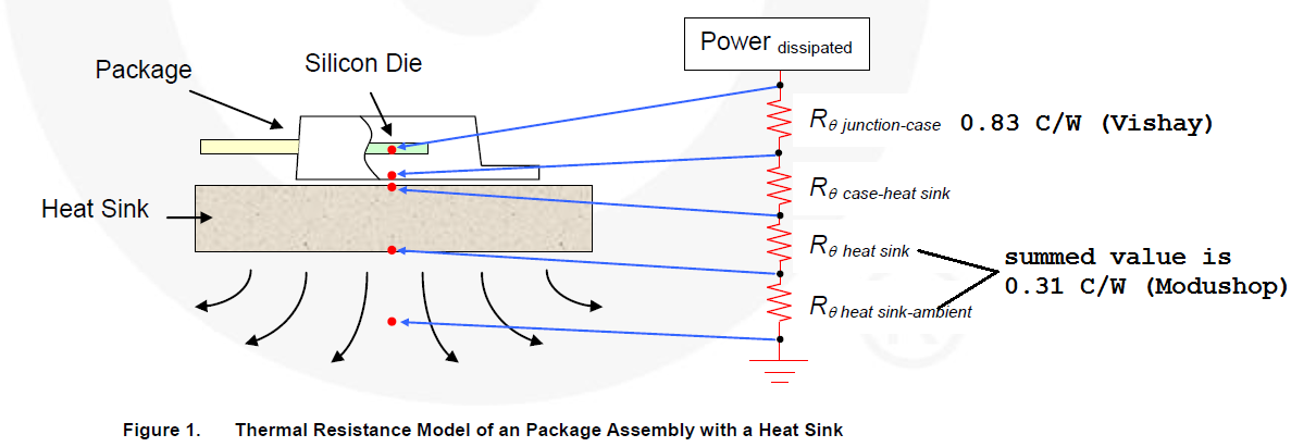

In the M2 amplifier, the complete thermal resistance from IRFP240 / IRFP9240 output transistor's junction to ambient, is
ThetaJA = 1.14 degC/Watt + XXX​
where XXX is the thermal resistance of the mounting pad in degC/Watt. See Figure 1 below.
Now all you have to do is plug in your own value of XXX for your own favorite unobtanium thermal mounting system that nobody sells, and compare the complete thermal resistance (1.14 + XXX) against the complete thermal resistance when using Keratherm (1.14 + Keratherm) from the diyAudio store.
