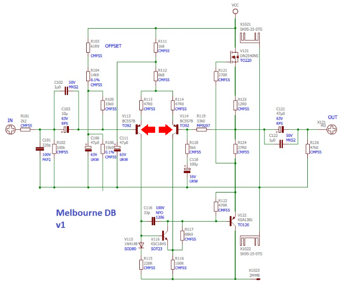

... Melbourne ... that comes from a single ended Class A front end ...
I think you need to adjust your marketing spiel. Your front end is a PNP differential amplifier, it's not single ended in the least. A single ended circuit is neither differential nor push-pull. Your front end does not meet the criteria.
However. Your second stage is indeed single ended Class A. Just like the second stage in every IC opamp including the uA741 from 1969. Just like the second stage in all of the beginner's power amps in Bob Cordell's book and Douglas Self's book and Ben Duncan's book and Randy Slone's book. (Before they begin to discuss push-pull second stages). But the second stage is not the front end and none of these amplifiers have a "single ended Class A front end".
_
Yes Mark, I know that the Long Neck Pair is not SE Class A , I mean the front end of M2X - since there are swappable “front ends”. But maybe you call them something else.
The front end of M2x is whatever input circuit is included on the daughterboard you bolt in. So if you bolt in an Austin daughterboard, for example, then your M2x has got a push-pull Class A diamond buffer front end. If you plug in a Norwood daughterboard then your M2x has got a differential-JFET front end. And if you plug in a Melbourne daughter board then your M2x has got a differential-bipolar front end.
The only way to make your M2x amplifier have a single ended Class A front end, is to un-bolt the Melbourne daughter card and replace it with a different card whose input stage is indeed single ended Class A. If you do this then, yes indeed, a non-Melbourne M2x does exist whose front end is single ended Class A. But it misleads the reader to mention single ended Class A when discussing Melbourne itself.
"There is also an incredible smoothness that comes from a single ended Class A front end" -- on another card not named Melbourne.

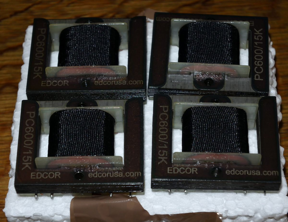

Clarifying question here before I click purchase: The edcore part in BOM for M2X shows PC600-15K. The edcore site shows both 600 ohm to 15k ohm (1:5) and 15k ohm to 600 ohm (5:1). I assume that because the BOM has the 600 first I want 600 ohm to 15k ohm (1:5). But we all know Mr. Assumption...
I think you had better read the
Official M2 schematic
thread here on diyAudio. It was started in 2015 by Nelson Pass, and to date it has accumulated more than 3170 posts. If there are pitfalls or difficulties or secret tricks to use when buying the Edcor transformer that Nelson Pass chose for the M2, that thread would be the first place, and the best place, to look.
Very closely study what went wrong when diyAudio member kbergsson tried to order Edcor transformers for shipment to Norway. Once you discover what he did wrong .... don't do that!
And continue with the remainder of anecdotes and tales of success / tales of woe, which fellow diyAudio members have posted. It would be a terrible shame to ignore their hard-won knowledge.
Hi Sesquipedalio, The edcor transformer you’ll need for each amp board is the PC Series Transformer, Impedance: 600 Ω to 15K Ω (1:5 ratio).

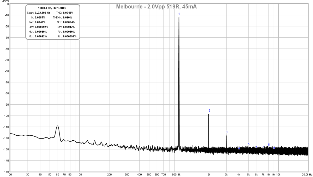

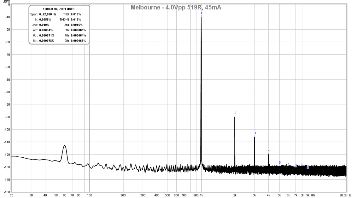

Some measurements of the Melbourne:
The Melbourne Class A Headphone Amp and Pre-amp
I was shocked how good it sounded driving my headphones. Both 250R and 50R - sounded clean and powerful. No audible hum. This is with +/15.5v rails provided by Mark Johnson design and Prasi layout BJT cap Mx and linear 15v trafo.
2Vpp into 240R load:
This was as close as I could get to providing a 600ohm load to emulate the Edcor (519R). 2Vpp into 519R:
4Vpp into 519R:
I think this is a very nice harmonic distortion profile and should be a good input stage for the M2X.
