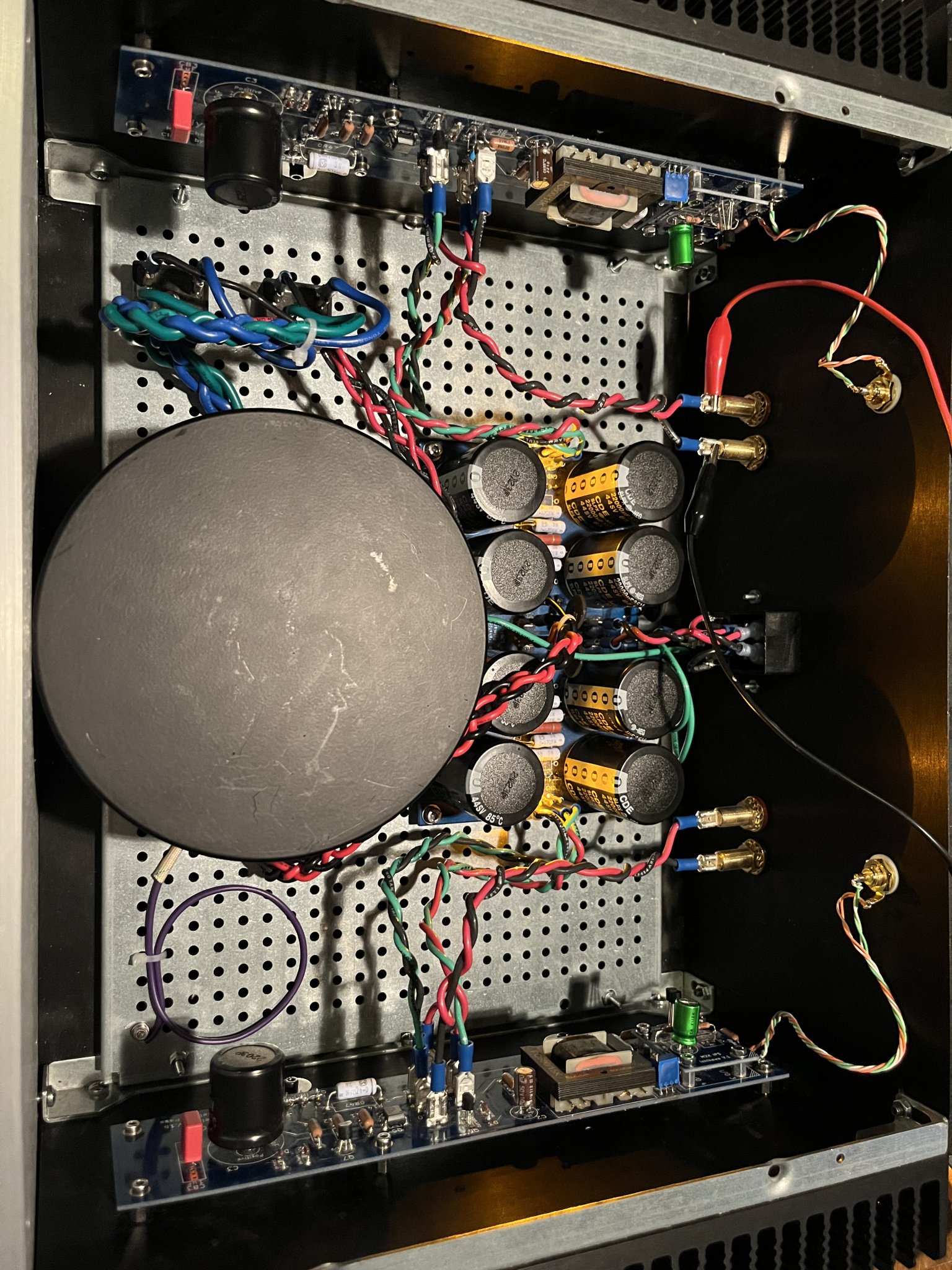

For 5 days my M2X sounded amazing. Checked the offset repeatedly, after long periods of time ( in its final home ), as is customary - and all was well. It was very stable. Then on the 5th day disaster struck and my transformer failed. One of the secondaries dropped, leaving the negative side of the power supply dead. +12Vdc presented at the outpus of both channels, across my speakers. This one definitely goes in the "bad luck" bucket, as I and many other have used many of these particular transformers for years without issue. This particular one sat on a shelf unused since June 2013, as I was going to build a second F4 but ended up going a different direction so didnt need it until now. Suffice it to say, a refund is not in the cards. A new one is already on the way.
Now I'm left to assessing what, other than a couple of my woofers ( mid and tweets seem fine ), was cooked in the process. Slightly concerned about the woofer coils, and perhaps other crossover parts. A little out of my wheelhouse in determing what 12Vdc could do to those.
Heatsinks were still warm when I discovered what had happened. They cooled as I was metering my way through the amp. So it was likely in that state for less than an hour. More likely < 30 minutes.
Im guessing the IRF240/9240s are toast, but not sure what else on the boads I should aim to replace while ordering up parts. On that note, I'm all out of IRF outputs. Going to use 240/9140s from the DIYA store to replenish as I assume the 9140 are an acceptable substitue.

Yes, one of the secondaries stopped conducting ( erratically ). On finding this I immediately disconnected everything, including the amp boards from the PS filter cap bank.
Starting at the PS cap bank, where the amp boards are were connected: it measured good on the positive side, 0 on the negative side ( both sides of the board )
I then disconnected the power supply cap board/bank ( whetever is best to call it ) from the rectifiers and measured AC in and DC out at the rectifier blocks.
One of the secondaries, and the block to which it was attached, measured fine: 20AC input, 26 DC output.
The other secondary/rectifier block: .250 AC volts, millivolts DC out.

I call it the filter board as the function is to smooth out (or filter) the output of the rectifiers.I then disconnected the power supply cap board/bank ( whetever is best to call it )
Yup, I'd try replacing the transformer, test the PSU with no signal boards. Then test one signal board at a time then both.

Since the AC goes into the PS board and then out to the transformer primaries, did you check the connections to be sure that the AC was getting to both transformer primaries? And then follow through to the transformer secondaries without the rectifiers connected. Might as well be as thorough as possible.

Yes, that was actually the last step before ordering another transformer. I checked all the terminations on the transformer itself, disconnected then reconnected the primaries to the board, then swapped where the primares were connected ( to try to rule out a fault in the board itself ). AC measurements at the secondaries ( without rectifiers attached ) between steps confirmed the same secondary stayed dead the whole time....damndest thing ever. Even more so since none of that had been touched since it was complete, 5 days prior, only having been opened to check offset ( maybe 5 times ).
It was just a bad transformer :|

That is really unfortunate and bad luck. Transformers are simple devices and to have one work for a while and then fail - a bad connection between the windings and leads? What are the resistances of the transformer primary and secondary windings?
Measuring across the primary leads, red to black, gives 1.6 ohms for both primaries.
My cheap auto-ranging multimeter was struggling to figure out the secondaries, measuring across blue to green. One side ranged 0 - 0.2 ohms, the other was all over the place.
