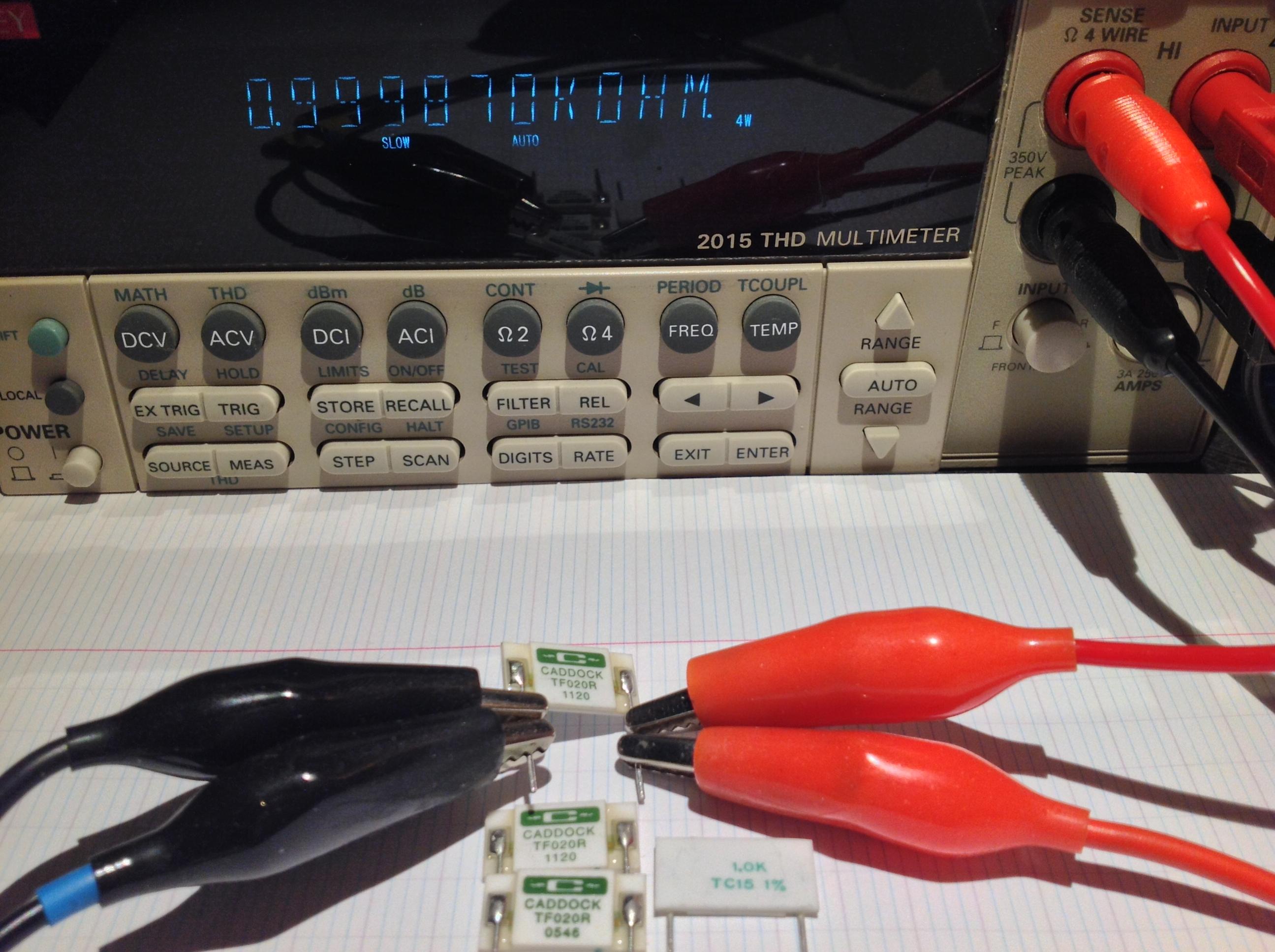

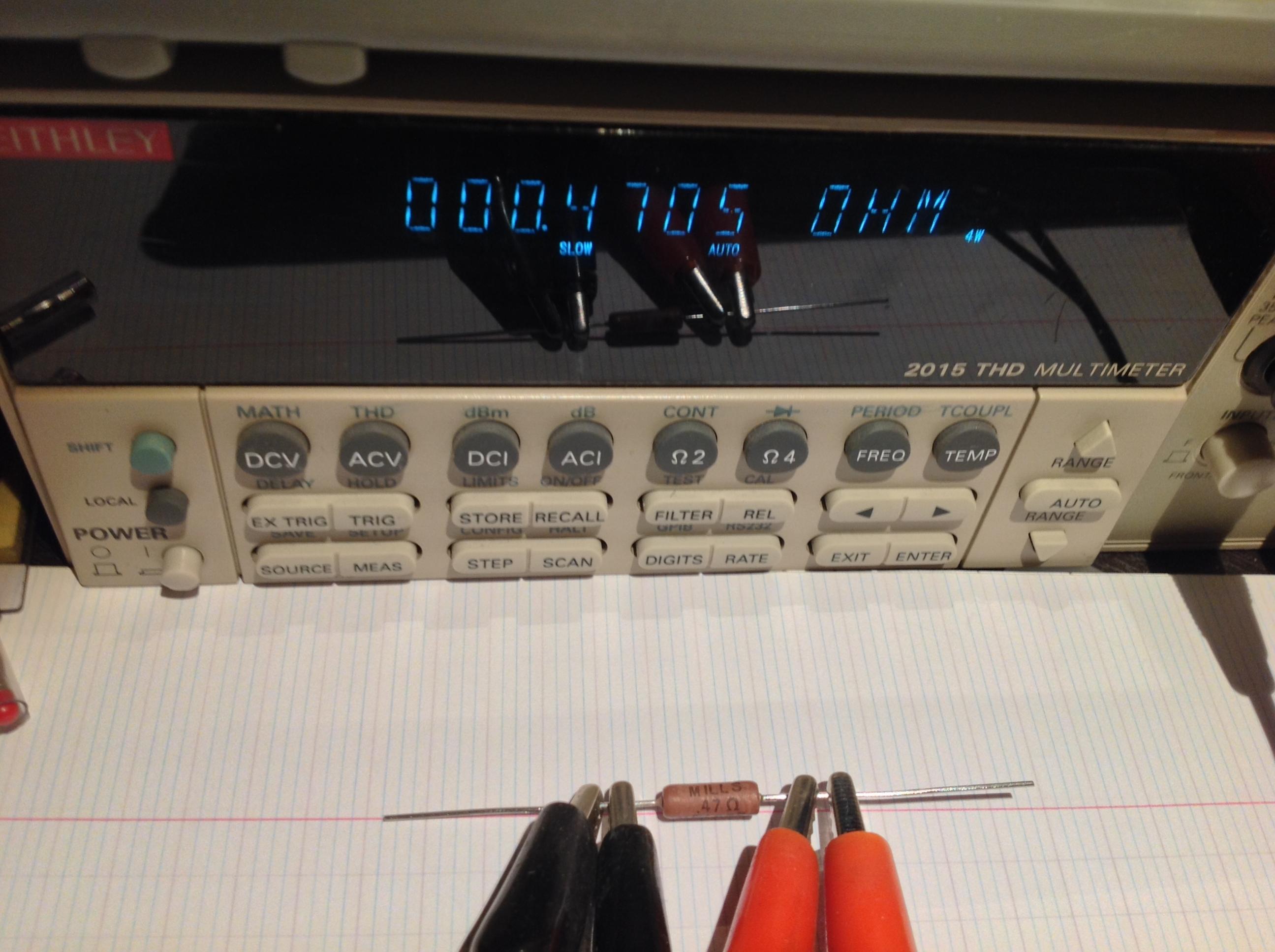

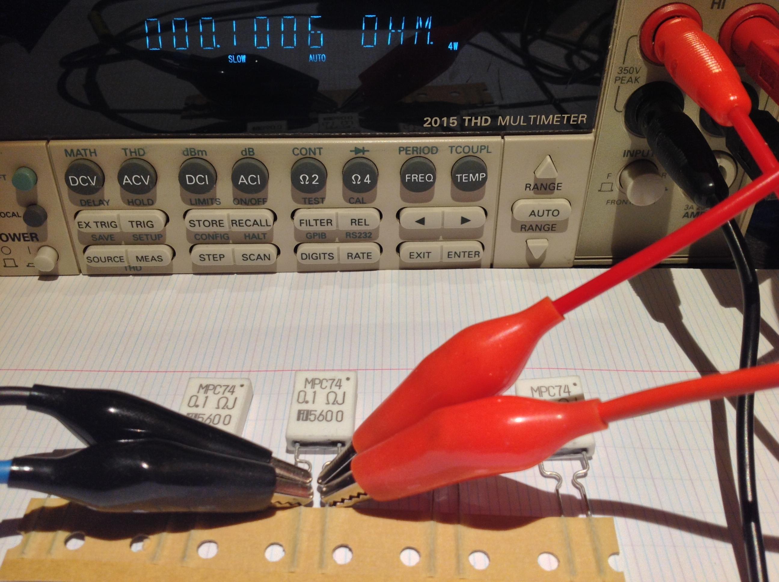

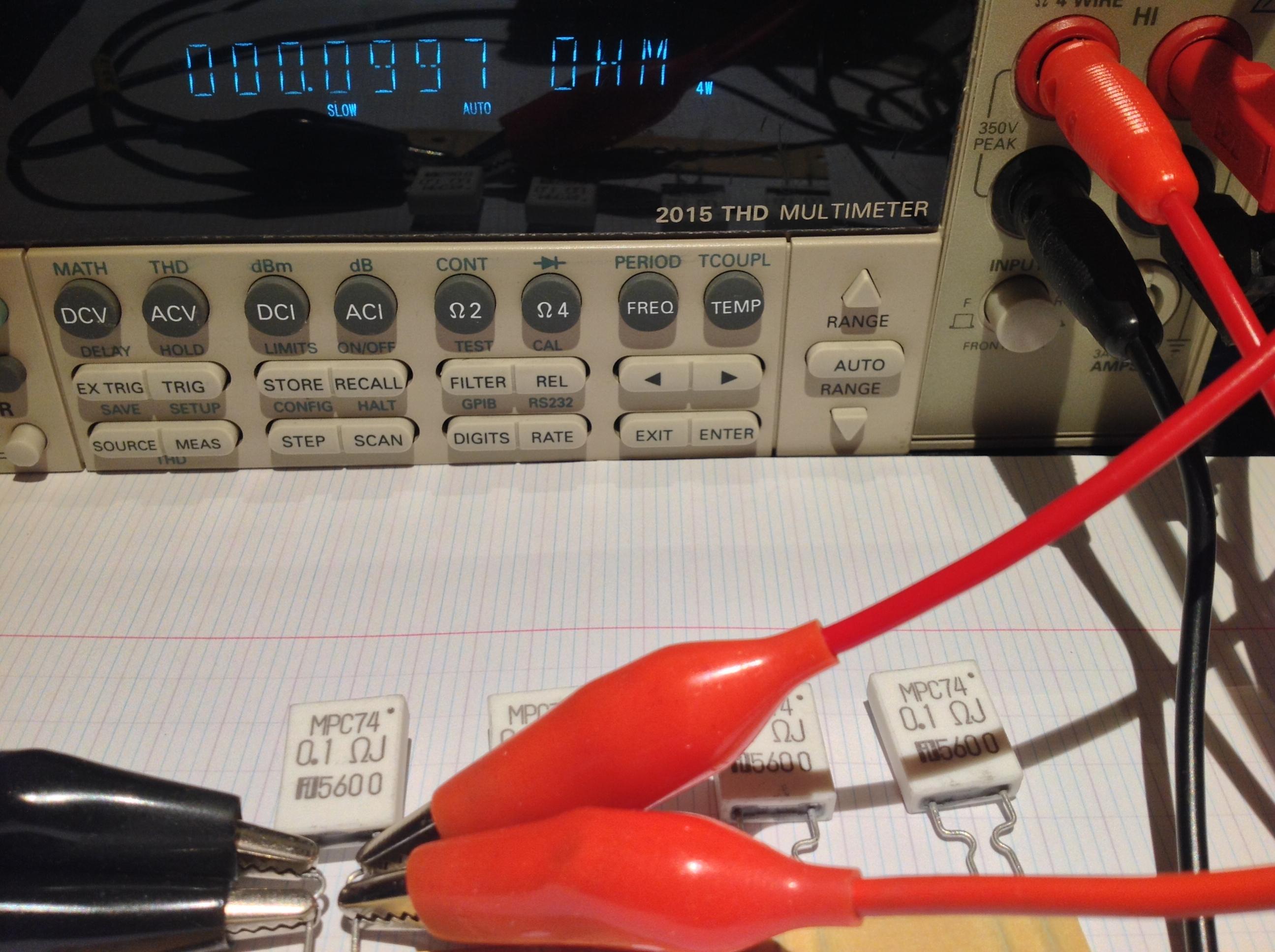

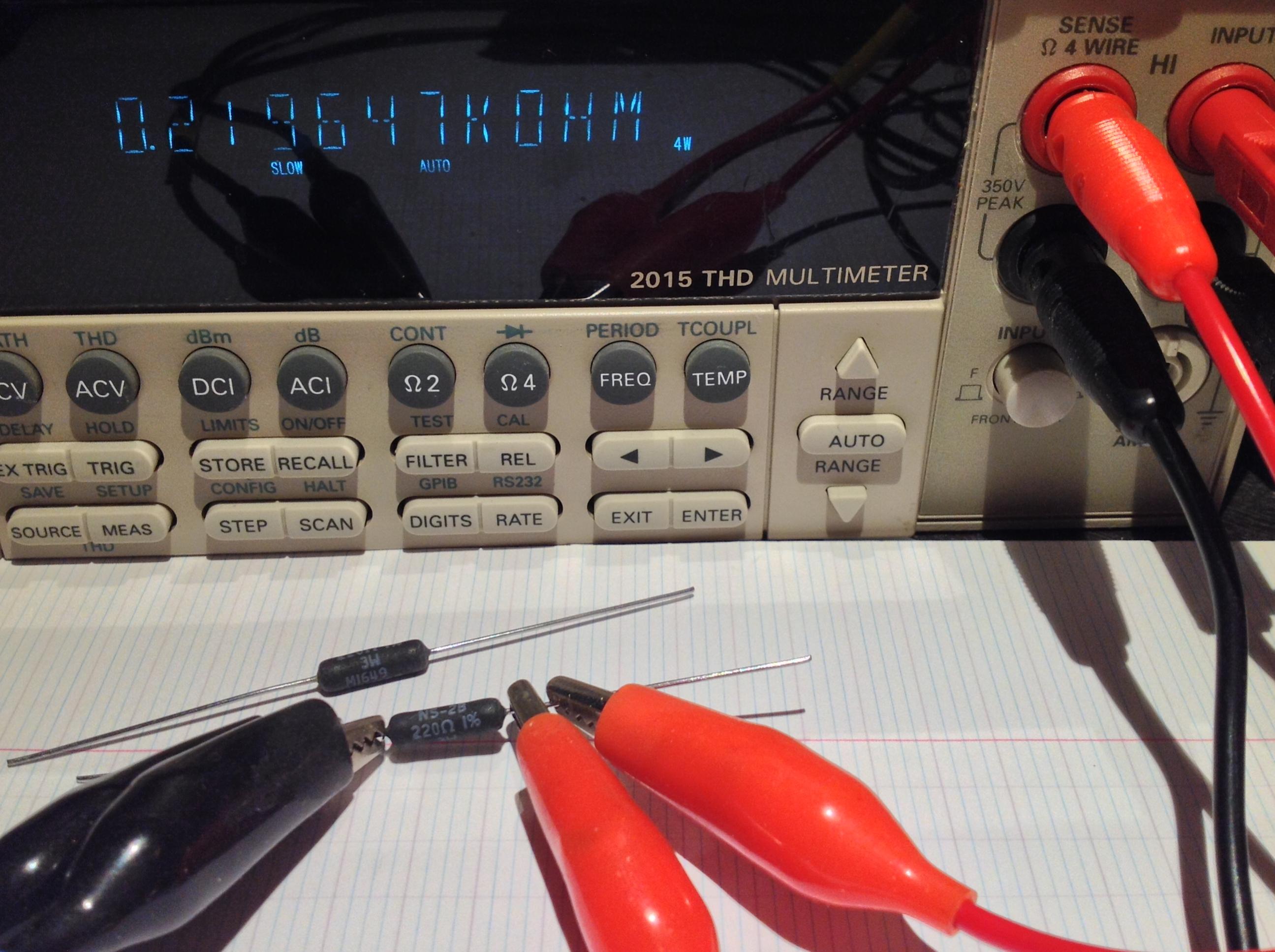

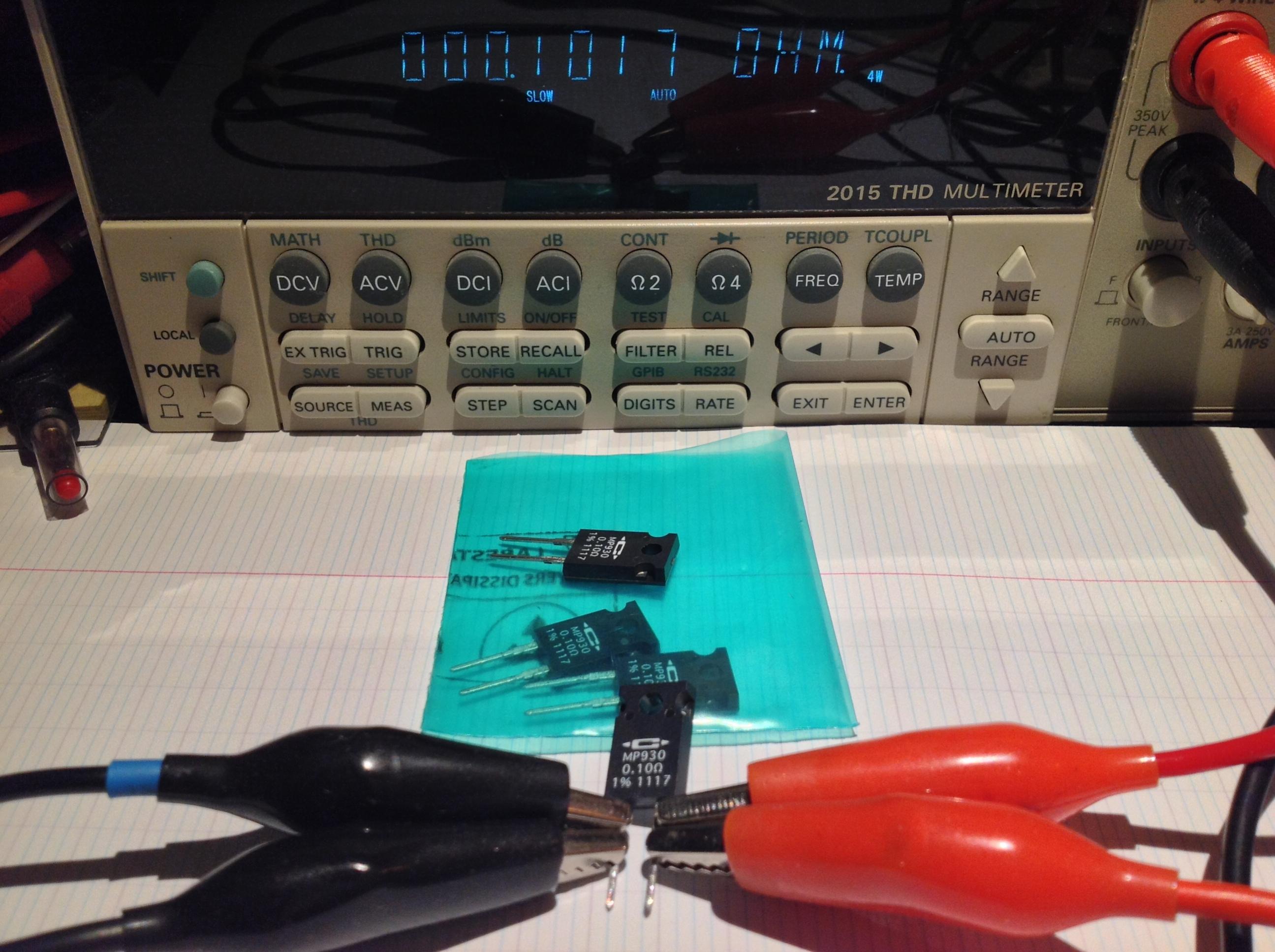

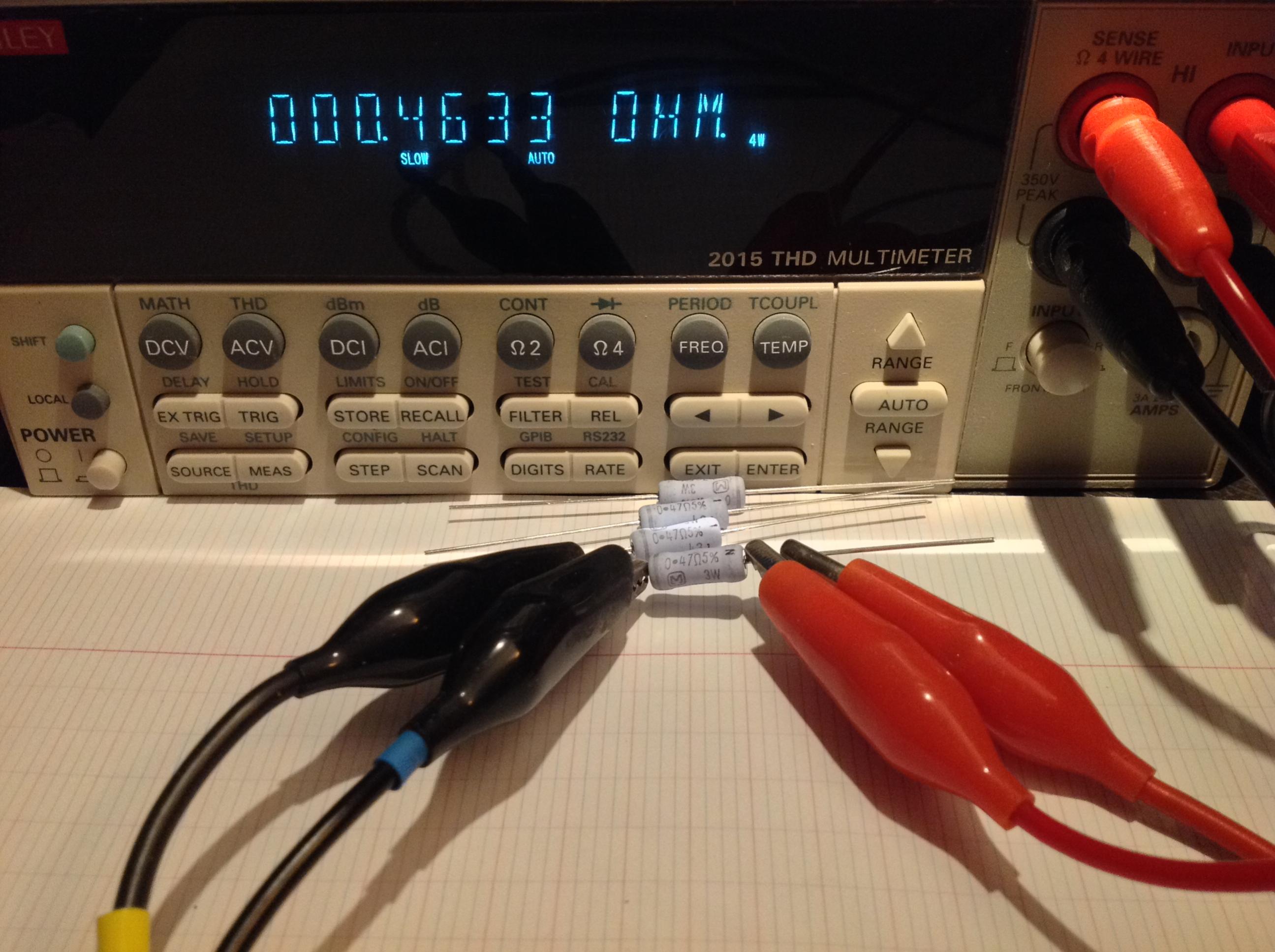

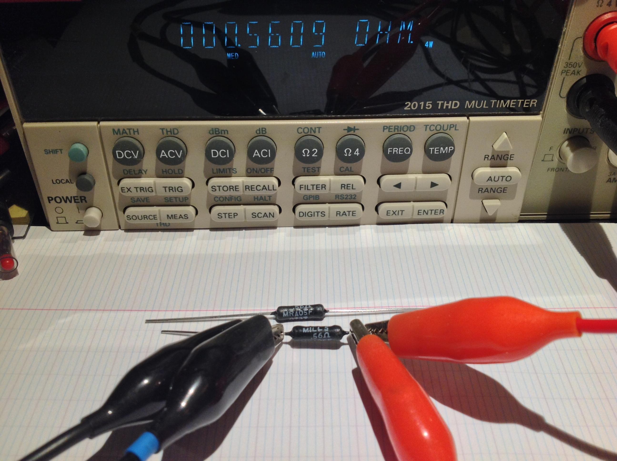

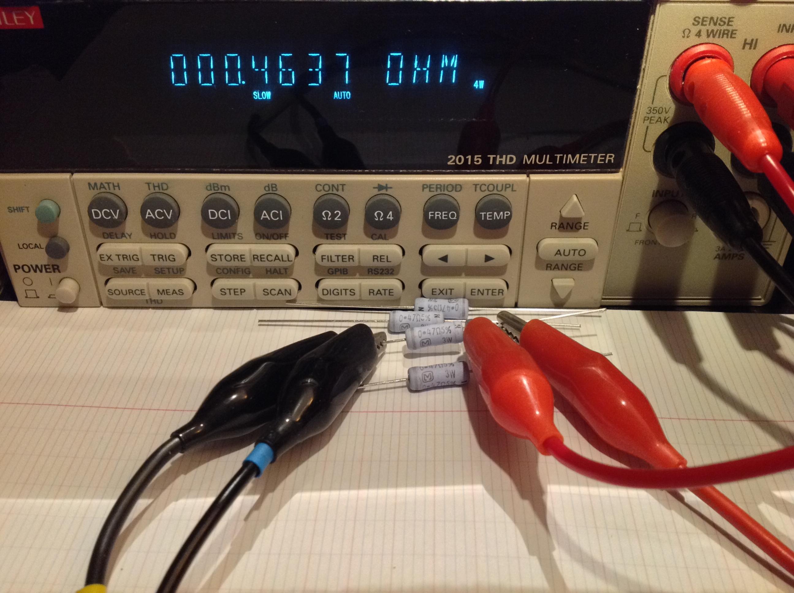

Yes NS serie Vishay 3 watt's is no inductive resistor version , leads are made with magnetic metal very good component anyways.
Vishay | Mills are the best Top Numero Uno audio resistor :
no inductive, no magnetic, can dissipate more heat 4 ~ 5 watt's at similar price :MRA-05R4700FE12 Vishay / Mills | Mouser Europe
Conrad get in stock Japan made Futaba MPC74 superb 0.47R source resistors cost less 1$
Metal film resistor 0.47 Ω Radial lead MPC74 5 W 5 % Fukushima Futaba MPC74 5W 0,47 Ohm 5% 1 pc(s) from Conrad Electronic UK
4 wires Kelvin test : Mills, Panasonic, MPC74, Caddock, Vishay NS-2B.
Conclusion yes Diyers match resistors is for perfectionist 🙂

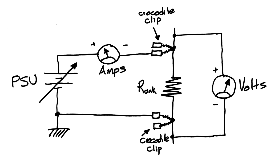

That is exactly what the 4-wire Kelvin measurement does. We have discussed it a few posts back, and that is what Soundhppy is demonstrating in the pictures.
If you have two DVMs you don't even need a constant current source. Just use one DVM as an ammeter and the other DVM as a voltmeter. Write down both the current and the voltage in your lab notebook and then use Ohm's Law to compute
Resistance = Voltage / Current
The requirements placed upon the DVMs are not severe. Ammeter will read something around 500mA depending on how you set your PSU. Voltmeter will read something around 200mV to 400mV. Well within the ranges of even the cheapest Banggood / AliExpress / eBay DVMs.
Be sure to connect the voltmeter OUTSIDE the high current path, as shown.

I'm note sure- can I use 15v PSU to measure 0.47R on this circuit?If you have two DVMs you don't even need a constant current source. Just use one DVM as an ammeter and the other DVM as a voltmeter. Write down both the current and the voltage in your lab notebook and then use Ohm's Law to compute
_
The schematic in post #533 attempts to communicate that the PSU needs to have variable output voltage. That is why there is a diagonal arrow through the Voltage Source symbol on the schematic: the arrow means "Variable Voltage Source". You'll probably set your PSU for something like 0.4 volts and then twiddle its output voltage knob up and down, until the ammeter reads something like 500mA.
It's a lab power supply with variable output voltage. Something like this product .
But I have to add: for people who have difficulty with Ohm's Law and/or difficulty predicting the appropriate currents and voltages when measuring an 0.47 ohm 3 watt resistor: it's probably better and safer if you read and follow the advice from member 6L6 in post #479.

Due to poor knowledge of English, I would rather make sure I understood correctly. Now I know that my fears about the level of current at this voltage were complimented
