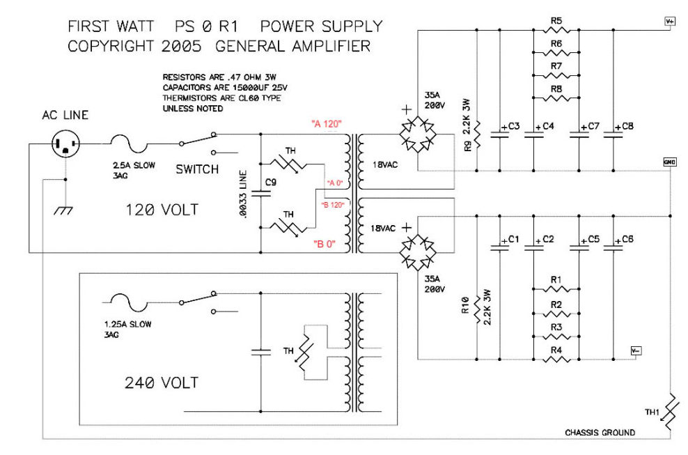

Here is Nelson Pass's schematic for the power supply he used in the original M2 amplifier sold by First Watt (link to sales page). It calls for a transformer with two 18VAC secondary windings.
Since the M2 amplifier uses Nelson's very clever 4N35 optoisolator circuit to achieve constant current Class-A bias, M2 will draw the same current whether you use a 2x17VAC transformer, or 2x18VAC transformer, or 2x22VAC transformer.
The supply current remains constant, but the supply voltage changes. So the power drawn from the AC mains, also changes. Since M2 is a Class-A design, more than 75% of the power drawn from the AC mains is dissipated as heat by the output transistors. That's why Class-A amplifiers have gigantic heatsinks!
So if you propose to replace Nelson Pass's 2x18VAC transformer by a 2x22VAC transformer (voltage higher by 23%), your amplifier will dissipate 23% more heat than Nelson Pass's original M2 amplifier. And you will need to increase the size of your heatsink by 23%.
It might be easier to buy a 2x18VAC transformer than to buy even bigger, even giganticer heatsinks.

Thanks Mark, the reason I asked for 2x22VAC transformer is that I have it as a spare from my VFET2 amp build. As you said the heat dissipation asks for a bigger heat sinks, I will drop that idea. Then I also have a spare 2x18VAC but with 7A current rating dual transformer which makes it to only 250VA compared to the recommended 300VA. Is this fine to go ahead and use for the time being and get a 300VA later on.

Be sure to use a different fuse in series with the AC mains, if you use a different transformer. For 250VA transformer, I suggest 1.0 amp slow-blow for 230VAC mains, 2.0 amp slow-blow for 115VAC mains.only 250VA compared to the recommended 300VA. Is this fine to go ahead and use for the time being and get a 300VA later on.

Any specific reason Mark to go with 1A fuse with 250VA and does this change if using a 300VA!
manniraj - The larger transformer might pull a bit more current at start-up, but it will be slowed down by the CL-60s, and if there's no great increase in capacitor size it won't make a marked difference.
That said, if you find the fuse is not holding, increase the fuse rating 0.5A at a time until you arrive at a value that survives power-up.
