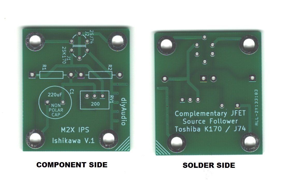

M2x buyers: PLEASE open your package promptly and verify that you received all twelve PCBs in good condition. Undo the rubber bands and look in between for a little lagniappe.
Whoops, I guess I am missing something? Looking at them I have the two main PCBs, 10 small mother boards, a pair of Toshiba K170/J74, a pair ofTucson, a pair of Norwood, a pair of N-Fet and emitter follower, a single Diamond dual follower (BJT), and a single Austin....guess I am missing 1 Austin board and one Diamond dual follower (BJT) ?
Wait a minute....I'm looking at two different sides, I think I have everything...closer look with old eyes, I have pairs of the following: Diamond dualfollower, Toshiba K170/J74, N-Fet follower, Norwood,and Tucson, so I guess I am good.
Russellc
Um, turn the boards over. Austin IS the Diamond dual follower. The Diamond dual follower IS Austin.Whoops, I guess I am missing something? Looking at them I have the two main PCBs, 10 small mother boards, a pair of Toshiba K170/J74, a pair ofTucson, a pair of Norwood, a pair of N-Fet and emitter follower, a single Diamond dual follower (BJT), and a single Austin....guess I am missing 1 Austin board and one Diamond dual follower (BJT) ?
Russellc
Ten is the correct number of daughter PCBs. 2xIshikawa , 2xAustin , 2xMtnView , 2xTucson , 2xNorwood.
I may have misunderstood, if you still think there's a problem please snap a photo?

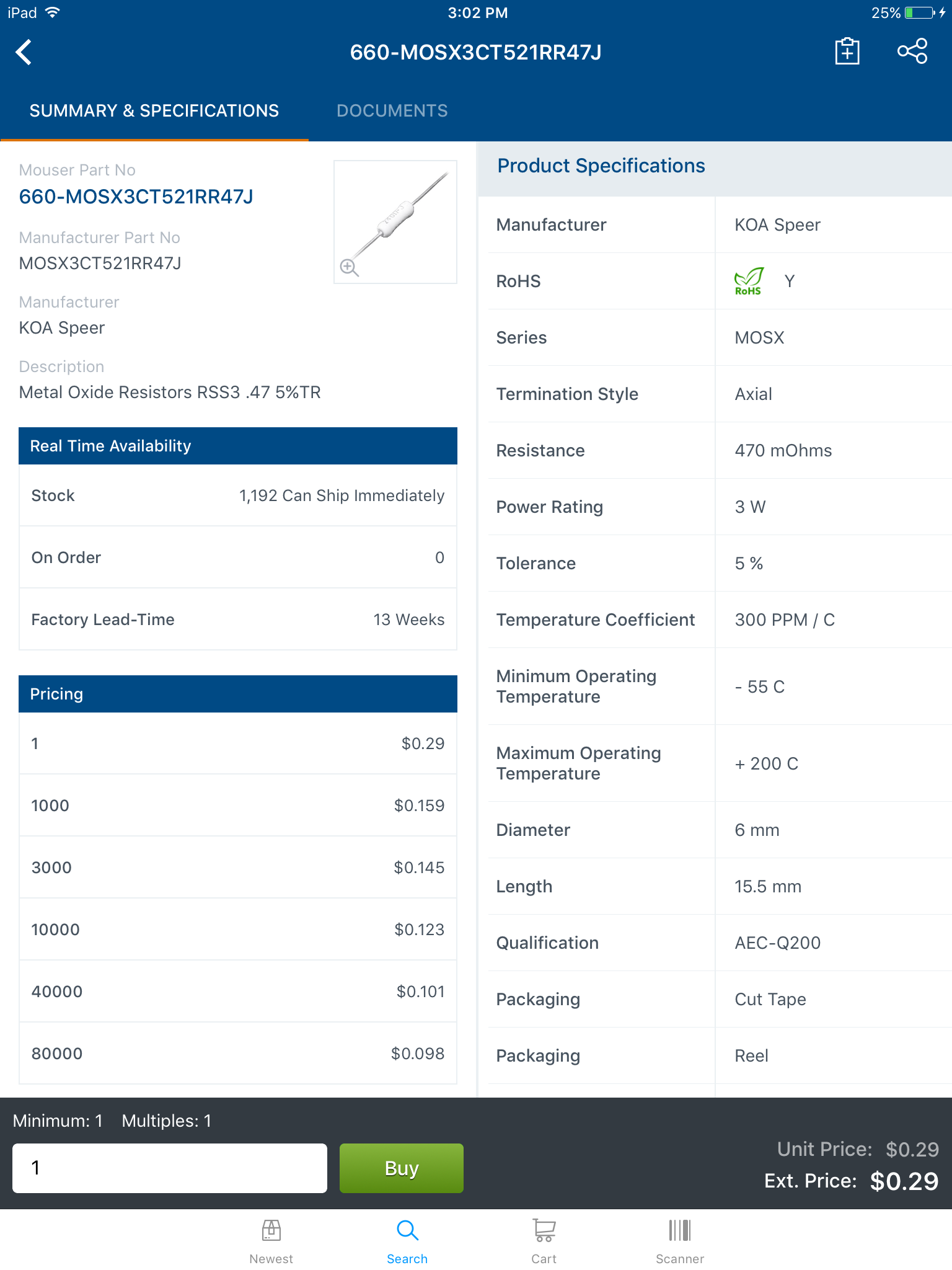

I'm putting together my parts list on Mouser and I've noticed possibly a typo on the BOM. R13 and R14 are listed as a value of 0R47, 0.47 ohms 3W and the part number given is 660-MOSX3CT631R4R7J. The mouser site shows this being a 4.7 ohm resistor. Just want to confirm which value it is, and if the schematic is correct.

Wow great catch! Indeed Nelson Pass's design does call for zero point four seven ohms as seen in post #1 of Nelson Pass's thread
Official M2 schematic
and indeed as shown on the M2x amp board V1b schematic. However the BOM is wrong as you point out! The correct part number at Mouser is
which I would be grateful if somebody double-checked that. I hope it is a 3 Watt, metal oxide resistor made by KOA Speer, resistance 0.47 ohms, size 6mm x 15.5mm. I will confer with 6L6 to see how we can update the BOM on the thread here.
As for parts substitutions (blades), feel free to make whatever changes you like. If it works, great. If it doesn't work, you can always go back and order the part# in the BOM.
Parts not in stock? Welcome to the reality of electronics. Now you get to learn how to use octopart.com. It's telling me that, today, DigiKey has 997 of those caps in stock, and Arrow has 994.

ERROR IN M2X MAIN AMPLIFIER BOM HAS BEEN CORRECTED
Thanks to JSA1971's eagle eyes, a mistake in the Bill Of Materials for the main amplifier board has been found and fixed. You really do want R13 = R14 = 0.47 ohms, just as Nelson Pass's schematic calls for. Just as the M2x schematic calls for. Just as column C and column D of the BOM call for.
Unfortunately, I transposed three keystrokes of the Mouser Part# in the BOM, which accidentally and incorrectly pulls up a 4.7 ohm resistor. That's wrong! Just now I've fixed the BOM and good old 6L6 has made a ninja edit to post#1 of this thread, installing the correct BOM and vanishing the old wrong one.
Please discard all copies of the main amplifier BOM that you may have in softcopy form / on your hard disk / in your cloud storage. Please grab the latest and greatest from post #1.
The side with lots and lots of geometric shapes in white ink ("silkscreen") is called the Component side.
The side without any white geometric shapes, is called the Solder side.
I recommend you turn all 10 daughtercards with the Solder side down and the Component side up. Now the names are visible and the descriptive slogans are invisible.

yep, all's good, Tucson, Norwood, Ishikawa, Austin, Mt view...
Nobody else has reported any issues with finding the city-name labels on the daughter cards; I am very glad it's not a widespread concern.

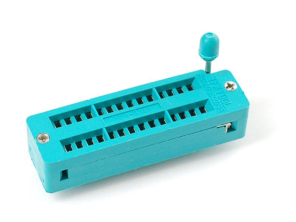

Hi what is the term used for/name of press fit connectors that can be mounted on pcb, for testing different component values?
