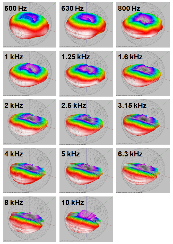

Here's a 3D polar of a smaller CBT prototype. Measured by Ron Sauro and NWAA Labs. More smoothing is used here though. The smaller CBT looses it's directivity earlier then the CBT36 or other larger CBTs.Looks very well behaved in every way. Very interesting that the response stays so flat over such a wide range of listening heights and distances.
David

Considering it's a polar response, it's measured at all heights/angles from what I understand.Ohmolt - thanks for the plot. Do we know at what height that was measured?

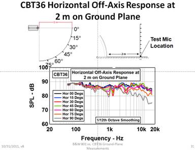

Regarding the horizontal measurement from the CBT36 vs B&W Matrix below, Don has also commented something that I think is well worth mentioning.
The slide shows responses measured with the test mic on the floor. The 90° curve rolls off above 5 kHz because of roughness of the concrete floor in our shop. Measured over a shiny tile floor it’s essentially flat!

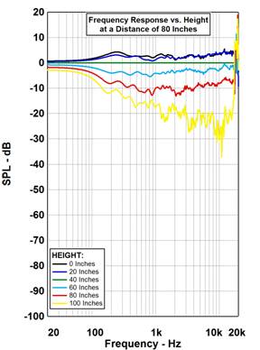

In lieu of these measurements, the attached CBT36 simulations show essentially the same thing but simulated at several distances from the base of the array at 0.5, 1, 2, 3, 10, and 250 m. The simulations of course do not include box diffraction effects. Note that the aspect ratio of all graphs is 25 dB/decade.
Here’s the graph at 2 m from the base of the array and 75° off-axis horizontal:
The red curve is at a height of 2 m which is 0.5 m above the top of the array (array is 1.5 m tall) and is fully 10 dB below the 1 m listening height level! All curves are normalized to the response at 1 m high (green response curve) at that specific angle. Note that the level increases towards the floor (black, blue curves) but dramatically decreases as you go up (blue, red, and yellow curves).

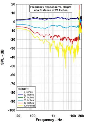

Here’s the corresponding 75° curves, but much closer to the array at 0.5 m. Note that the 1.5 m level at the top of the array (blue) is 6 - 7 dB below the level at the listening height of 1 m. At a point igher at 0.5 m above the top of the array (red), the level is down some 15 to 20 dB but still fairly flat!
So what’s the conclusion? Yes the CBT36 does illuminate the walls, but with essentially a spectrum that is quite flat and that decreases considerably with height at distances particularly close to the array.
