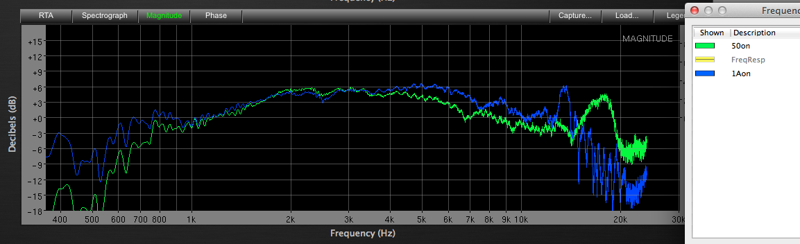

The DH1A has a HF peak around 13.5 kHz, 20 kHz is about 12 db down from the 10kHz response.Curious about the EV DH1 too and whether or not the 3" domes can get up there as well as 1.4 and 2" also curious about the horn adapters because I doubt the is anything the can get as low and as high efficiently as these Peaveys, they are remarkable after EQ. Did I mention serious SPL ? (which to me meand clarity) Count me in as a general fan of Electro Voice they always did everything right.
I EQ them (actually DH1AMT, which is the DH1 with the 1.4 to 2" snout adapter removed) flat from 800 to 16 kHz in my PA.
When using a crossover below around 1200 Hz, the effortless midrange of the 3" diaphragm more than makes up for it being a little rough above 13.5K, at least for me, but I can't hear above 16 K, so there is less than 1/3 octave of rough response anyway..
Using a driver like the DH1AMT makes building a Synergy quite easy, as it can cross directly to 8" (or even 10") speakers which can make it down to 60-100 Hz, where subs can take over.
The screen shot below is a BMS 4550 1" exit driver compared to the EVDH1A, both on the same horn.

So it actually sounds like they may be a better choice than the Faitals for studio use? I did read your extensive report amazing amount of real data! I was concerned that I could get up to 18k usable out of them but if I understand correctly this will not be an issue at these levels?

Pete,So it actually sounds like they may be a better choice than the Faitals for studio use? I did read your extensive report amazing amount of real data! I was concerned that I could get up to 18k usable out of them but if I understand correctly this will not be an issue at these levels?
I have not heard any Faital drivers yet, and don't know which you are considering, or what horn you are considering, so can't say whether the EVDH1A would be better or worse or sideways.
The EVDH1A /DH1AMT has usable response past 18 kHz, though with a 1.4" exit would probably require a diffraction horn to achieve 90 degree dispersion that high. 60 degrees would be no problem on a conical horn though.
You can listen to the recordings and decide for yourself if the HF sounds like the original. To me, it does, but as I mentioned, I can't hear above 16 kHz, so once equalized flat I couldn't tell the difference between a driver that only makes 16 kHz or one that goes to 30 kHz.
