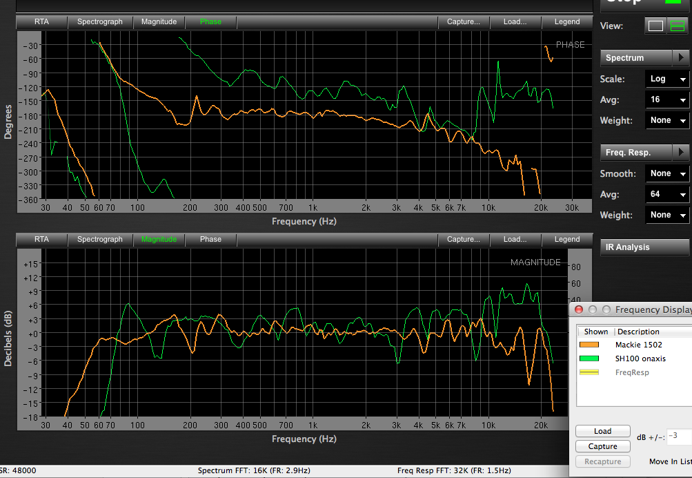

These are all very good questions. I asked them myself many years back. How will you go about getting the answers? Not around here since few here do much valid psychoacoustic studies. So unless you do them yourself, these questions will just have to go unanswered in your mind.
In my mind the answers are clear, but you've already rejected those.
1) Diffraction is bad in as much as it may be benign at low levels, but sounds worse at high levels. Having compared the same drivers equalized flat on conical and exponential horns with smooth throats compared to "pinched" diffraction throats, I have a strong preference for the former.1)To summarize I'm not sure diffraction is so bad, and I'm not sure harmonic distortion is all that inaudible, neither of which means that waveguide speakers are not great speakers.
2)I do not think the door should be closed on other horn speakers a possibly being superior when combined with DSP.
3)I'm betting on the point source thing being the most important issue based on what I'm seeing from my old Peavey horns behaving nicely 500 up with DSP the vultures circle but I know there gas been some clarity brought to others here in the middle of this small pile.
Distortion is bad if you desire playback to sound like the recording or live source. Odd order harmonic distortion is worse than even order.
Compression drivers have both, and both increase with throat SPL.
Larger diaphragm compression drivers with larger throats do not require as much throat SPL for a given SPL at the listener position.
2) Proper implementation of DSP can correct many problems, but can't correct poor horn designs.
3) A single point source is desirable to avoid vertical response changes from a seated to standing position.
A large center to center distance between the LF source and HF source as in your Peavey SP1 means you must be several meters away before you can have a smooth transition from standing to seated, at a distance of one meter or so, the vertical response is too ragged for mastering or critical listening unless your ears stay in the same vertical plane.
That said, at a few meters in the usual listening position the difference between a single point source and a closely spaced 15" and horn probably would not be a factor.
Having compared a DSL SH-100 (8" co-ax Synergy) to a Mackie HD1521 (two-way speaker with built in amps and DSP) found that with the SH-100 you could literally move your head around within a few inches of the horn in any direction and not hear tonal changes, while the HD1521 required a few meters for as much vertical movement to not be noticed.
However, within the HD1521 horizontal pattern as long as your ears were on axis between the horn and 15, polar control was excellent.
Now, sound and cost- at $1000 street price, the HD1521 is about 1/2 what you would pay for the SH-100 and an amp.
The SH-100 is not nearly as smooth, and does not go as low as the HD1521.
I have been told that the SH-50 is in a different class compared to the SH-100, it does measure smoother, and is about three times the cost.
It does get louder than the 125 dB the HD1521 can do in the real world, but more than 125 dB above 60 Hz is not generally needed in a home or control room environment.
That said, the $1000 HD1521 measures way smoother than the SH-50 and damn near anything I have ever seen, regardless of cost.
The HD1521 can be driven in to hard limit and still sounds good.
Why, with decent, but not exotic components can the HD1521 sound so good?
Because the DSP implementation stems from Dave Gunness.
Over his career at EV (he was responsible for the EV MT system design) and EAW, where he learned how to make some decent horn designs sound much better through "Gunness Focusing", patented acoustic correction DSP algorithms specific for the horns and transducers used.
EAW was bought by Loud, who are the owners of Mackie, Dave's secrets have trickled down, he has figured out how to correct most of horn and loudspeaker's "dirty little secrets".
Dave now runs Fulcrum acoustics.
After A/B/C tests with the HD1521, SH-100 and some of my designs, I realize that other than designing for specific niche applications, there is no reason for me to build speakers any more, I can't compete in terms of cost/performance.
That's my "dirty little secret".
P.S. The Smaart measurement of the HD1521 shows a ground bounce dip at 200 Hz, and the "High" control was turned up a few dB from the standard setting, which looks more like the spec sheet curve above 10 kHz.
There is no smoothing on either the SH-100 or HD1521, with smoothing the HD1521 looks like the spec sheet.
Art
