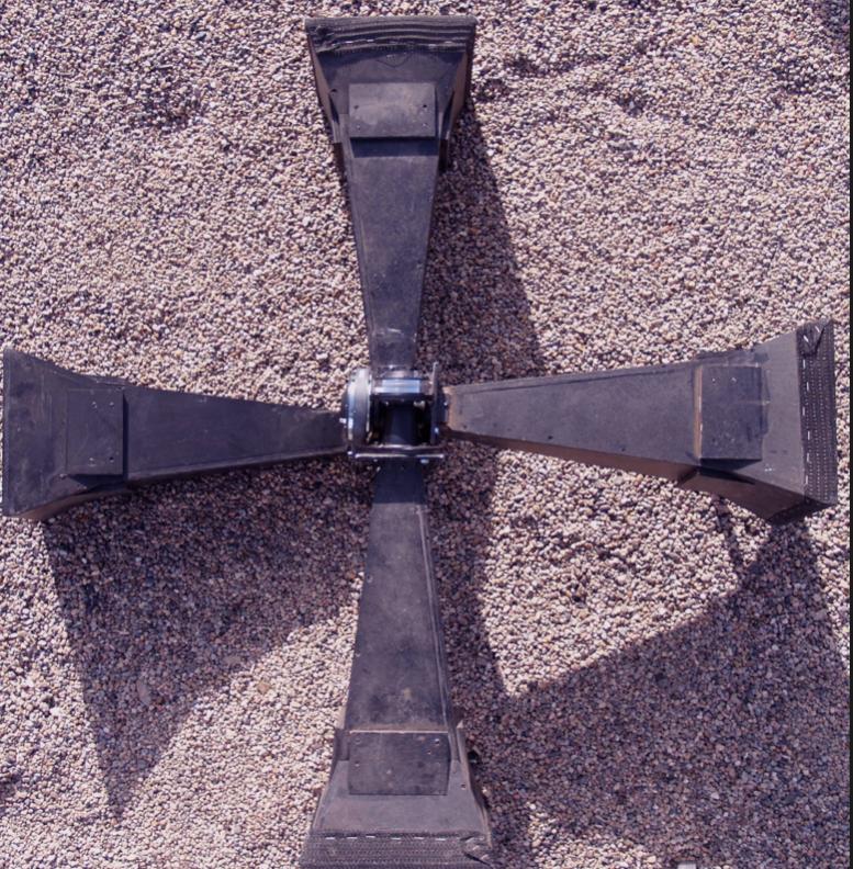

The Maltese horn (AKA "Welter's folly) was named because when the side walls of the horn are laid flat, they look like a Maltese cross, and it sounds cool, like the Maltese Falcon 😉.What's a "Maltese Horn"? And don't say "A horn made in Malta!"
Originally designed as a three way nested horn within a horn concept, the large outer bass horn was intractable.
Later, after discarding the 67" deep x 45" x 45" outer shell, the mid high portion was usable. Thousands of dollars of custom steel rigging frames were sold as scrap, bringing enough money to buy one pizza.

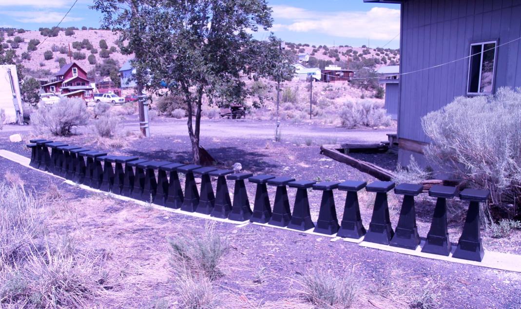

Some Maltese cabinets are still being used for PA work 21 years after being built, but most of the HF horns have become stools 🙄.
Some of the stools mouths have been shortened, did not realize there were plywood eating termites in Madrid, New Mexico...
