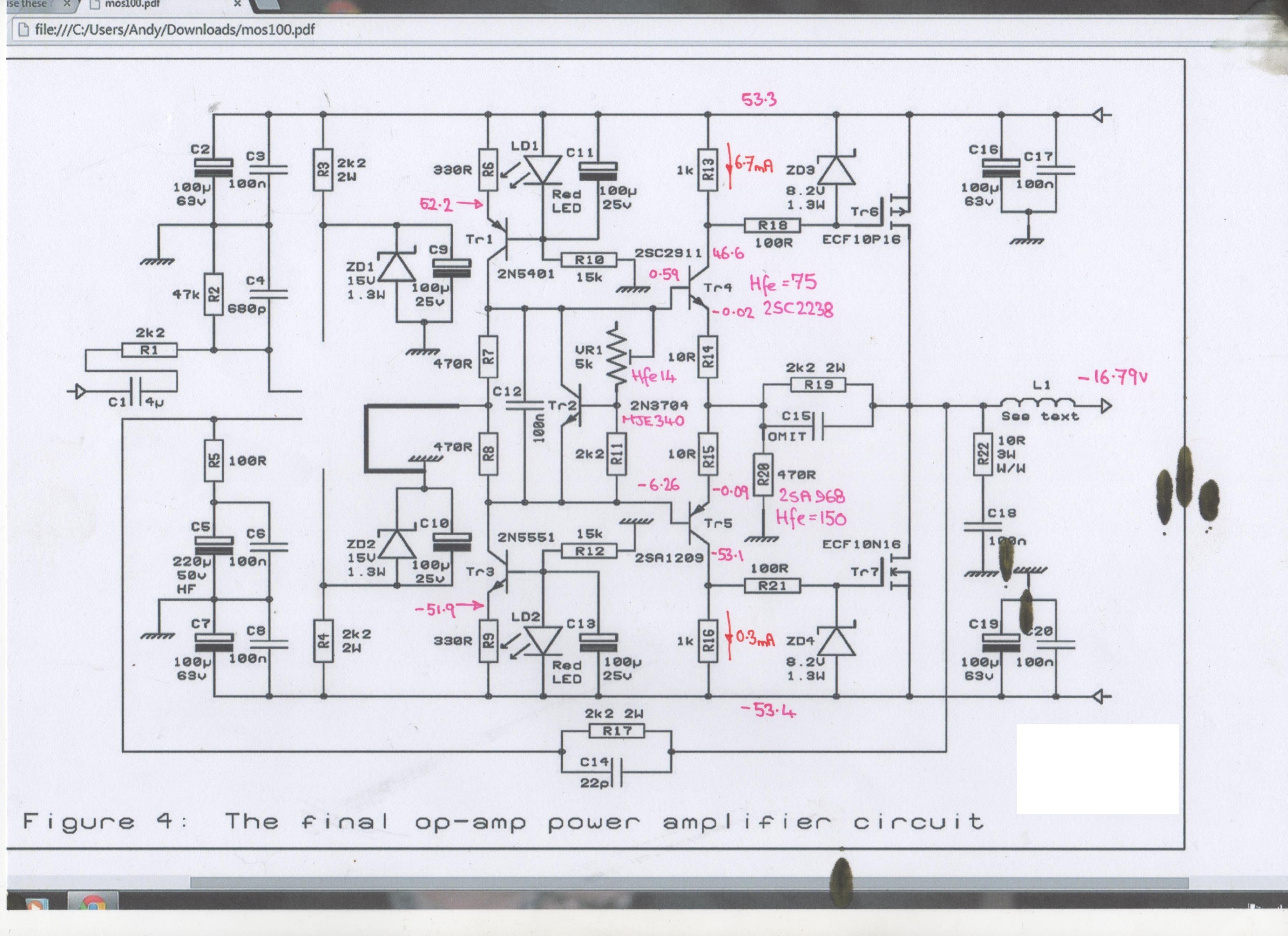

while you're in there measure the voltages at the base of tr1 (or across R10) and tr3 (or across R12) as well.
fwiw it were my amp i'd just snip the leads of TR4 and TR5 near the 90 degree bends i/o desoldering them off the pcb. Easy job to resolder them after. This also makes it easy to check that TR4,TR5 and TR2 are properly insulated from the heatsink. But your decision.

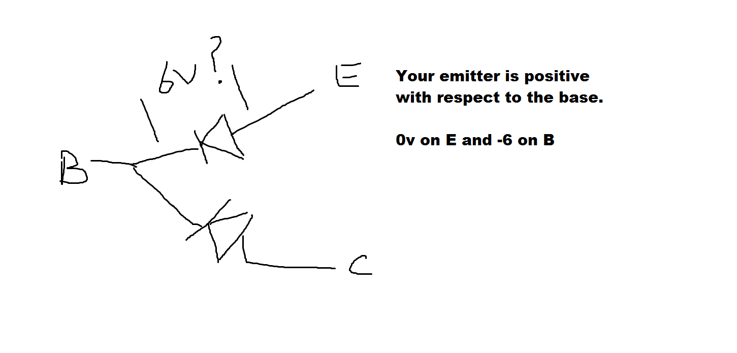

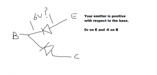

You can't have a 6 volt differential across a B-E junction (TR5) unless it is reverse biased. Your readings show its "not" (emitter positive with respect to base) which leaves the possibility that TR5 isn't a PNP, or that its faulty or fitted incorrectly.
No mystery 😀 There is a definite problem with TR5, be it incorrect polarity device, a faulty device or an incorrectly fitted device. Whether there are other problems remains to be seen.

Not possible 🙂
Its the same as saying "I have 6 volts across a forward biased silicon diode"... but it checks OK. There is one more possibility, but I would doubt this, and that is that the whole area around the transistor is oscillating at RF which would make all DC readings invalid. One quick check with a scope would prove/disprove that though... as would a well placed finger around that area.

are you sure they are installed the same way on both channels. Look at the middle transistor in each of these images carefully.

The MJE340 in the centre, TR2 is mounted upside down and has a fibre washer insulating the TR from the nut.

0.9 volts assuming its accurate is too high. Without being familiar with your meter I wouldn't like to say how that should be interpreted. The raw numbers say something is not right.
Work to what you can see is definitely wrong, which is the 6 volts we had above.

I've just done diode tests on both TR4 and TR5 and they both measure about 0.9V BE and BC.
Try measuring the voltage across the B-E junction of TR5 in the amplifier and confirm that the 0v and -6v results you obtained previously translate into a measure 6 volts across the junction.
I think one of my multimeter diode tests must be failing.
Just tested them again with a Fluke and all junctions are 0.6V.
