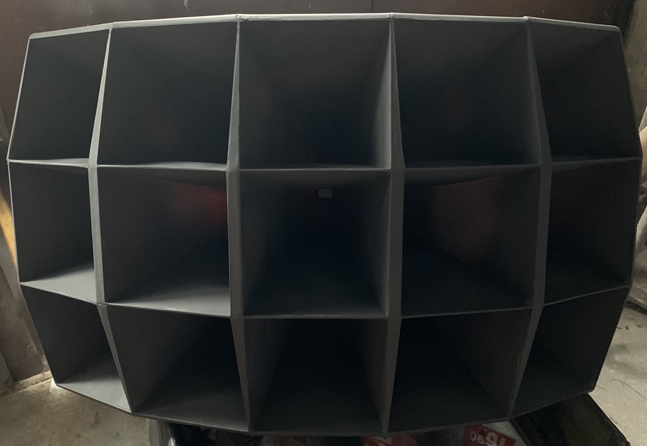

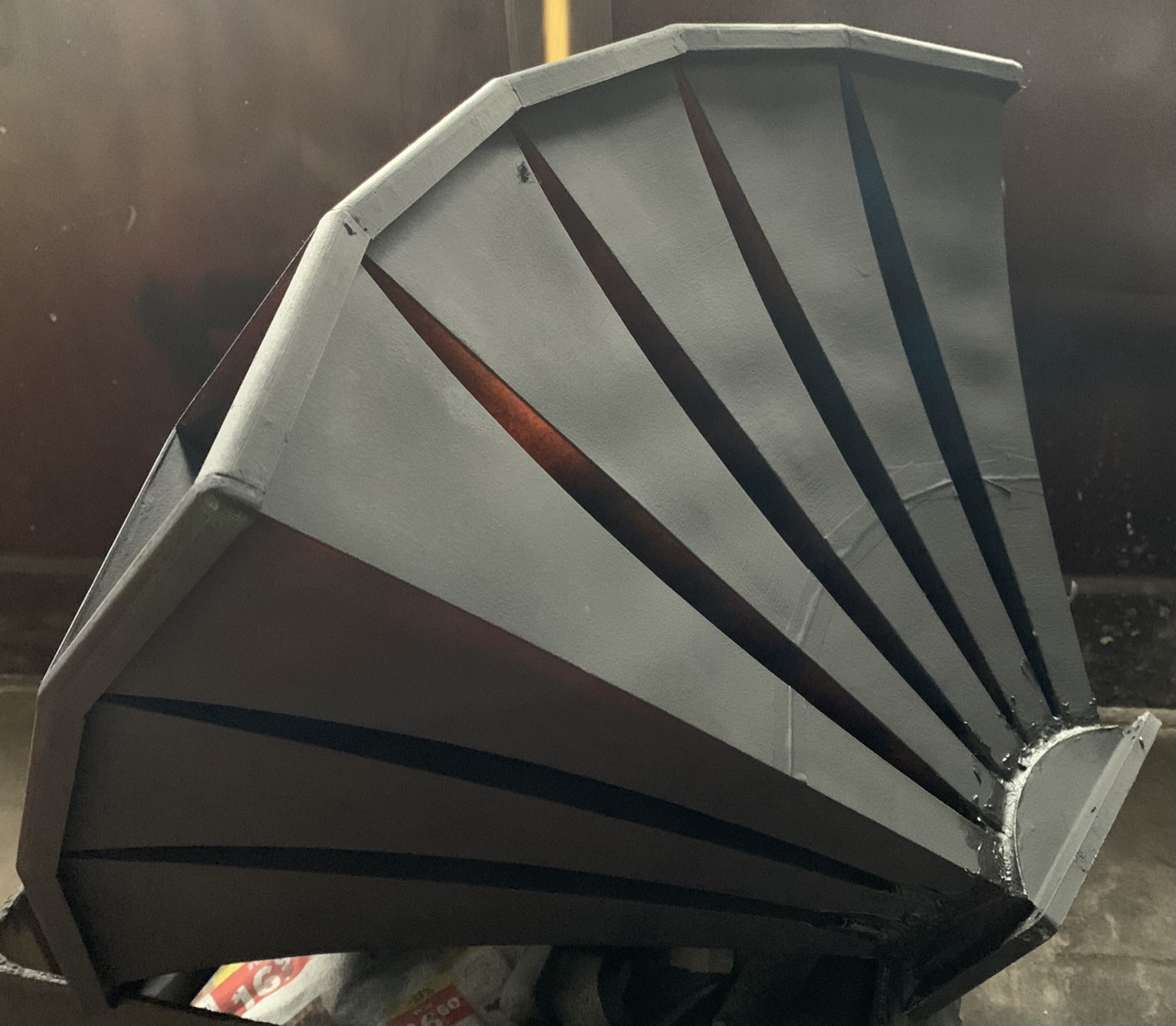

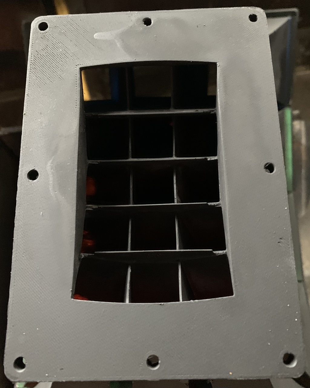

One thing I have learned during this project is that with a bit of patience and well set up printer, 3D printing is the way to go even for large things glued together from pieces. And sometimes the result is better than trying to print all in one piece. Including the throat adapter, my horn was made out of 65 pieces. If I was a bit more careful when glueing the parts together and if I sanded some parts before that, the result would be close to perfect. Today I sprayed the horn with some leftover black paint and found also an anti-gravel spray, so I used it. It creates a thick flexible layer with a texture. It is drying now but I hope it will strengthen and dampen the walls enough for testing. If yes, it could be applied before glueing the cells together.
It starts to look like the real thing🙂 I need one more can for spraying the inside of the cells better. The surfaces between the cells will need painting with a brush. Maybe it will not be damped enough, but it certainly feels more solid now.

I added a can of Body 930. It is beginning to get heavy. The tar based paint looks kind of cool and I think I will just apply it on the outside as well. It does not smell too bad after 5 hours and in the cellar room, which just next to the garage, it will not matter at all. When it is completely dry, I will mount the driver and try to measure if the damping is good enough or not. A second layer with "casting" into the thin mouth areas should be fine if the first layer is not. The cells are still a bit flexible, but definitely not ringing.
