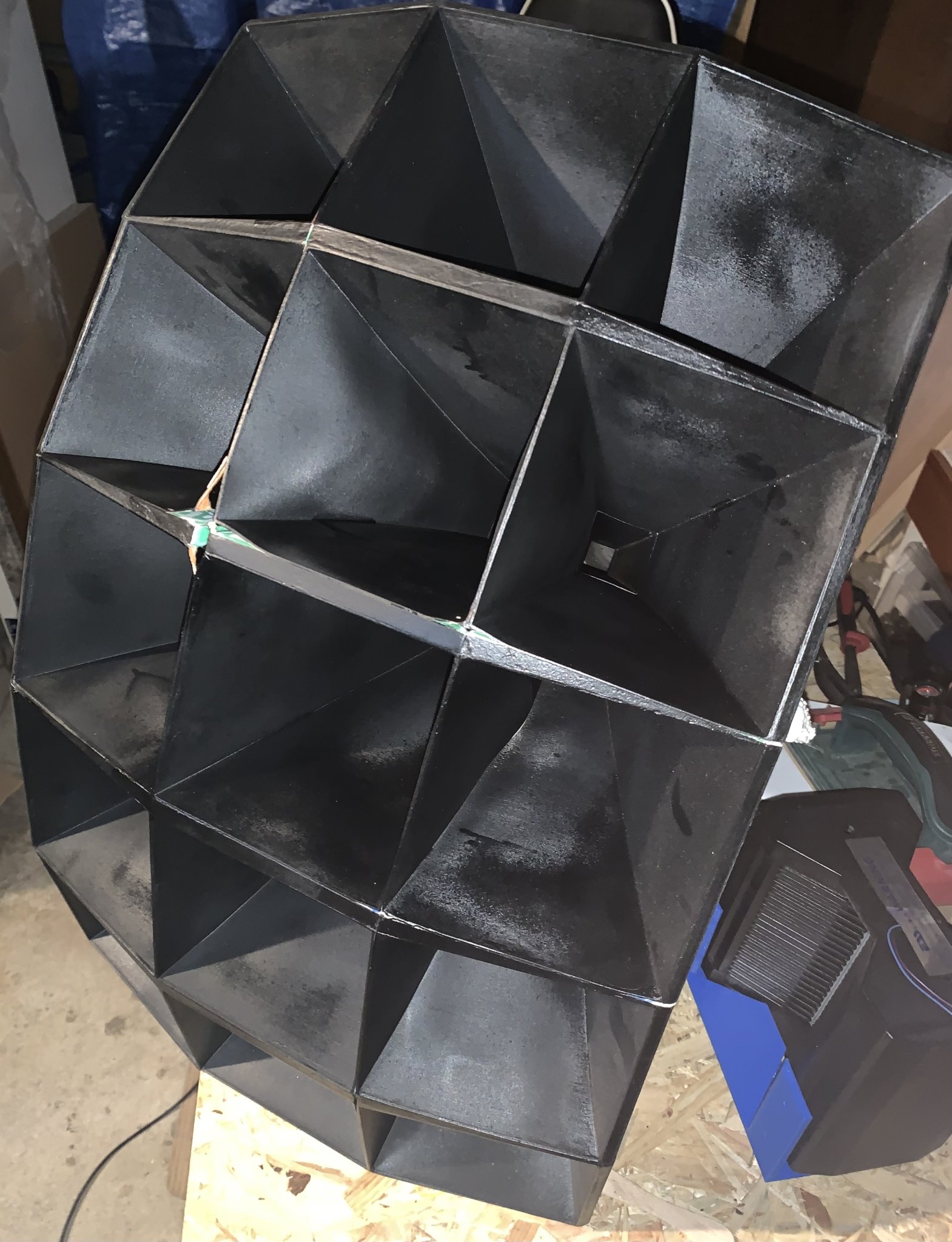

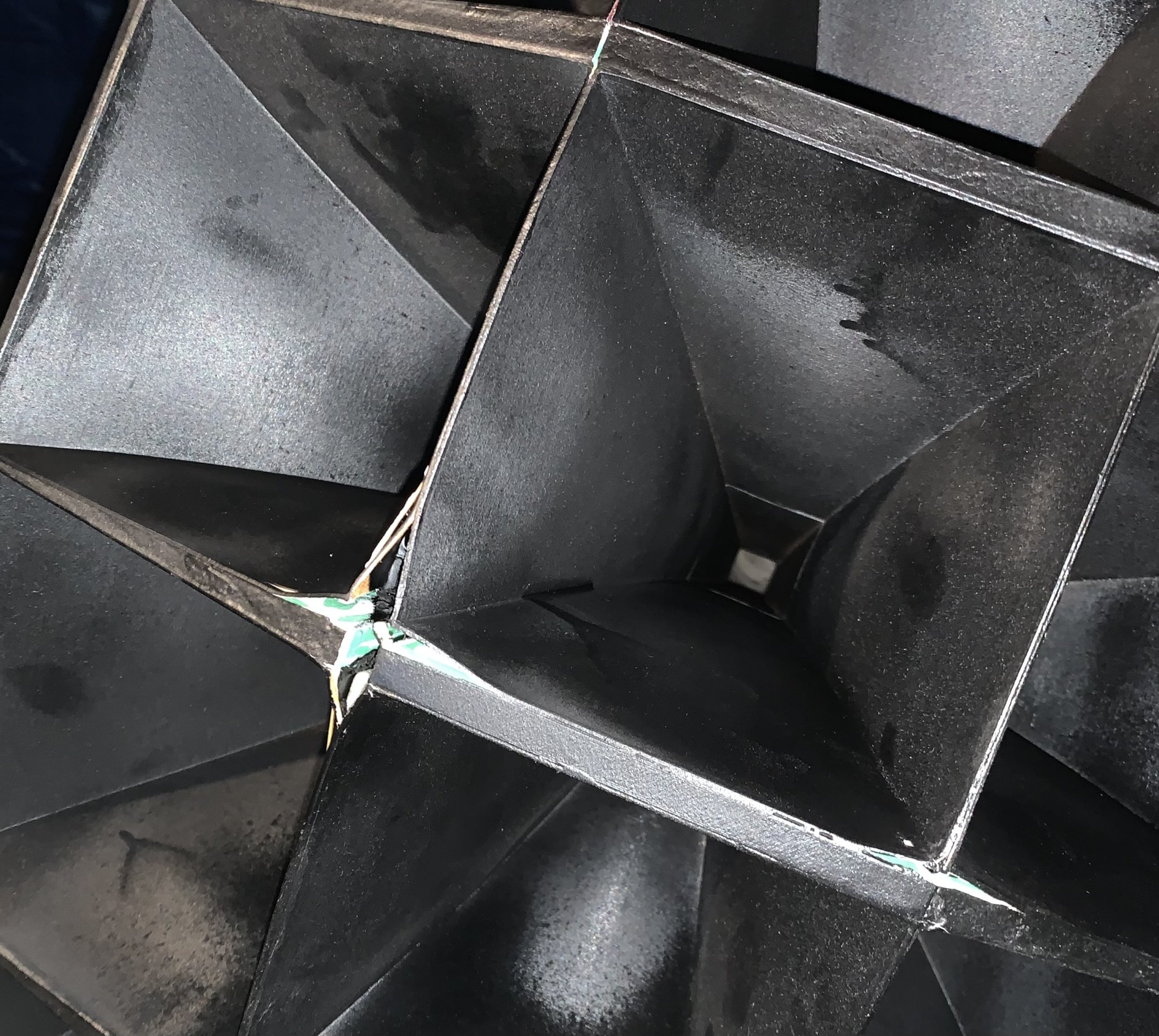

gac800, the spacers in the front are given by the construction - see the pictures in the begining of the thread. Typically, you glue 3 cells together on the edges. When you put two triplets together so that the corners on the edges touch, you get this shape of space in between. The front of the horn approximates a part of a spherical surface. If one had great 3D designing skills, the cells could be made in a way that they touch each other on the edges. I saw somewhere (maybe this thread) an article on how to make a 2x4 horn from tinned sheet metal - and the cell walls were made in a way that the mouths were trapezoidal and could be directly soldered together on both ends with no gaps. For the wooden construction (and my simple 3D printed version), bulding square cells is easier.
What about the spacing between the cells, it looks to be about an 1” in the middle row and then just tapered to a triangle on the top and bottom rows. Is there any specific math for this or is it just aesthetic?
I asked the same question, or a very similar at least, earlier in this thread. After having thought about it thoroughly, the reason became clear: You basically can glue together a almost infinite row of cells two dimensionally without getting gaps. But if you're going into the 3rd dimension, those rows get into contact just in the uppermost and lowermost corners, leaving space everywhere else.
Anyway, I don't have algorithms to compute the wedges either.
Best regards!

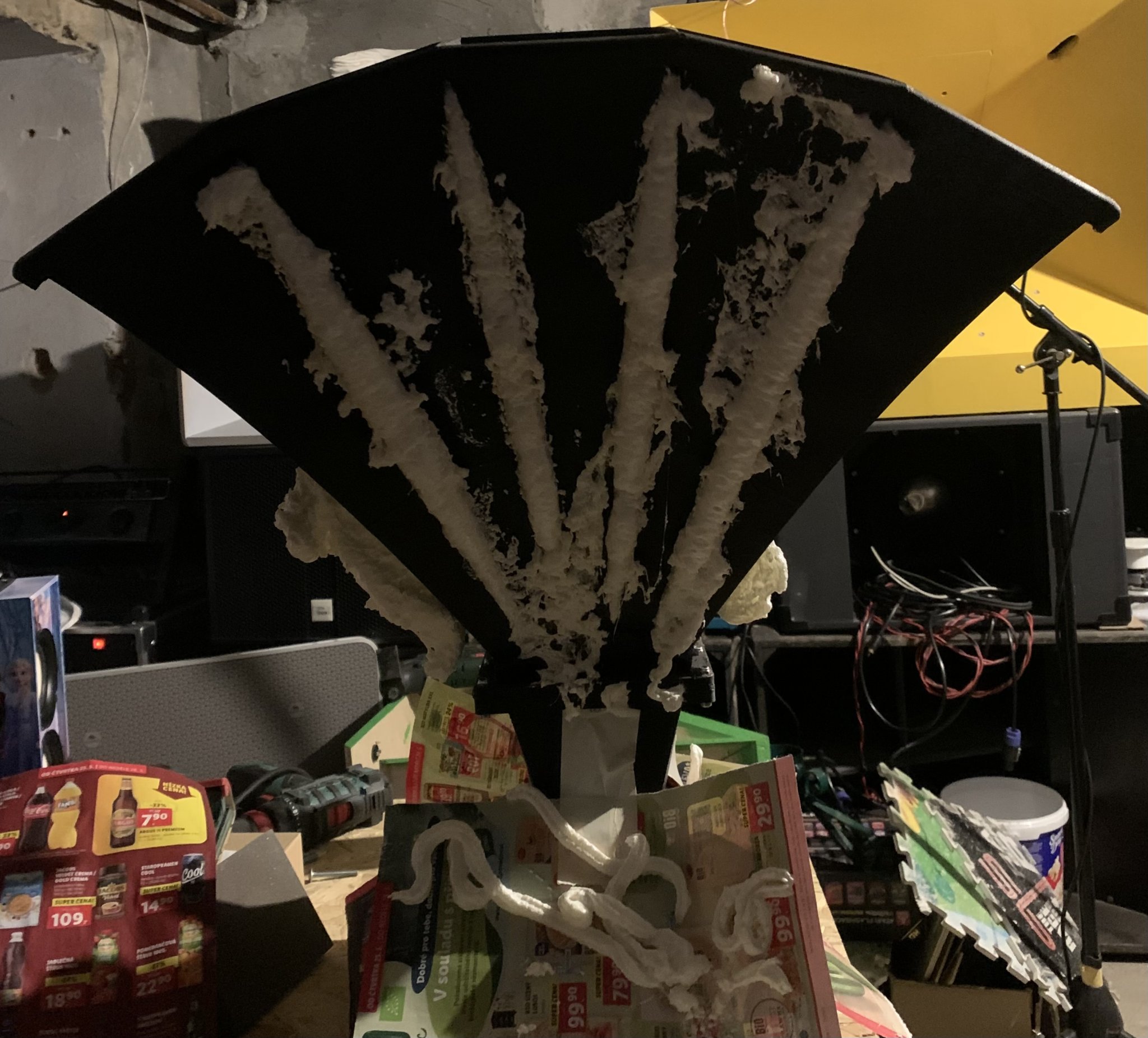

I was too optimistic. There are some cracks from the foam hardening. Also, the filling is a bit uneven, I can still feel some voids behind the walls. On the other hand, where there was the correct amount of foam, it feels really solid and damped.
Maybe one could prevent the cracks if doing it in steps or even during build up (filling the triplets first and then after gluing two triplets together), but I cannot recommend the PU foam for this purpose. Maybe casting (non expanding) polyurethane would be better.
I think the horn would be still repairable, the cracks could be filled and there would be no measurable influence on sound, it would just not look as good.
Anyway, this was a very enjoyable project and it served as a proof to myself that multicell horns can work really well.
