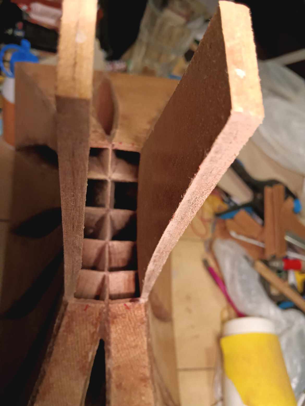

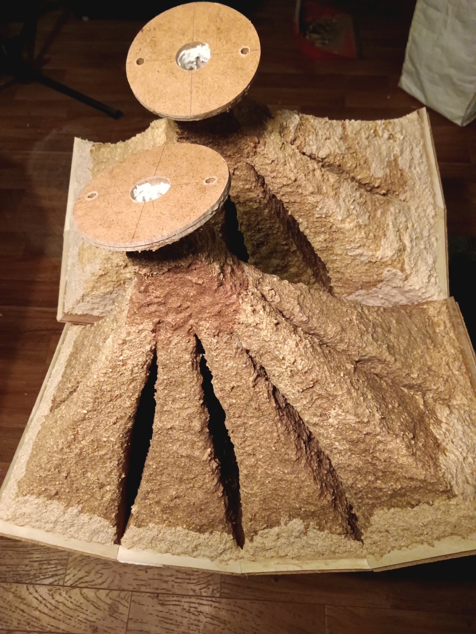

Oh my! Surprising with the low expansion foam. Are the splits at the glue joins? The voids are disappointing, perhaps it would take some practice to achieve a perfect fill.
Thanks for doing this and showing your work!
Is it not worth hooking them up to hear if the foam makes an audible difference? (Not saying I think you should. Just asking your opinion.)
I am pretty sure I could not tell the difference...it has been a long time since I listened to the multicell setup. Even without the foam, I could not see any artifacts in the measurements that could be attributed to the horn. My thought is that the thin plastic wall is pretty damped by its material properties - at least for the SPL I listened at. It is soft, but not resonant. Maybe at higher SPL, there could be a difference.

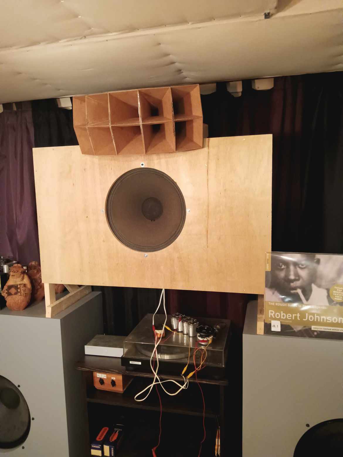

Nothing as fancy as an Altec, but at least an old Fane 15" 15 ohms driver. Somewhat similar to the one on this link, but not exactly identical: https://www.vintage-radio.net/forum/showthread.php?t=86026

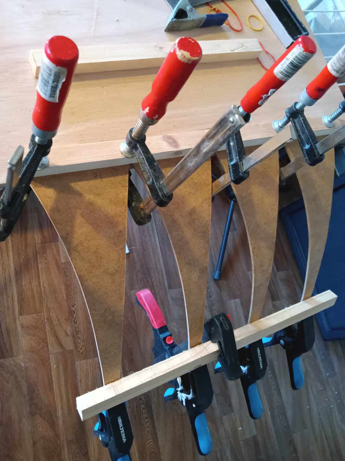

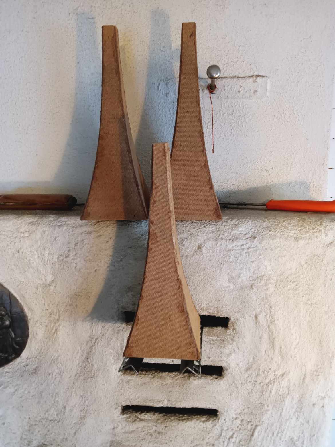

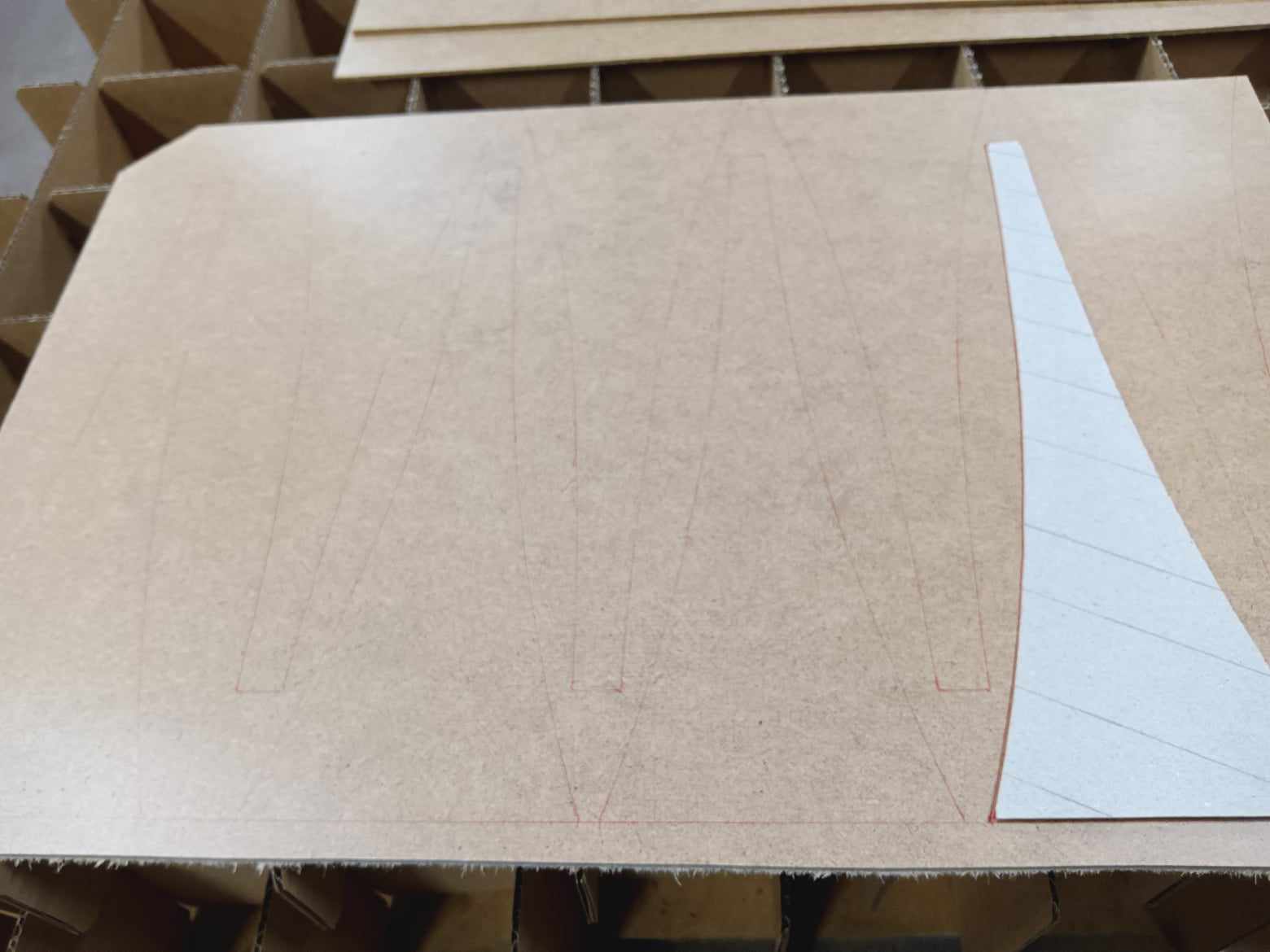

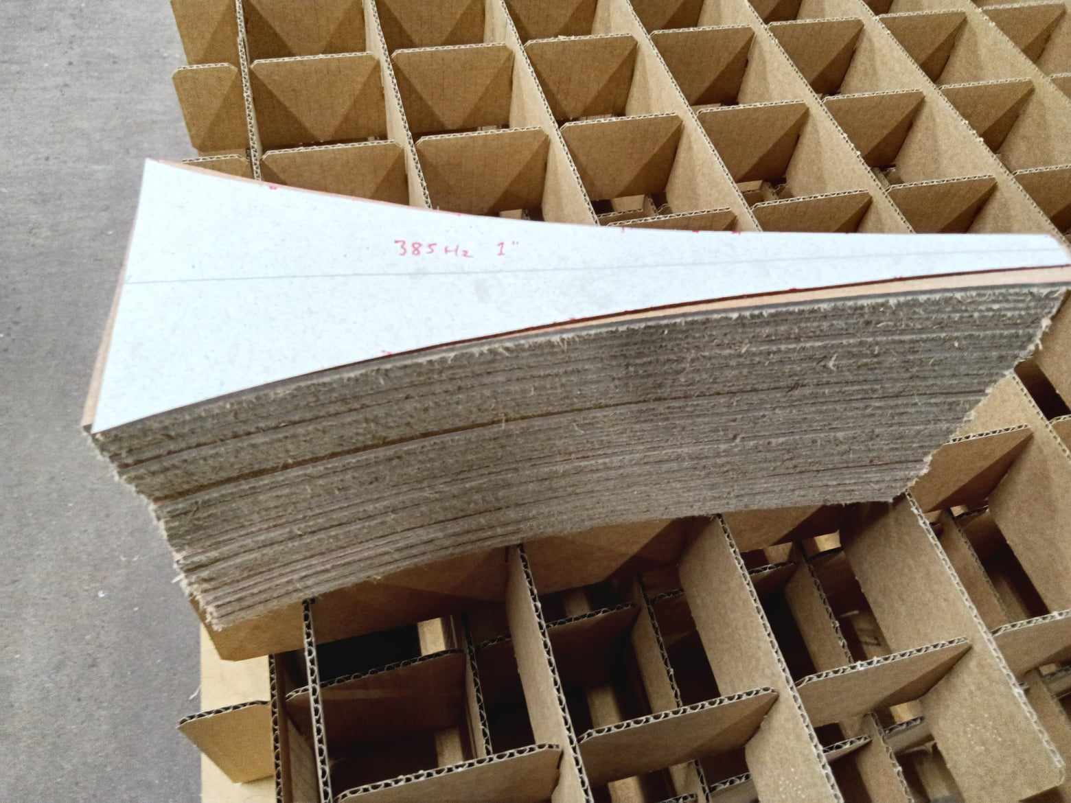

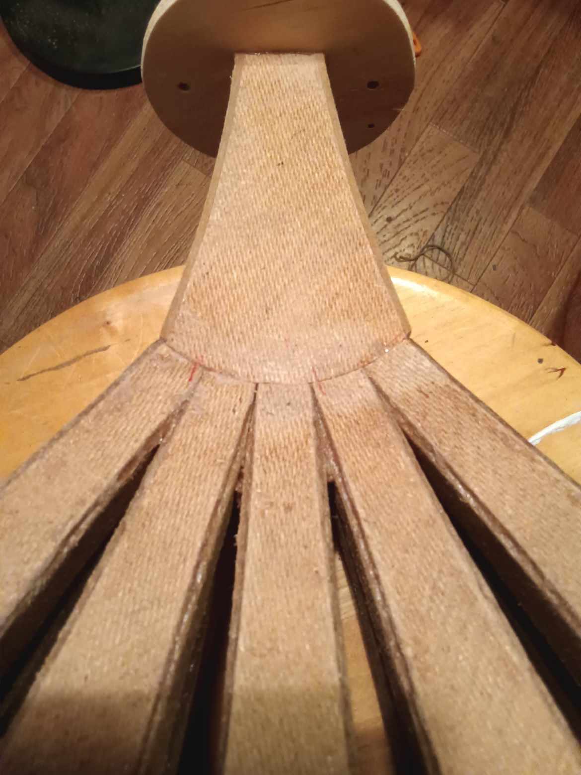

A few construction notes: Due to lack of tools and a proper workspace I didn't use Petters method with routing the cell sides against a mold to get 45 degree edges. Instead I just cut them out one by one with the bandsaw as exactly as I could, then bundled them together and sanded them. This turned out surprisingly well, although the assembly was a bit of a mess. Pre-bending each cell side (masonite bends easily if you brush some water on it) helped a lot, then I used a hot glue gun to "spot weld" the sides together before applying PVA glue. Once the PVA glue had set, I cut away the blobs of hot glue and filled the joints with a "porridge" of PVA glue and masonite dust.
This method works but if anyone wants to build multicell horns I'd definitely recommend Petters method, preferably with a mold made of metal.
This was just something I came up with to entertain myself during slow hours at work, with a low key ambition to build a retro-style mono rig of leftover parts and drivers (which, in turn, is just an excuse to build weird mono tube amps out of odd bits and pieces...🙂 )

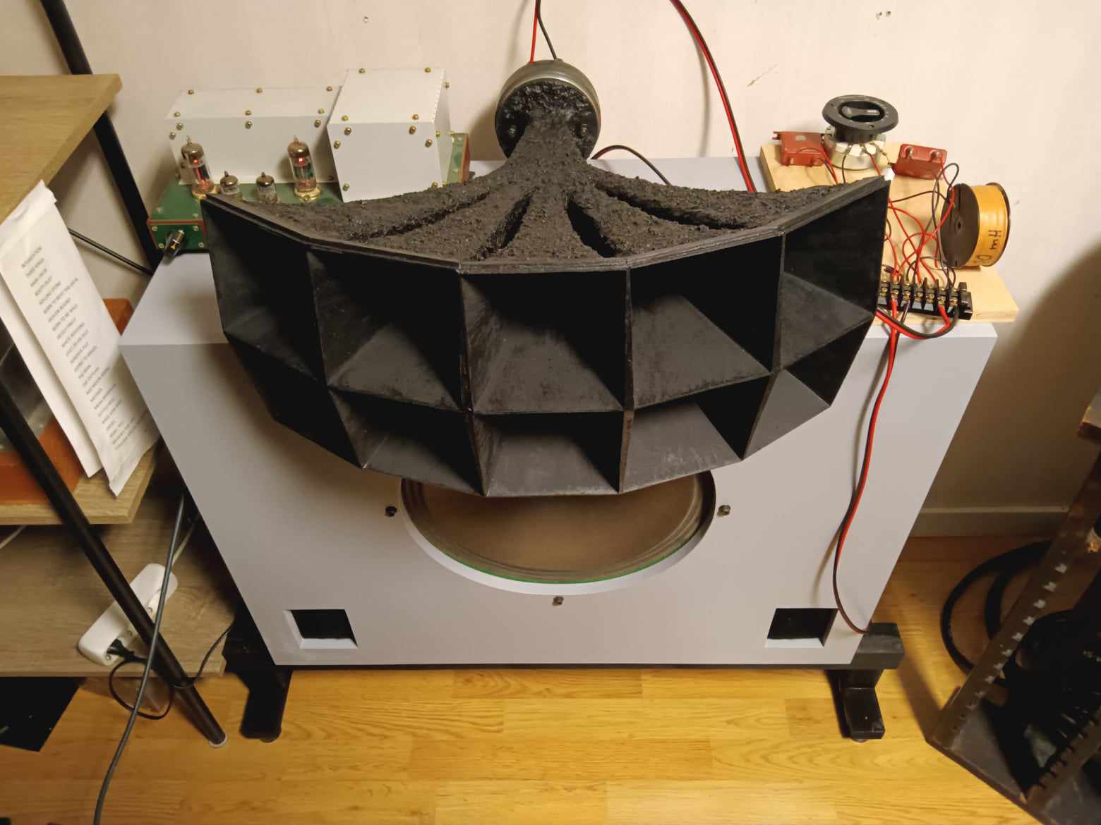

Thanks Kay! A closer look at the horn would reveal that it is a rather sloppy build, but I´d say it's good enough considering it being made on on a miniscule budget (bought some super glue that I didn't use) and with only a bandsaw and some hand tools.
Thanks!
So far I've only listened to it with a very simple 6/6dB crossover and an L-pad for the horn. Sounds quite decent by all means, but I'm sure it can get better with a proper crossover and some LCR sorcery to tame the midbass and midrange. Some kind of damping on the horn walls would probably help calming things down a bit too.
Putting the woofer in an open baffle close to the back wall wasn't entirely successful, might rebuild it to an aperiod box later on.
