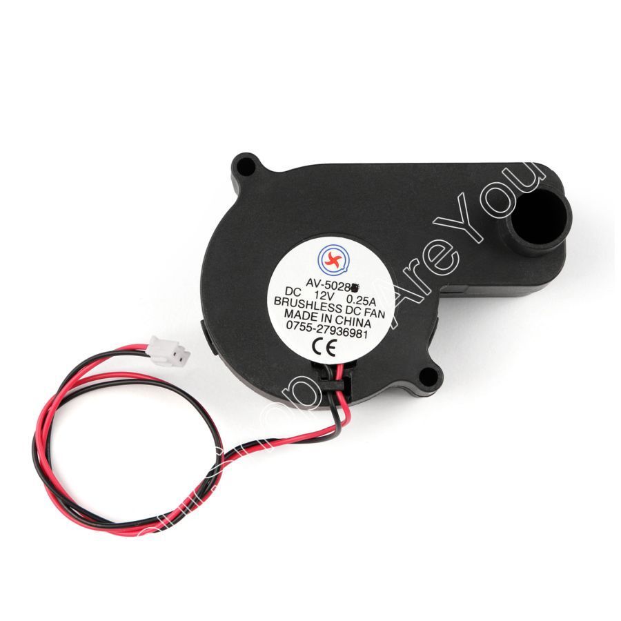

Here is one. All I need now is some conduit to go over the outlet of the fan: DC Brushless Cooling PC Computer Fan 12V 5028s 50x50x28mm 0.25A 2 Pin Wire AU | eBay
I could mount that fan on the inside of the plastic battery box, possibly in the lid, and then use a step drill to drill a hole in the side or top of the box for the oulet to come out of, then get some plastic conduit to go over the outlet with a clamp. I can then wire it up so that the fan comes on when the ignition is turned to the on position.
Its either that or relying on the air vents which are in the car as standard to vent explosive gas out of the boot and for the rear seats to provide a sufficient enough air seal around the rear parcel shelf opening to prevent the hydrogen gas and oxygen from escaping into the cabin of the car. Netherless an exploding boot would be a nice experience for someone into that sort of music.
I'm 100% sure that I'm going to end up wanting to try out flooded deep cycle batteries instead of sealed ones at some point so it is essential that I solve the problem.
I've thought about drilling a 40mm hole and inserting a 12v brushless DC fan and wiring it up so that it turns on when the ignition is in the ON position, a 85 amp dual battery solenoid which I'm buying on Monday will also be wired in the same fashion. The dual battery solenoid is a source of spark so this battery venting problem must be solved. Maybe possibly mounting the dual battery solenoid underneath the boot somewhere to the metal framework would be a good idea, that way it won't be a possible source of ignition inside of the boot anymore.

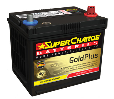

In other news today I started my car for the first time with the battery in the boot. Was slightly slower than usual but it cranked over without issues. Voltage drop between the front of the car/alternator and the battery in the boot was entirely non existent without a load applied to the alternator, as soon as I turned the headlights on it reduced by 0.01v at the boot end.
Voltage was sitting at 14.70v, nice and healthy, at both ends while the engine was running.
I think my starter battery is getting a bit old, reason why I say that is after I took it for a long drive last week/fortnight the battery voltage was sitting fairly low at 12.60v AND the little liquid eye indicator was showing that the battery was flat (clear), I suspect that it has a reduced amp hour capacity, wish I could check it somehow. Leaving a certain wattage of headlight on for a few hours after its fully charged and has been resting for a few hours perhaps? Then time it and do the math on the amp hour capacity... Might do that at some point.
If its just low on electrolyte then I cannot top it up, its a sealed calcium-calcium battery. Sure, I could break open the lid and top it up but I don't want to have to do that, I would much rather just replace it with a new flooded cell if its starting to go south.
Its a Supercharge Gold Plus, getting quite old now at least 5 years old, I expect my batteries to last at least for 10 years of use as I keep them in good condition with a regular trickle charge with a solar panel. SuperCharge GOLD PLUS - Supercharge Batteries
I don't know it just makes me nervous somehow with that eye indicator being white like that when the battery voltage was at 12.60v. Makes me wonder if the electrolyte inside has evaporated and hasn't recombined. If thats the case then its like a pressure vessel waiting to explode and I should probably get it out of my boot and replace it with a flooded cell that at least has the ability to vent the gas and not contain it. I do have some experience working with sealed lead acid cells and if you ask me they are more trouble than they are worth.

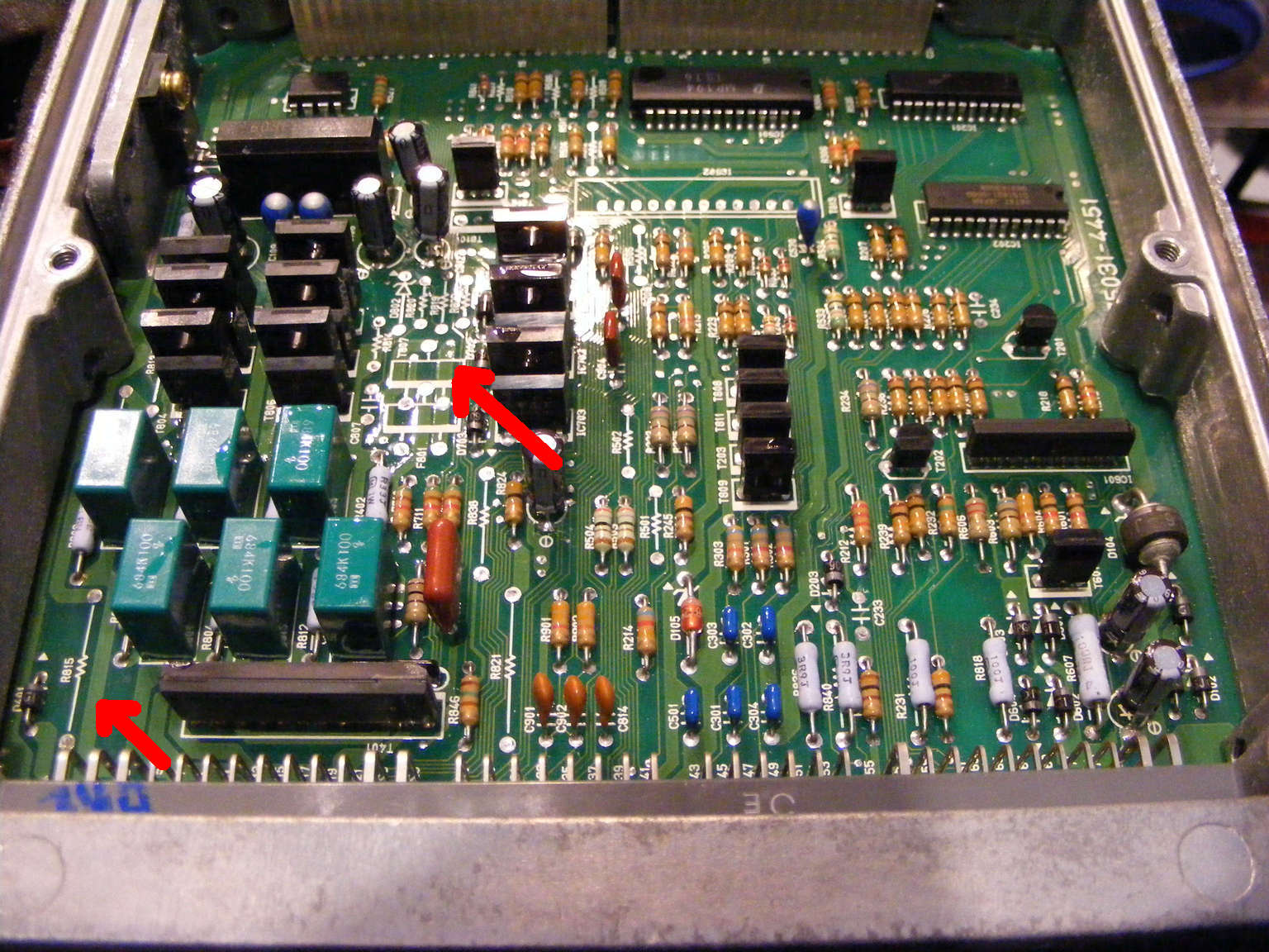

Oh by the way the ECU that I got from the wreckers (89661-33270) has the exact same leaking capacitor as my original one (89661-33570), pcb has damaged traces in roughly the same area too around the same capacitor, the 220uF one.
The two ECUs, My original, 89661-33570 and the one purchased from the wreckers, 89661-33270 appear to be identical internally except for a few components that are present in the one from the wreckers but absent in my original ecu. Notably: R815 and T807 are present in the one from the wreckers, 89661-33270.
IC751 is also different. The wreckers one, 89661-3327 has a "D151803-2600" whereas the original one from mine has an ic of "D151804-3670".
Questions are abound on weather or not it could be a direct replacement, I would need to consult the ECU pinouts to see what those 'extra' components go to and see weather or not plugging this wreckers ecu into my car would cause any damage or not. A job for another day.
Same engine, same transmission, same car, same ecu pinouts, different year, 1994 (wreckers ECU year) vs 1997 (my original).
Attached pic shows red arrows where there are two additional components in the wreckers ECU (89661-33270), pic is of original ECU (89661-33570)

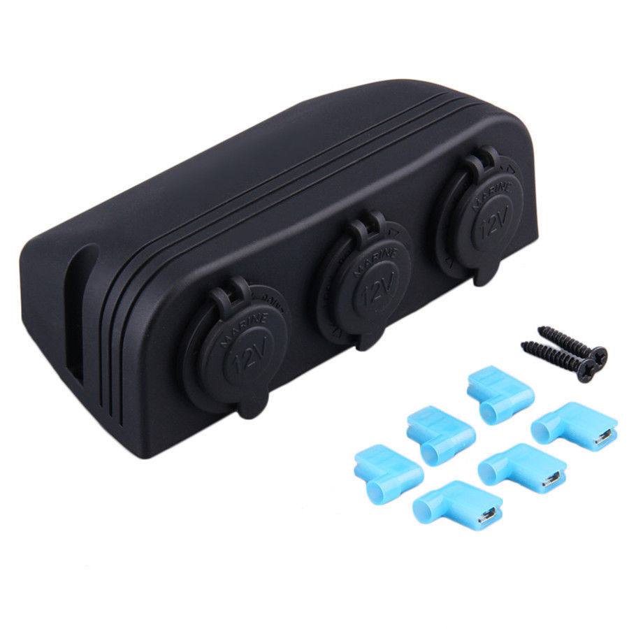

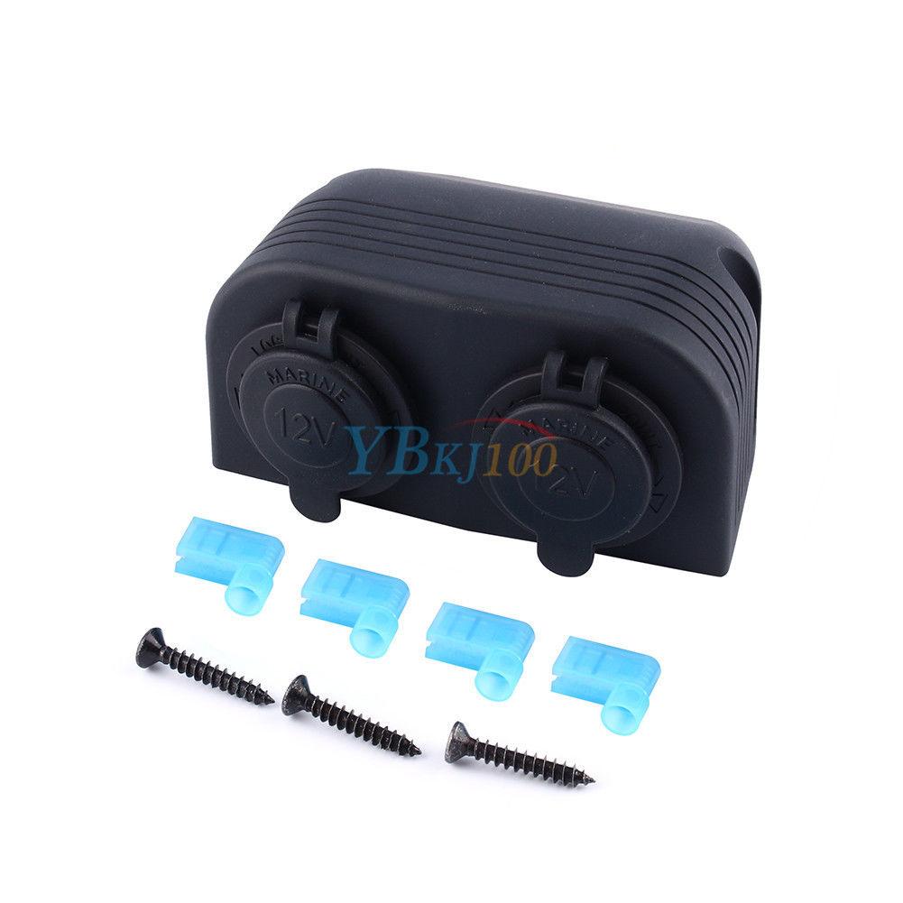

In other news I bought some 3x 12v cigarette lighter socket surface mount for the front of the car so that a passenger sitting in the front seat, and myself in the drivers seat, can use a laptop and recharge an ipad and power a GPS and operate an inverter (inverters are quite noisy usually though).
I also bought a 2x cigarette lighter socket surface mount outlet for the rear seats of the car so that I can sit in the back and use a laptop, charge an ipad, use a usb light, light a cigarette, and any passengers can also do the same.
I'll be using some 12-14 AWG twinlead wire to power the sockets, feeding them from the auxiliary battery in the boot, going into the car from the boot via 12-14 AWG for the lowest possible voltage drop. I hate voltage drop with a vengeance.

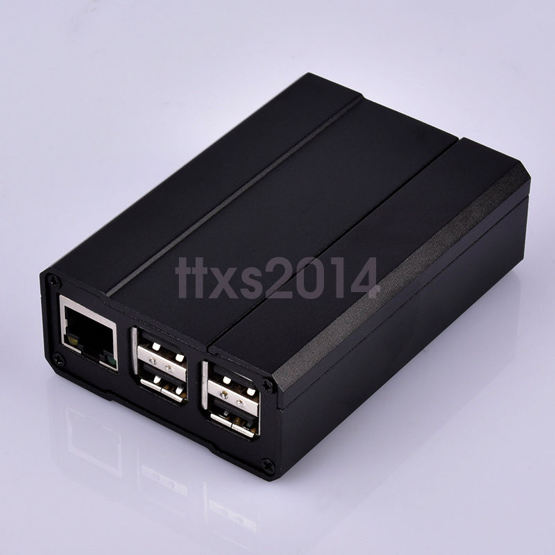

Also got some Raspberry Pi cases, would love to try out a Rpi in a car for a security system possibly.

Not sure what that extra driver circuit is for, could probably find out if you dig around enough, but I’d be inclined to get the same number. Have see many of those for reasonable prices on the auction sites. For other cars, that is...

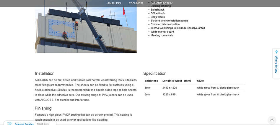

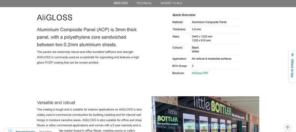

I had one look at the masonite and put some in my trolley when I went around the other isle and had a look at the plastic products, corflux was obviously out because its full of air and it hasn't got the rigidity that I need. But in with all of the thin MDF products I found a material that was rather interesting.
Aluminum Composite panel.
Perfect, more rigid and durable than masonite. Completely impervious to moisture and it comes pre-painted, and its fairly cheap.
AND its about the same weight as masonite, possibly even slightly lighter per area.
It has two layers of thin aluminum sheet sandwiching a single central core of plastic. Apparently widely used for buisness signs. Yachts, Interior Kitchen panelling.
The specific product that I got is called "Aligloss" and is made by Gunnersen – Wood Panel & Decorative Surface Products in Australia and New Zealand
810x1220 in size. "White/Black Aluminum Composite Panel" 3mm thickness. AliGLOSS - Gunnersens

I have used lots of that material, is made for signs facades on buildings, gas stations, is made under different names depending on where you are.
Not a bad choice, but it may be good to treat the edges, since the aluminum portion is only .25 mm thick, and could become a hazard. Maybe some edge guard of some sort?
The only other product that may be one to look at that I can think of is the corrugated clear polycarbonate, 10mm thickness. Is pretty tough for impact, as long as there aren’t any holes in it.
