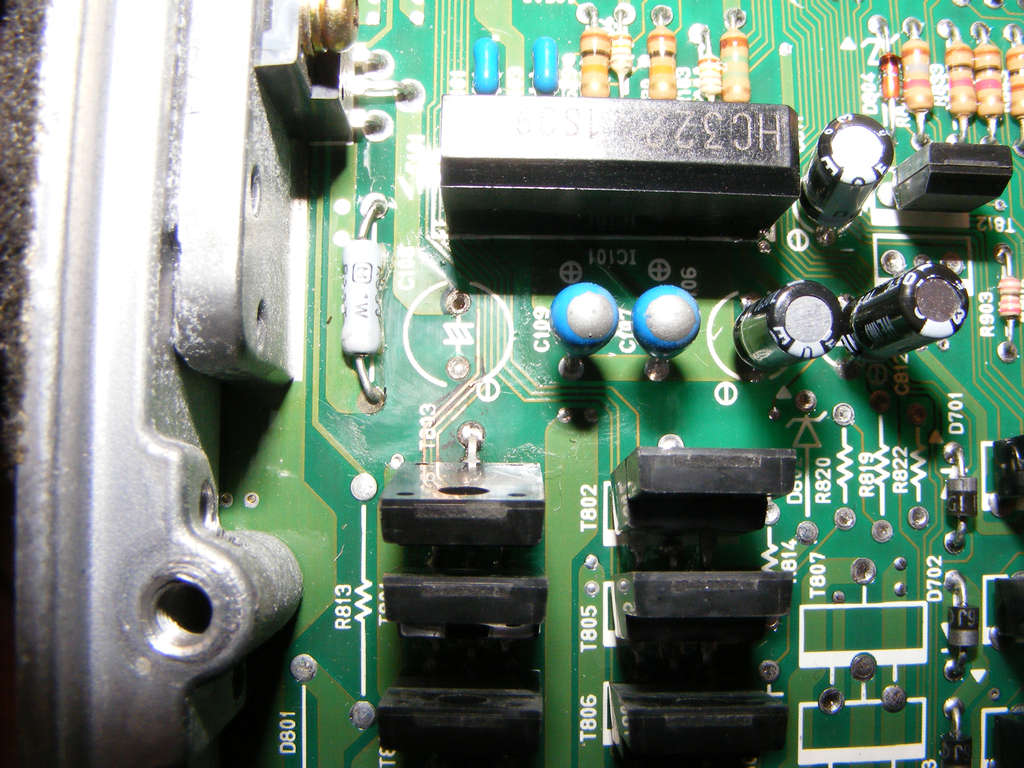

Finally after 6 months of working hard at it its running like a Casio again. Just like it did when I first bought the car. Acceleration is the smoothest I've ever experienced, as nearly as smooth and quiet as an electric car. Exactly what the 3VZ-FE is supposed to sound like, 3VZ-FE is supposed to be the smoothest running engine that Toyota ever developed. But better, this time with Denso Twin Tip spark plugs.
I drove it around for 30 minutes. Another test tomorrow will tell me weather or not if I have completely fixed itself, but signs are REALLY good!

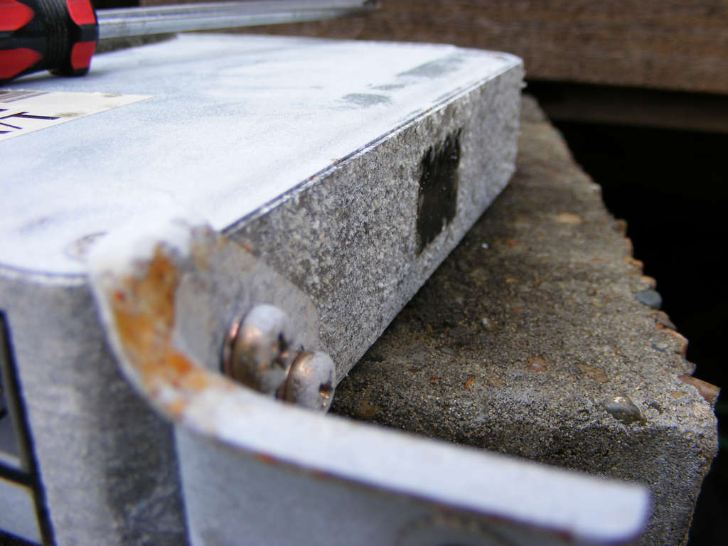

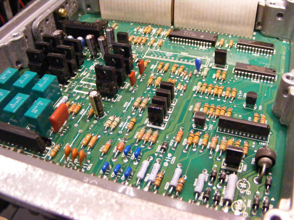

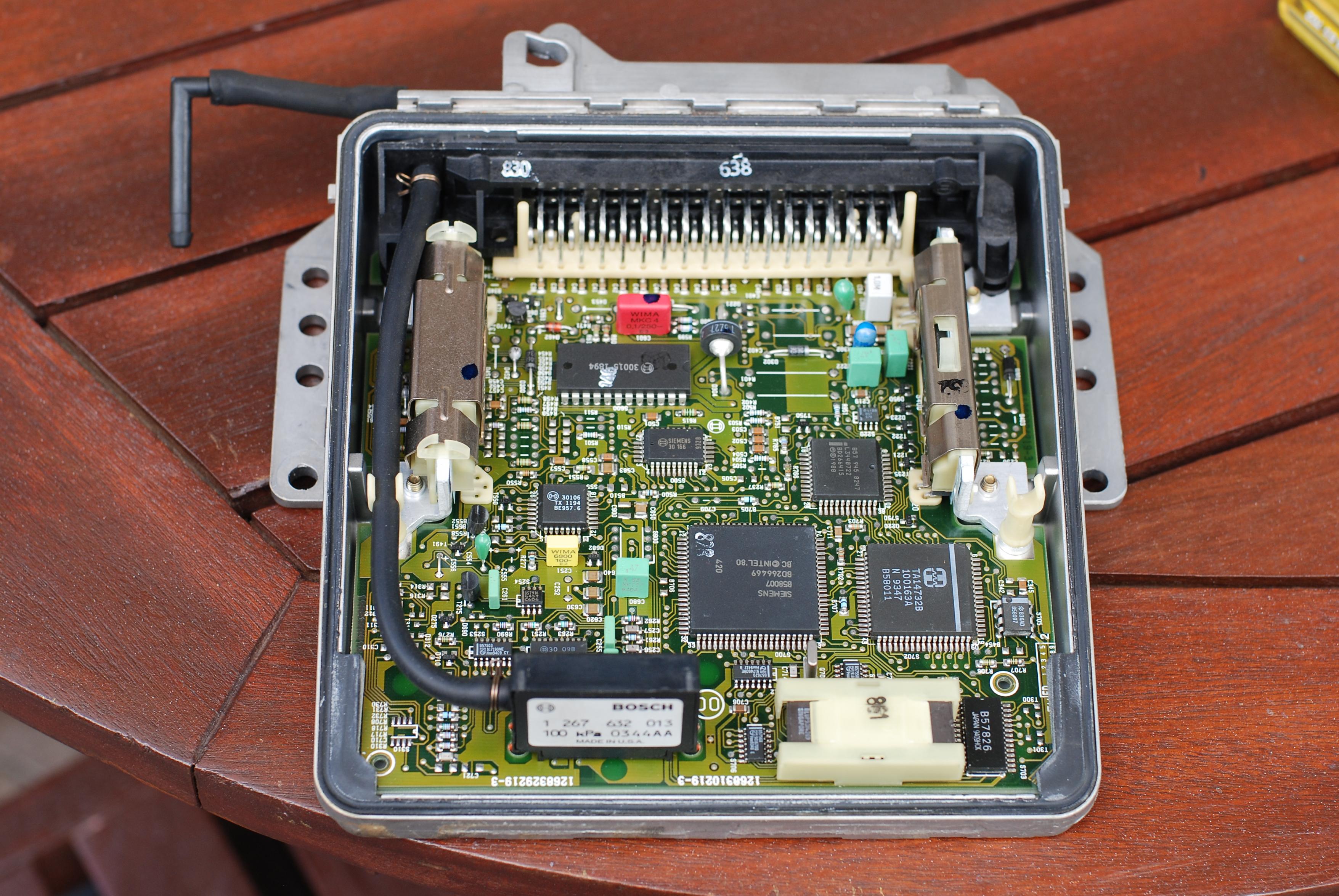

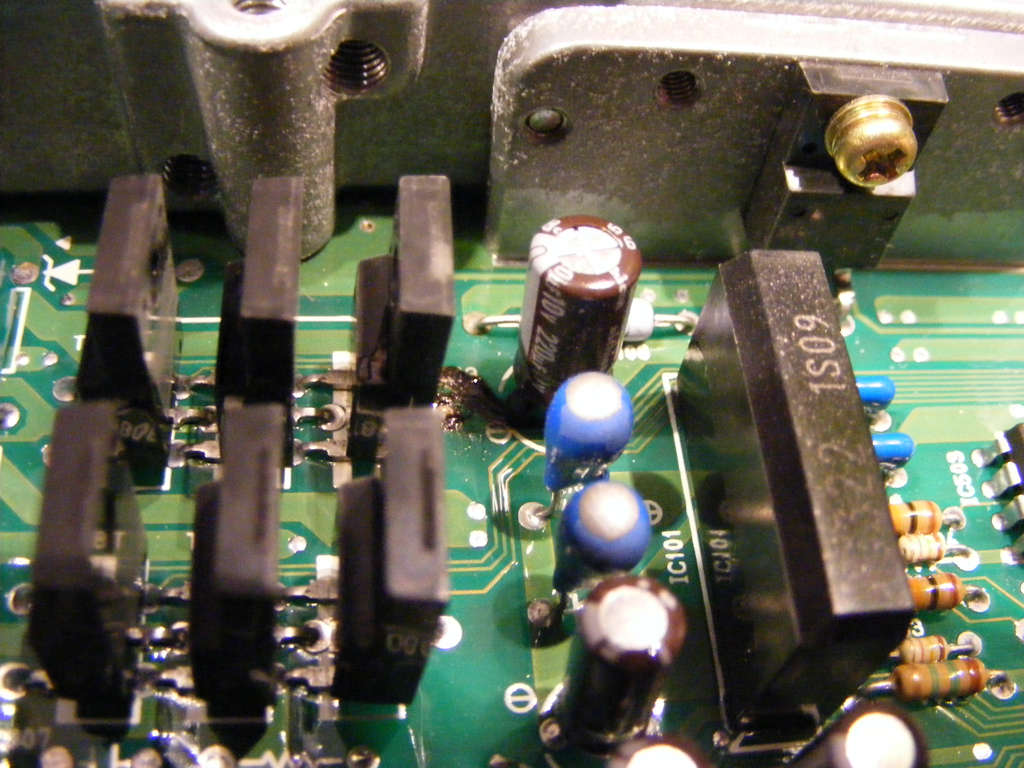

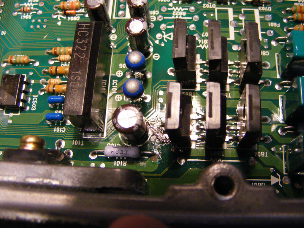

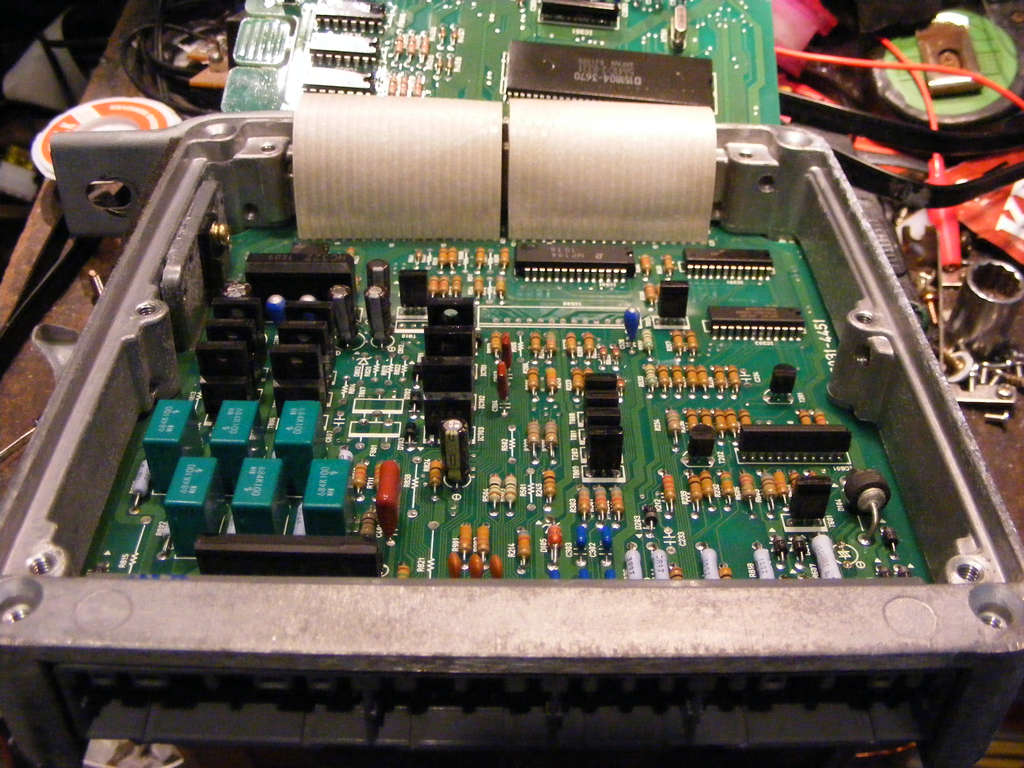

I noticed when I pulled the ECU from the car that the ECU was covered in this corrosion on just one end of it. This is why you don't leave your wet tools in the boot of your car folks. Anyway this is also why I have a container of moisture absorber in my car.
This corrosion hasn't gotten inside of the ECU despite it being very easy for it to do, I got lucky, the entire PCBs are covered in a protective epoxy coating. So moisture won't affect it. But a leaking capacitor spewing electrolyte on the PCB sure will!

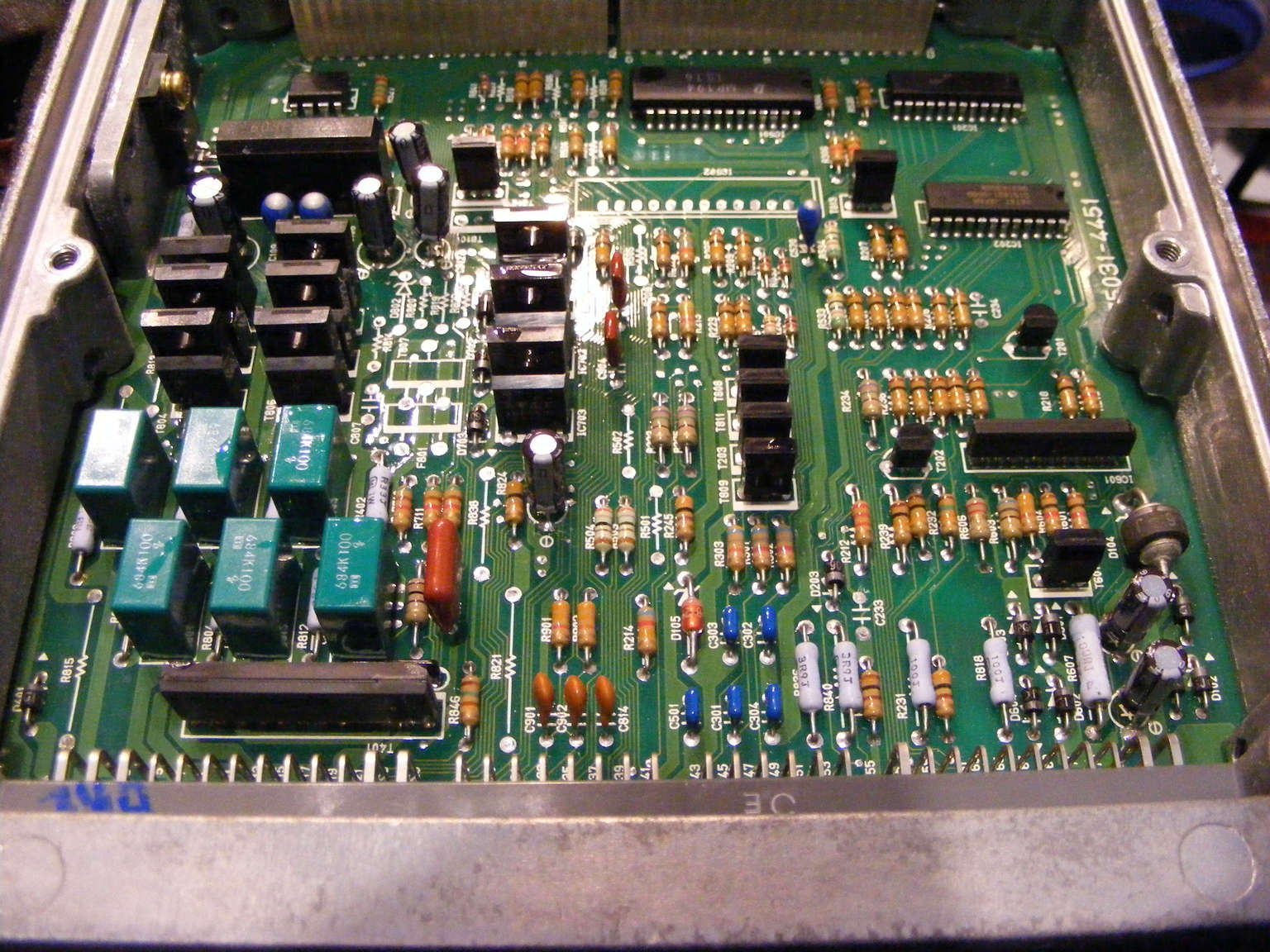

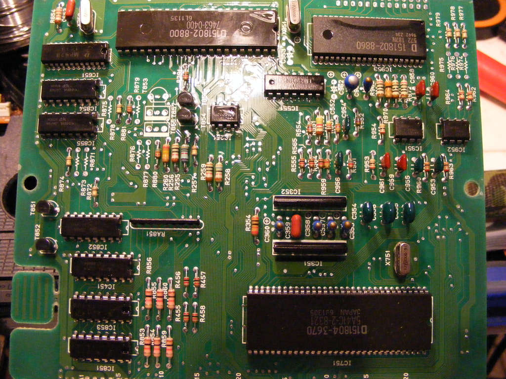

The PCB was kind to me and didn't really act up or misbehave when trying to pull the capacitors out. I would recommend however some small wire cutters to get in underneath the caps and clip them out first. But I didn't have to do that.

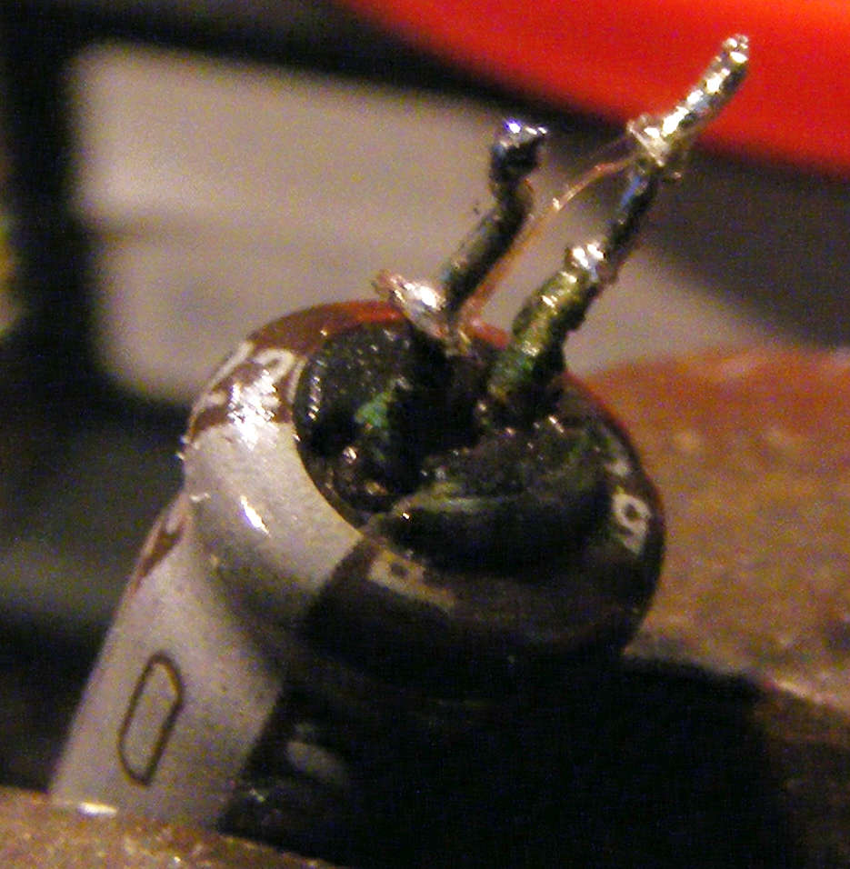

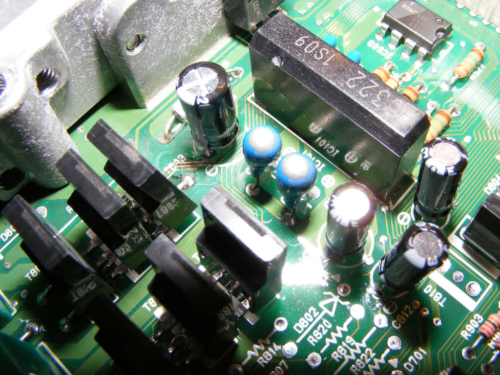

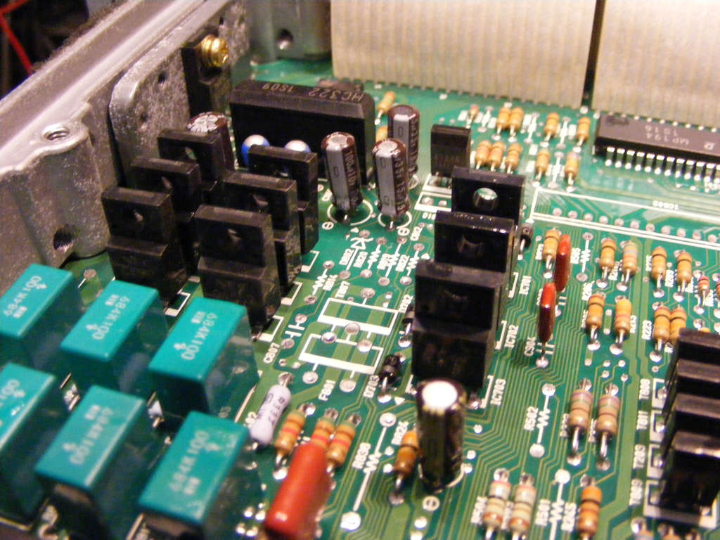

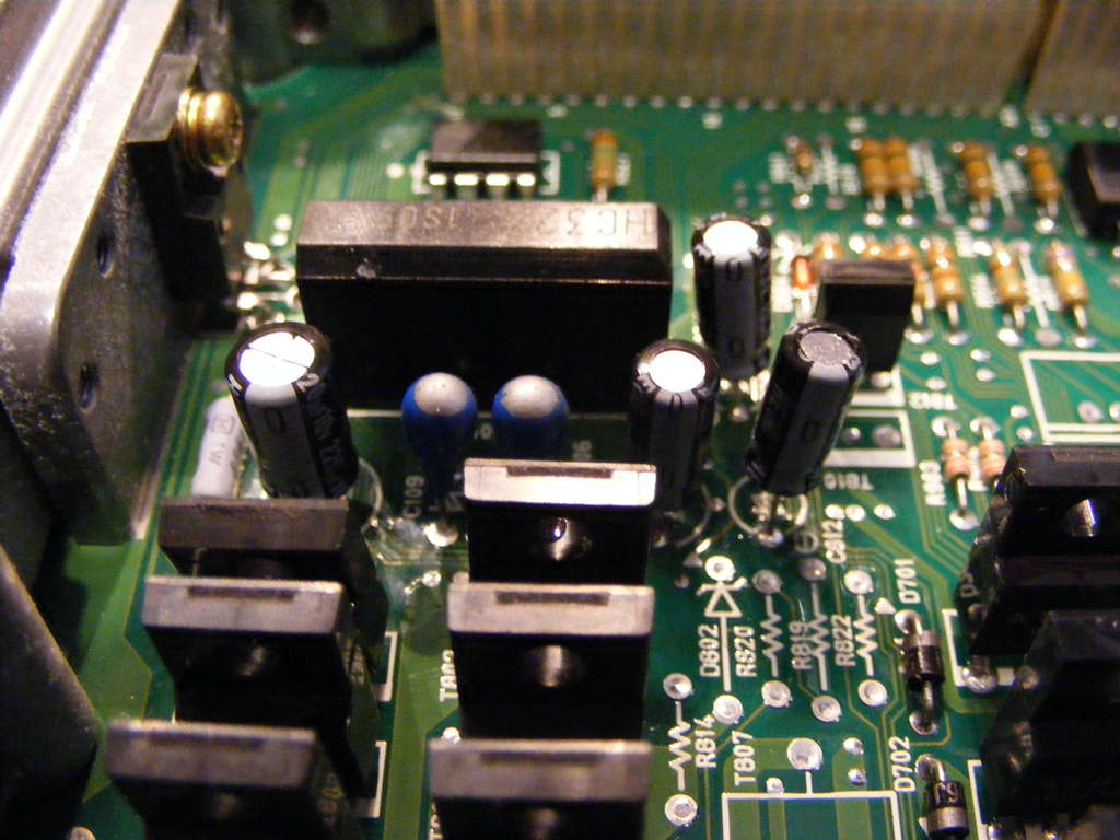

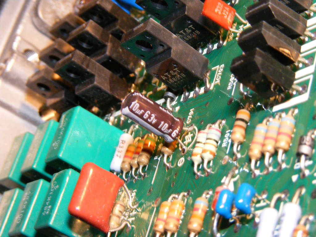

The recapping process:
I first replaced three decoupling capacitors. I then started to work on the damaged area of the pcb surrounding the 220uF capacitor.

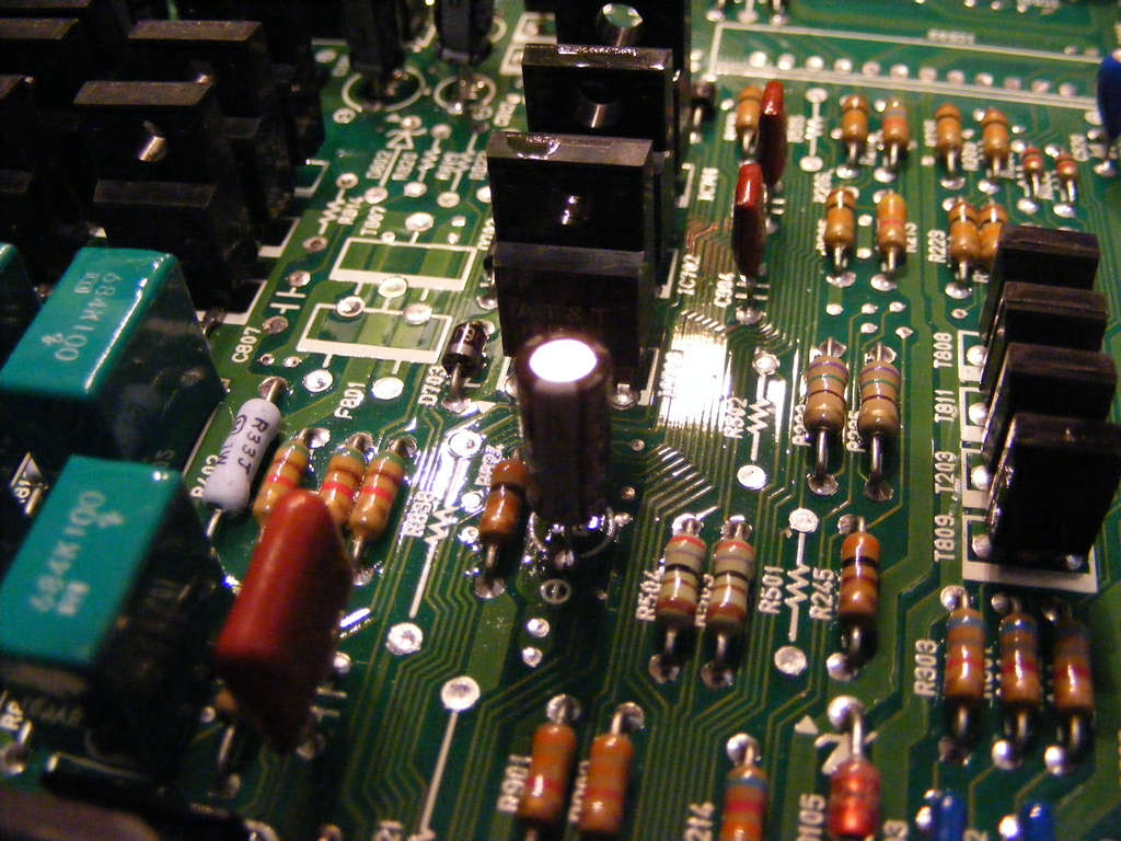

I got some isopropyl alcohol and some q tips and cleaned the black area around the 220uF capacitor.
I checked the traces and scraped back the protective layer off of the traces underneath, I then put my multimeter on the traces and traced them back to the switching transistors below. Each transistor corresponded to a certain trace, I simply scraped back some of the protective layer up above on the pcb and made sure that the traces were still connected.
Making sure that the traces were still working, I simply replaced the capacitor (it smelt like urine when I was removing the 220uF capacitor) and got some superglue and covered the traces again with a layer of superglue.
I then reassembled the entire computer and sanded back the corrosion on the outside of the ECU case with some 100 grit wet and dry sandpaper.
My suspicion is that the leaking electrolyte was conducting electricity to the switching transistor and making the injector turn on and stay on, or that it was earthing it to the earthed side of the capacitor.
