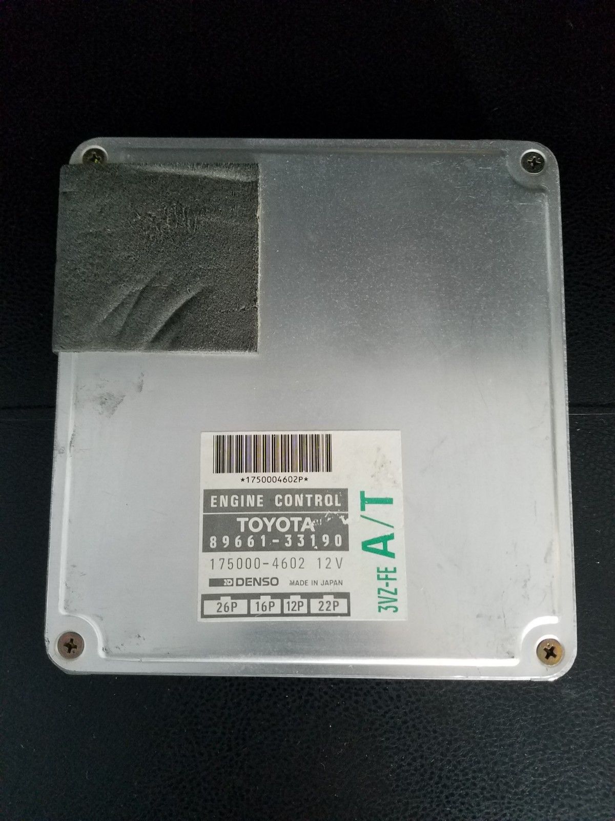

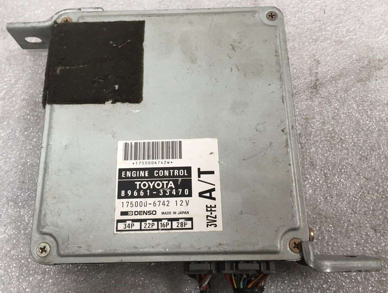

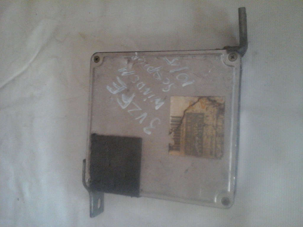

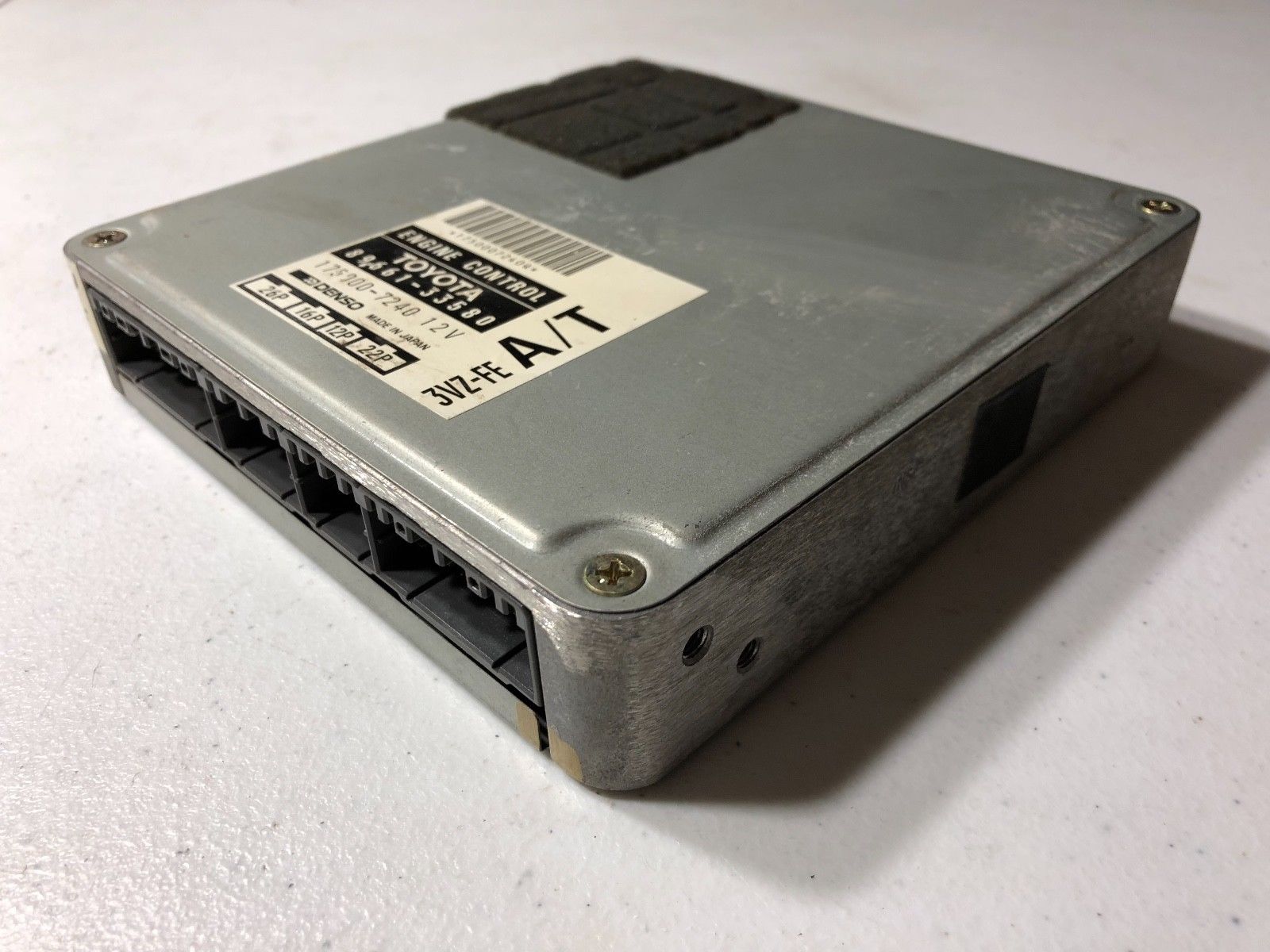

Okay so the wreckers failed me again. sent me a 1MZ-FE ECU instead of a 3VZ-FE ECU... help is hard to find these days.
Anyway I've found a possible substitute if I can't find my original part number, which is 89661-33570. An alternative is 89661-33470. Another substitute might be the Toyota Windom ECU from Russia, part number is: 89661-33200
All three of these part numbers correspond to an automatic transmission 3VZ-FE. Not 3VZ, not 1MZ, 3VZ-FE with an Auto transmission and they all look identical.
It appears that my car's ECU is an unmodified Japanese import. so I might have to look to Japan to find a spare.

Nope.
The ECU part number cannot be substituted. At least not without rewiring the wiring harnesses. For a plug and play replacement it must be a 33570.

Substitutes with correct pinouts:
89661-33570 (Original Toyota Vienta Grande with 3VZ-FE A/T)
89661-33580 (1994 Lexus ES300 with 3VZ-FE A/T)
89661-33190 (92-93 Lexus ES300 with 3VZ-FE A/T)
