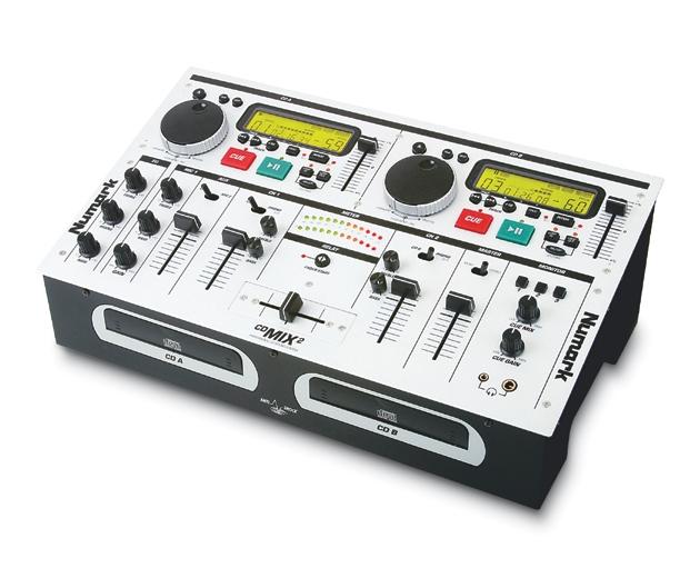

Is the car amp one of the new Response Class-D?
Can't see your inputs from any of those photo's. Is there a DJ working that rig? What equipment is he using? One of my biggest problems has been trying to combine the DJ mixer, CD players, decks, etc.. which have to be 240v via an inverter, with anything that is 12v powered of the same power source. The only way Iv'e been able to get it to work is if I have the amps running through the same inverter.

One of my friends is a techno/electronica DJ/composer (I'm more into metal myself). and when we have beach/festival parties he use an ancient celeron laptop with a pro 5.1 USB soundcard attached using two channels to a standard mixer. He use a ancient piece of DJ software that only runs on Win95/98.
Everything runs directly on 12V since the mixer has a 12V wallwart, and the soundcard is USB powered. The laptop is slightly modified with a external USB harddrive containing the music and more interestingly a piece of wood cut to the same dimensions as the laptop battery with external leads to get directly to 12V because although the original PSU for the laptop specifies a 18V output the battery pack itself is as in most old laptops a 10 cell NiMH pack which is drectly replacable by a car battery.
I'll get the name and possibly a link for that software when I'm visiting him this weekend because he's the one who'll be salvaging the CAD files from the crashed harddrive anyways.
