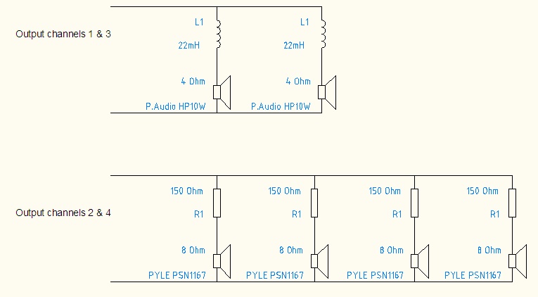

Sorry, CAD ate a few decimal points there (they would be some big coils!). Supposed to read 0.22mH
looks good to me. Didn't you say you have 4 of the P-audio 10" 4ohm drivers though? Are you only going to use 2 of them?

you only need one resistor for the tweeters.
so for one channel (two sides, two tweeters per side)
---------------[res]-----------o +
P P P P
--------------------------------o -

150 ohm is much too high for the series resistor.
My understanding is this:
the series resistor does not form a high pass filter - it in fact is a low pass (high pass filters require the cap in series and the resistor in parallel with the load - this is the other way round)
It is a low pass filter designed to prevent high frequency oscillations (100kHz or so) in the amp. the psn 1167's have a capacitance of around .12uF, and the manufacturer recommends a series resistance of 30ohms - this results in a lowpass filter with a corner freq of around 44kHz.
for 4 of these in parallel, the resistor should be about 8 ohms to maintain the same corner freq, and certainly no more than 15 ohms. 150 ohms, with 4 piezos in parallel, gives a low-pass corner freq of about 2.2kHz - definately not what you want.
the series res should be a 10W non-inductive type.

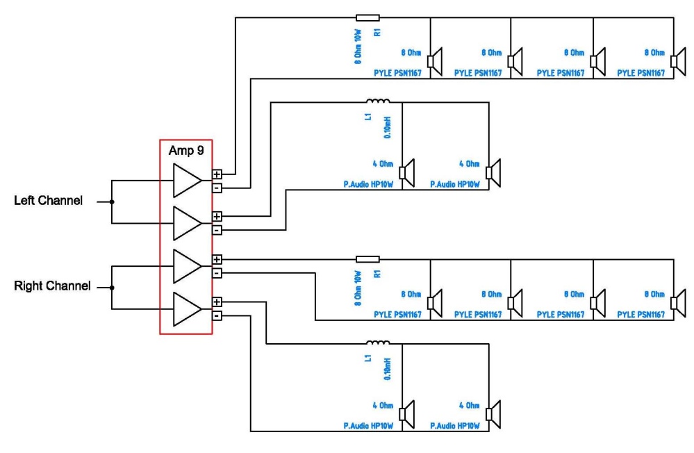

tsnell, if you are using 2 x P-audio 10" per channel it's best to wire them in parallel so that the amp9 sees them as a 2ohm load, especially if you are going to be powering them from 12v. Adjust your low pass accordingly. 3khz, 6db will be nearer 0.10 mH.
col.
col.
tsnell, just had another look at your wiring diagram. It's wrong, wire the drivers in parallel and then put the choke before them, using one only of the right value (0.10mH). For the piezos do as Ben suggested.
col.
col.
I'm sure the advice given by col and anormalous above is well intended but it's certainly not how I would do it. And I can't guarentee my design will work as intended if it's followed.
In fact I will almost guarentee that you will not have sufficient cooling to the amp9 if you parallel the woofers to 2 ohms and use a 24 volt supply at a later time.
With an amp9 I recommend using each of the outputs to drive one set of speakers, where we define a set of speaker as a woofer and any form of tweeter.
I recommend that with piezo you do not filter the woofers and that you parallel connect the piezos to the woofer with a series resistor. With one piezo between 100 and 150 Ohms and with 2 piezos half that for 47 or 68 Ohms standard values. These resistors need only be 1 Watt types but I recommend the carbon 3 Watt types I use.
I strongly recommend that if you do decide to use piezo that you have plenty of excess wire and that you "face" the woofer terminal plates to face the tweeter cut-outs so that if you want to upgrade to a real tweeter at a later date you can dismount the piezos and fish out the wires to woofer, cut the wire and insert a real x-over filter. I just glued the filter component directly to the tweeter horm but note that the proximity to the magnet will affect the inductor so you need to get a multimeter that can measure inductor values to get it completely accurate.

<shrugs> try both, see how they sound. pick what sounds best.
for reference:
Low Pass Filter and High Pass Filter theory.
or wikipedia even
which of these pictures looks like a resistor in series with a capacitive load?
for first order high and low pass RC filters:
cutoff freq in Hz = 1/(2*pi*R*C)
plug the values in and come to your own conclusions.
Col has built a lot of these 41Hz amps, and regularly runs small events with them.
In the spirit of the scientific method, try both configurations and see what works best. your finger on the heatsink is the best measure of whether you have sufficient cooling. report your findings so we can all benefit and mistakes arent replicated.
for my part, i'm quite happy to be shown i'm mistaken - so I'll set up my speaker testing rig and get some some real world response curve measurements on the piezos using a range of resistor values, and then we will have some hard data.
cheers,
Ben

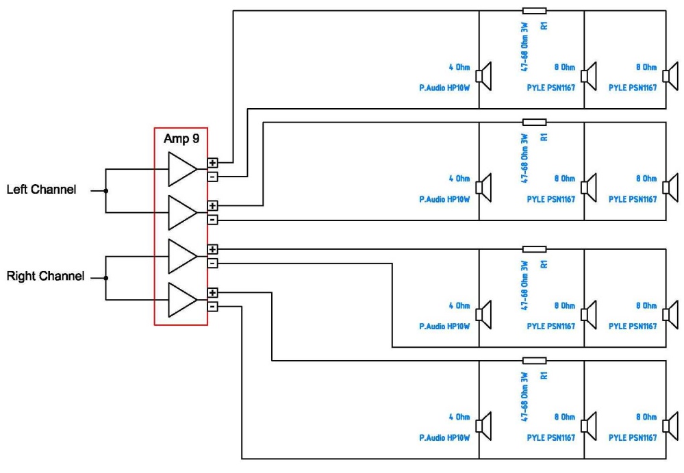

I prefer the first setup diagram. Also, with that one you can use a car rear/front fader to adjust the level between the woofers/piezo. This will also deal with your jack to RCA input dilemma. Iv'e used one of these for a few gigs and it works well. see jaycar CAT. NO. AA0485

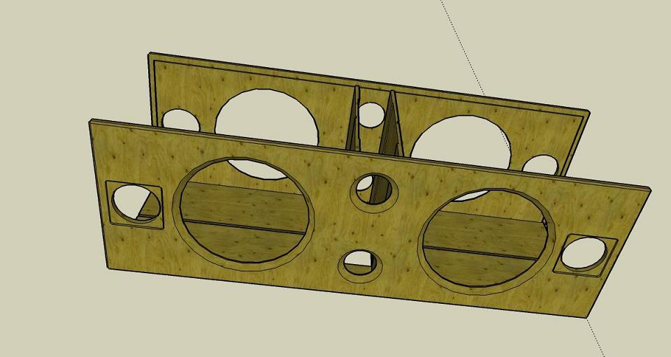

It's 3 separate chambers actually. A left and a right speaker enclosure. And a middle enclosure for batteries and electronics.
I gotten the CAD files. Unfortunately not all could be recreated.
The thing to note is the 160mm wide 3mm deep grooves routed in the both sides of the middle compartment. They allow for the battery to slide in from the bottom because it becomes 66mm wide at that place but doesn't allow for the battery to slide around at all since they are 65mm wide and 150mm long (and about 200mm high when 2 are stacked on top of eachother).
I use a G111 case from Velleman. It's 65mm wide same as the batteries and 55mm high and 115mm long. The case is an aluminium case so it function perfectly as a heatsink as well, and the internal built-in PCB stand-offs fits the holes from the amp6basic perfectly. I use the remaining space on either side to hold cables, chargers (both battery and iPod charger) and the iPod itself. So there's no much left over room for cooling.
