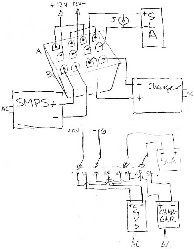

hi fellas! im planing on buildin a portable hifi produkt, sow its not realy a boombox, but anyway its portable and making noice🙂
its suposed to be based on the stereoamp amp6-BASIC
one per of seas p17rcy and some nice tweeters, stereo.
the powersupply will hopefully be a pack of NiMH bateries, 12, around 3 ah. i allsow want to be able to connect it directly to the wall and at the same time im suplying the amp i would like to charge the batteries, is that possible? and how do i fix that?

Hi, 12 cells will give too high voltage when they're fully charged!
It'll probably damage the amp...
What you want to do is easy with an SLA battery as this gets charged with constant voltage. An Nimh battery is charged by pulse voltage, so the hard part of your idea is getting rid of this noise...
Maybe someone else has bright ideas, but I'm afraid you're best off with a separate charger and amplifier power supply.

The sealed SLA "Gel-Cells" don't leak and make nice bateries for portable electronics. They are a little heavy, but they are easy fo find, charge well, have long lives, and can put out a lot of power (amperage) if needed. They can also be charged with the individual cells in series, which makes the circuitry simpler. And compared to NiMH batteries, they don't drain quickly when idle, an annoying drawback of NiMH batteries.
The best chargers use some kind of HF pulsing which "desulfonates" the lead plates, prolonging life.
It's a simple matter of hooking the battery to a double-throw switch, with one position running the box on an AC power supply, with the other position powering the amp by the battery. Also with SLA you can plug a small solar panel in parallel with the battery to prolong life. Hard to do that with NiMH or Lithium cells.

hm yeah the gel-cells ive heard to be good. will that make it possible to charge the battery and supply the amp at the same time? not sure i realy got the? and where can i find such a switch?
may c-tec 3600 be a good charger then?

I would think the 800 model should be all you need, as long as it is a computer-controlled charger with the de-sulfonation feature, which it should be for that price.
I used a four-pole, double-throw switch. Attached is the diagram(s) I used to hook it up, one a circuit, the other more pictorial. The thing with all the terminals is the switch. I chose to not have the charger and SSMPS grounds connected. Not sure if this was the right move, but it seemed to make sense to me at the time.
If you have a battery charger that can run off of 12-13v instead of mains AC, this simplifies things a bit and means you only need one trnsformer instead of two. I haven't yet torn into mine to see if this is a possibility.
