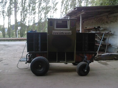

Janoch, as Saturnus said, horns would not work, not that they're not great in many ways, but they do not come in small packages!
I've build some designed by Bill Fitzmaurice that we use for the festival, and with a sensitivity at approx. 110dB they do give a lot af bang for the buck!
But as you can see in the pic, the total package is 180 x 170 x 80 cm total, and weighs 400 kg...
