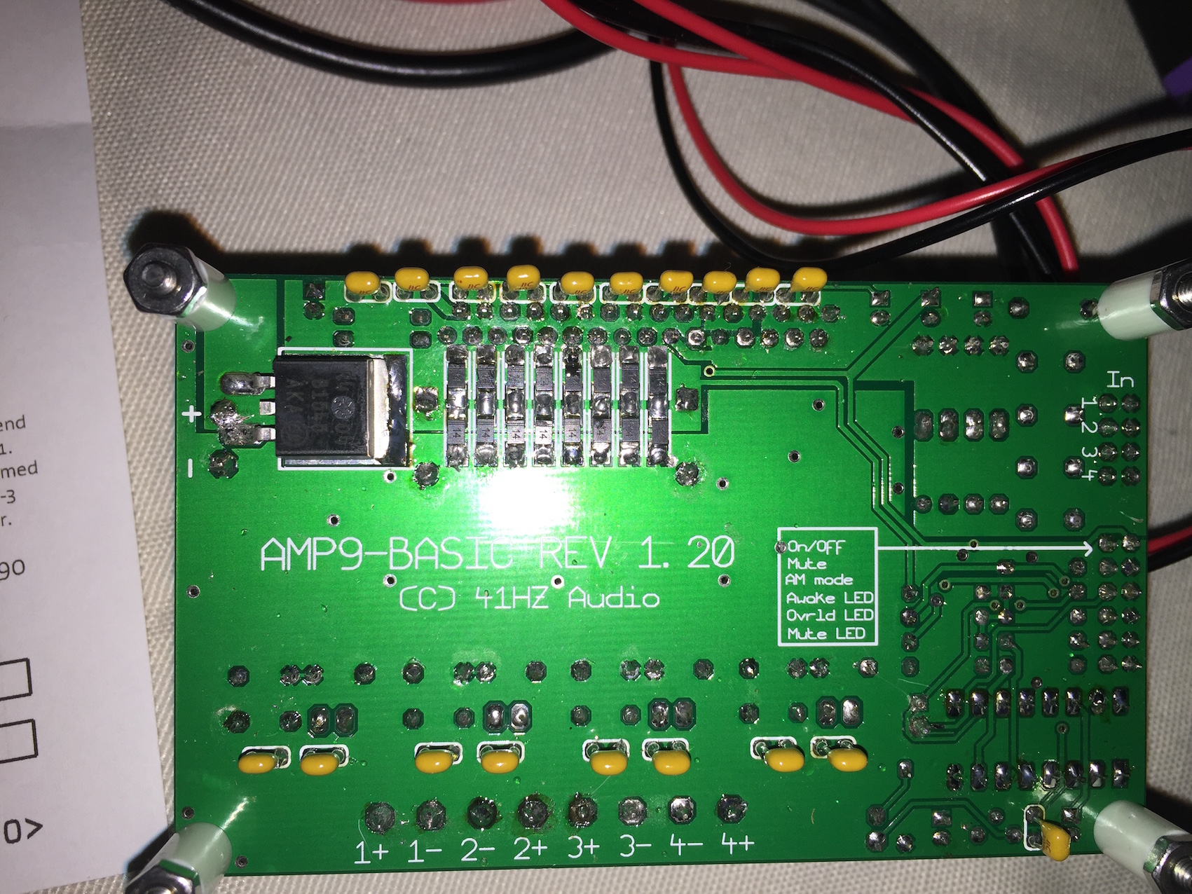

I have one last hope in fixing my Amp9 which is to replace the small IC. I accidentally soldered it directly to the board not seeing that there was a little mount for it... i may have overheated it and fried it.. replacing the tripath chip didn’t fix it.
If I'd go for a high power amp right now it'd be the TPA3251d. Amazing chip, but currently no premade boards available. 5th Element, DrMord and Gmarsh have been doing some designs with them, but nothing is really for sale. Did your board smoke, if not: thermal chips in the problem should be fixed by replacing the chip. Shouldn't damage any other components. Are you sure you soldered it right?

Pretty sure i soldered it correctly.
No smoke. Symptoms are that the tripath chip just heats up and no signal is output.
Also the mute led does't come on even if i jump the mute pins.
I replaced the tripath chip and same result with the second one. I have a third one but I'm not willing to risk it without addressing any other issues first.
