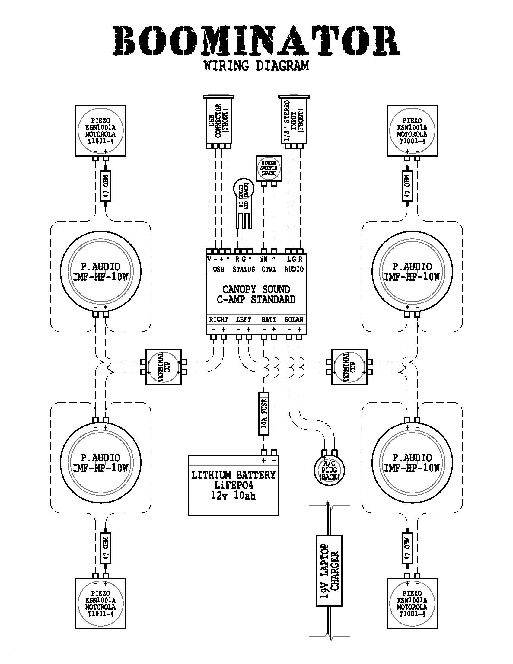

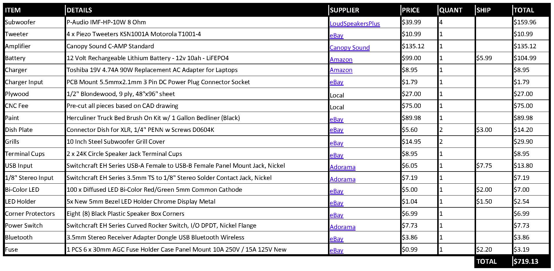

I have been studying this thread and other boominator sites online for the last few months trying to learn as much as possible on this system before I begin trying to build my own. The wood working part will be easy for me but the electronics part is over my head! I am located in the USA so some parts were hard to find but I think I have my parts list complete. The attached images are preliminary drawings for my boominator and a parts list / budget.
Questions:
- Can you guys look this over and see if anything looks way off please?
- Anything I am missing?
- Anywhere I can save some money (total seems pretty high)?
- Does anyone have a complete wiring guide they would be willing to share?

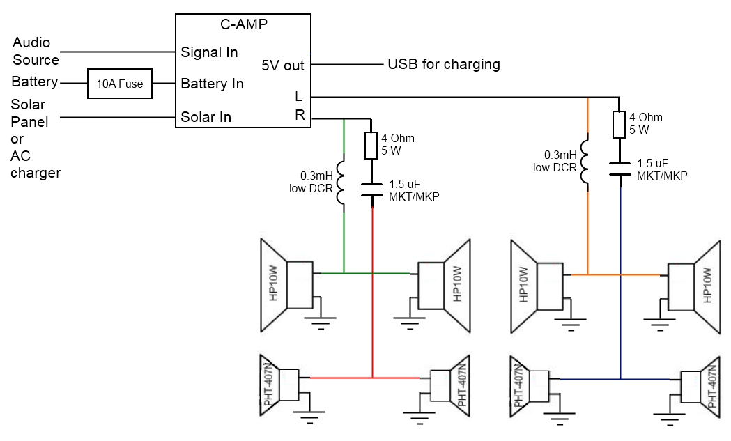

ABayley - I haven't actually built mine yet, mostly because I've been waiting for the C-AMP to be available, but I believe this is the right wiring if you go with the HP10Ws and the PHT-407Ns:

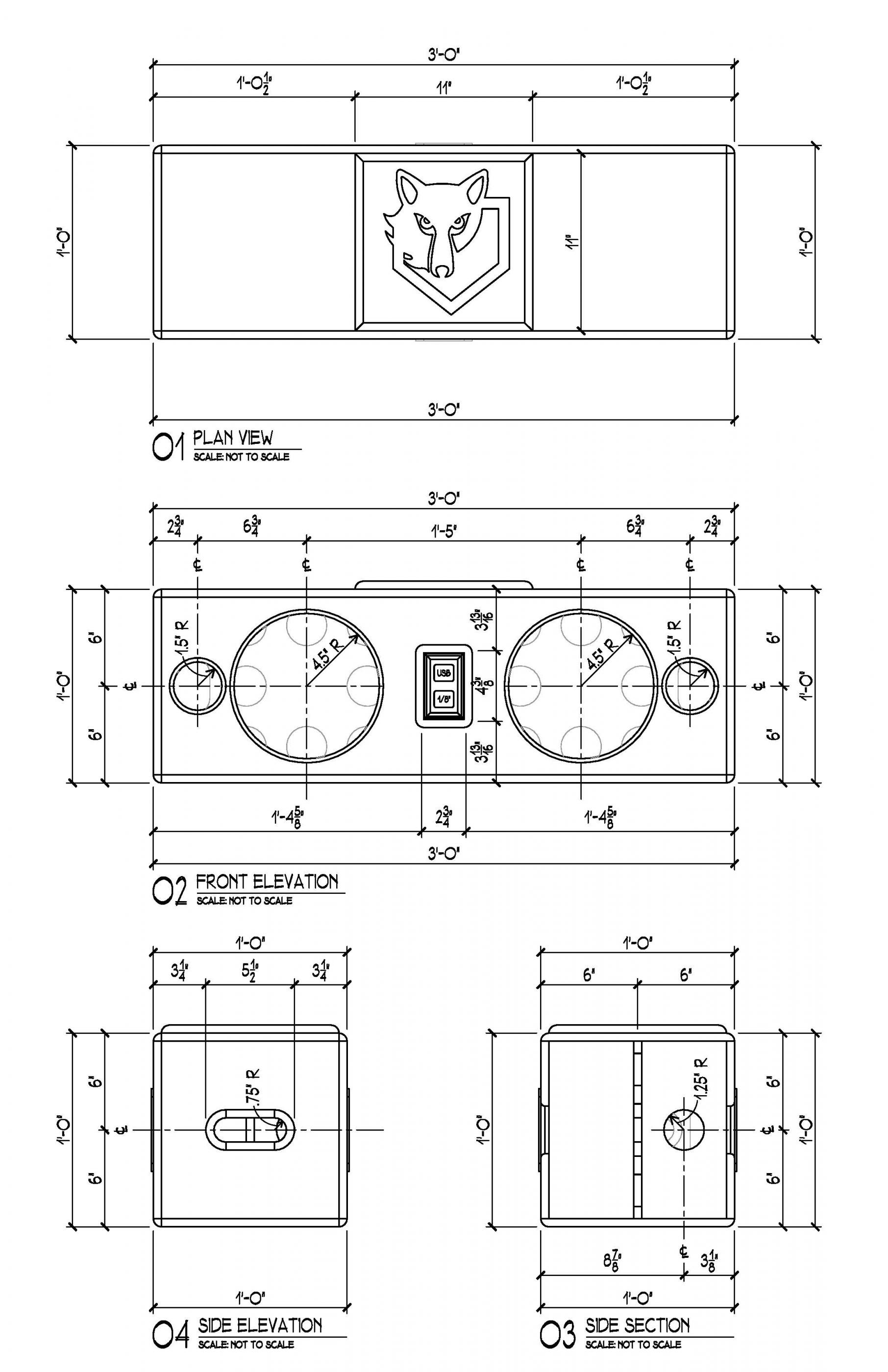

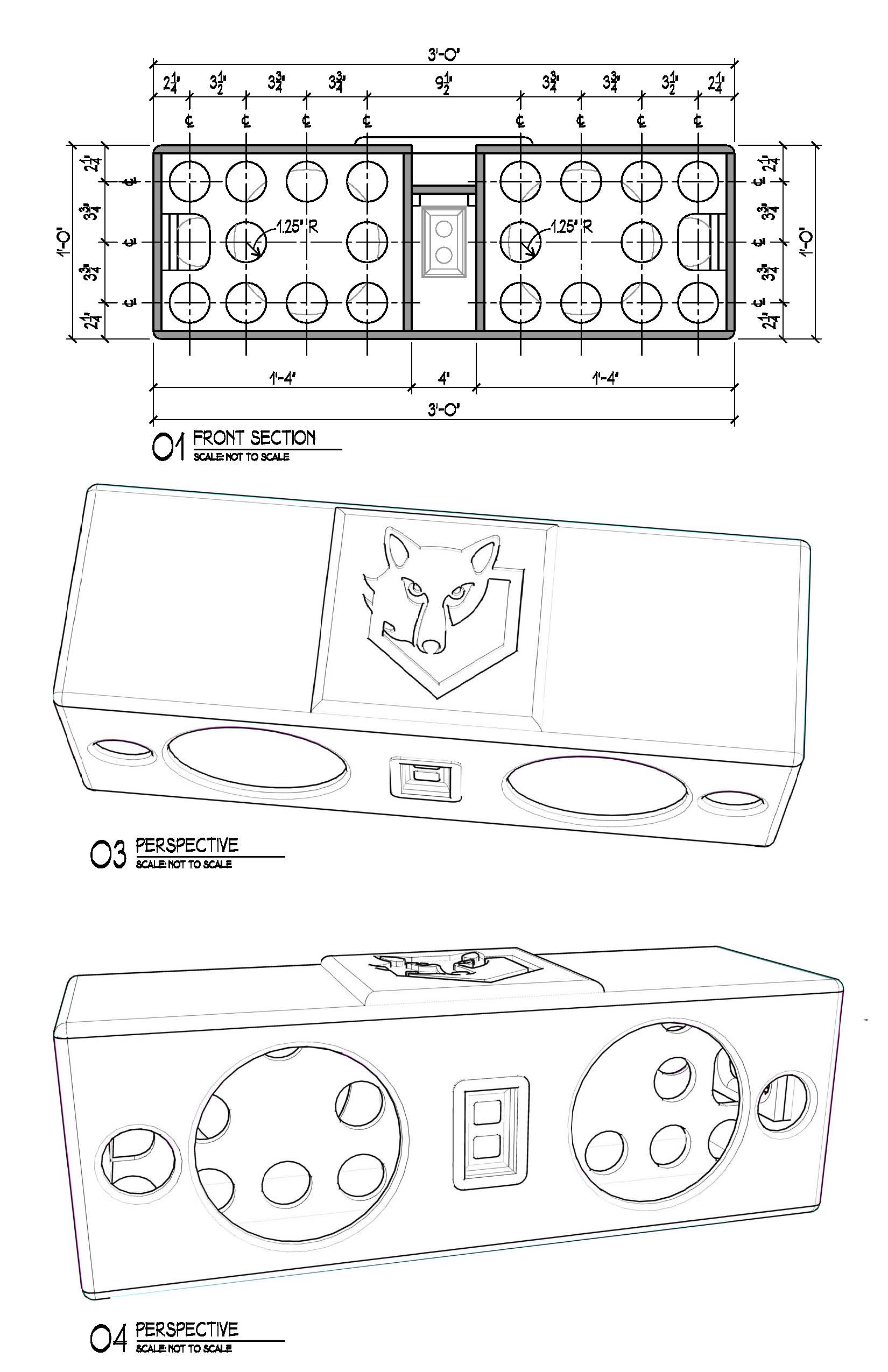

Thanks for all of the help from people in this forum, especially lutkeveld, I think I am ready to start ordering parts. Below is my parts list, construction plans and wiring diagram. I want to get some more eyes on this for one last look-over so please let me know if anyone sees better options for parts, tweaks to design dimensions, or wiring options.
i guess you actually need 2 speakergrills more, cause you have 4 x 10" speakers and only 2 x 10" speakergrills....
