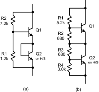

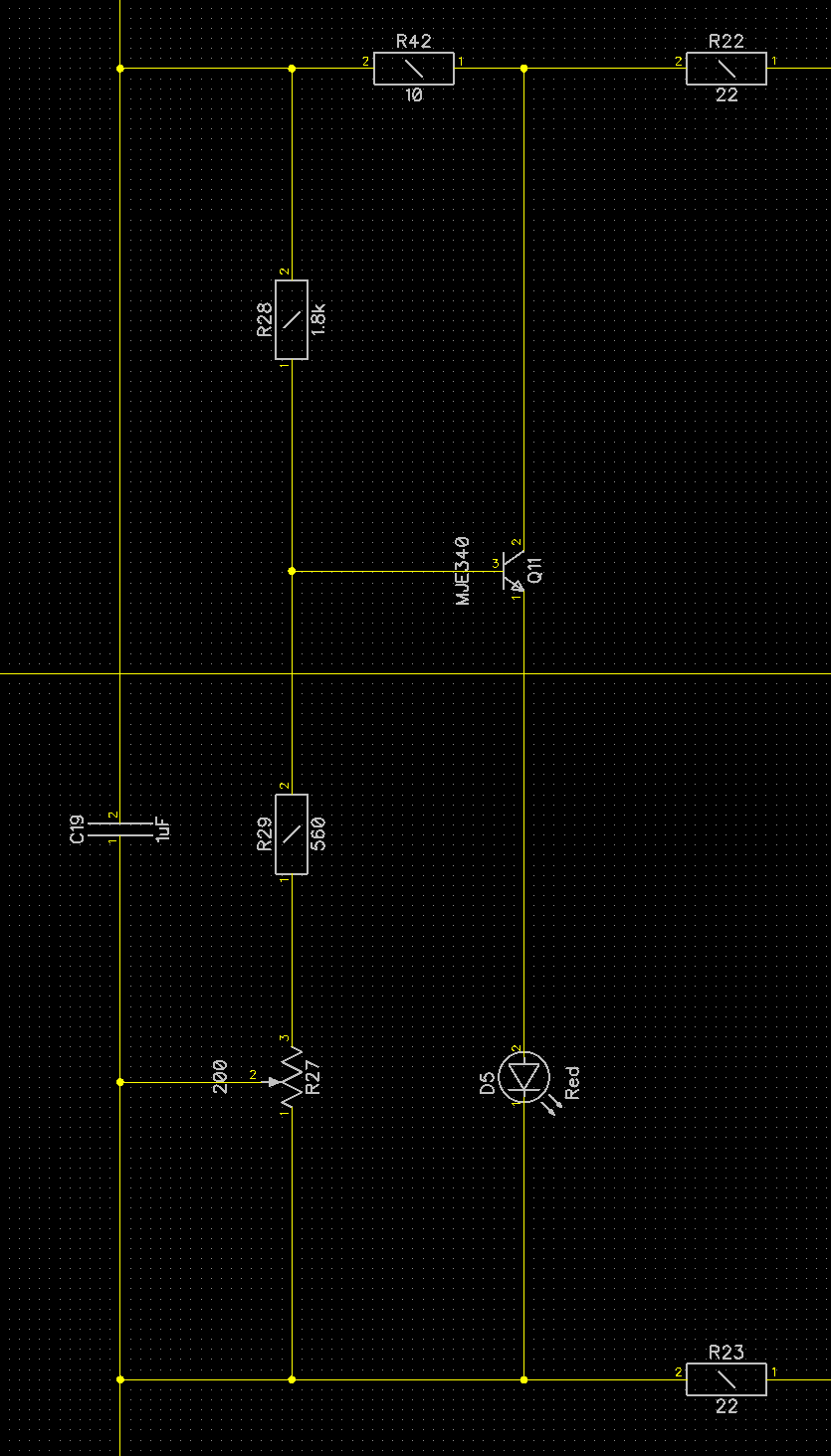

I think a possible weak spot is the Vbe multiplier.
Here is my take on this:
Reactions: STOXX

Adding a second diode-coupled transistor for thermal compensation doesn't seem necessary from what I've seen so far. Mounting Q7 on the same heatsink as the output devices seems to makes it fairly thermally stable. It does briefly spike to about 150-170mA bias current on startup when everything is cold, but after a minute or so, it settles nicely at 100mA. Once the MOSFETs warm up, they seem to have roughly the same tempco as the VBE, since the bias current only varies by about 10% even if I crank up the volume a lot. This is with a proper heat sink fitted. When I ran it with just a piece of sheet metal, it had a very significant negative tempco.

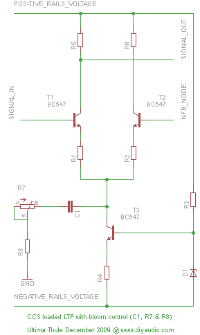

with the resistor 'tail' for the input LTP. And you could vary the length of the tail by using a string of resistors and compare the sound with the capacitor connected at different voltage points.
See here, crazy stuff.. :)
ccs_w_bloom_control_002-png.149388
ps. OStripper tried to simulate it but used a very small cap, C1 (C5 0,1 uF in his schematics), I think it should be much larger, unfortunately I never tried this circuit in reality so I don't know the result.. :(
Reactions: abstract

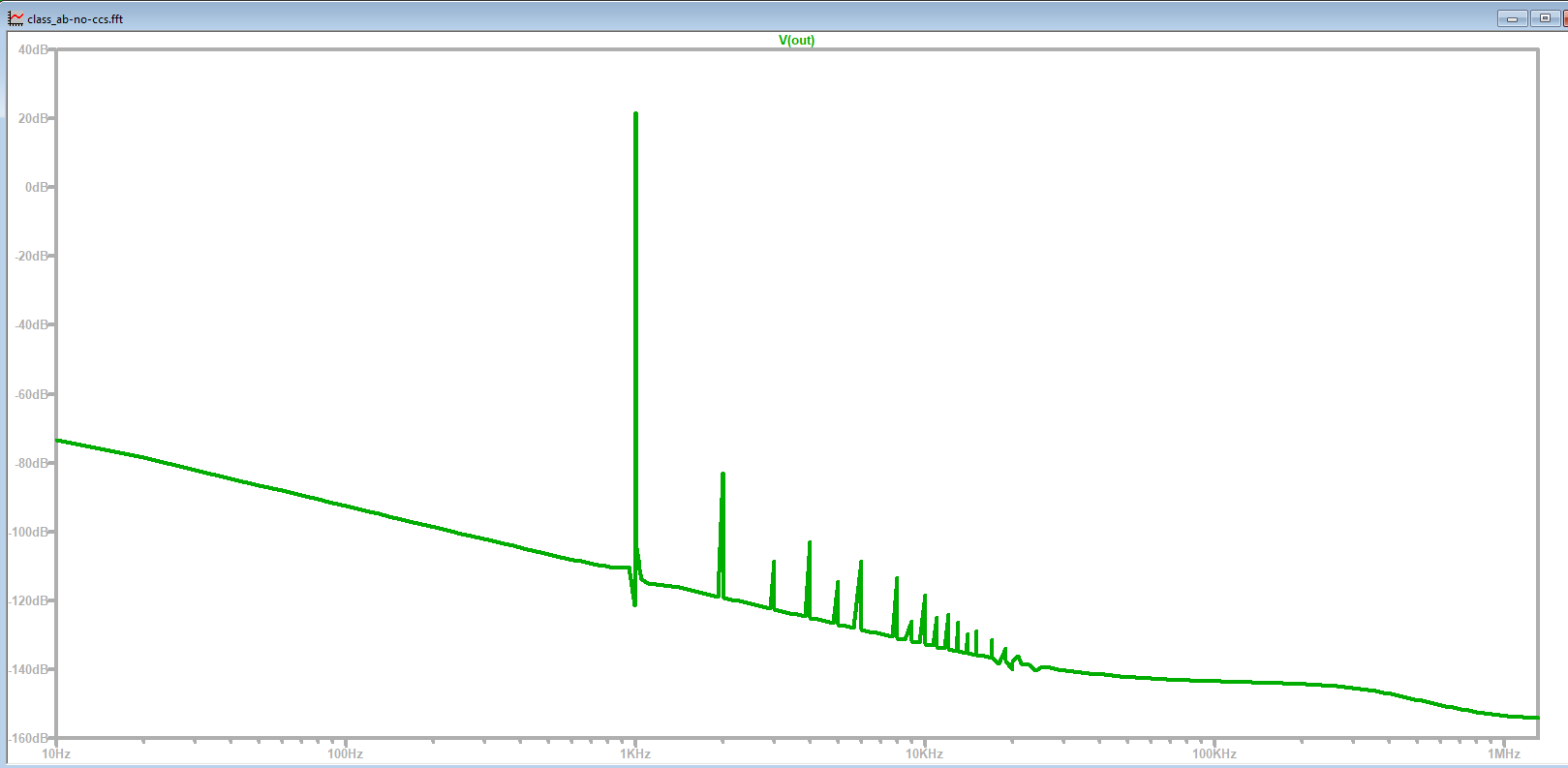

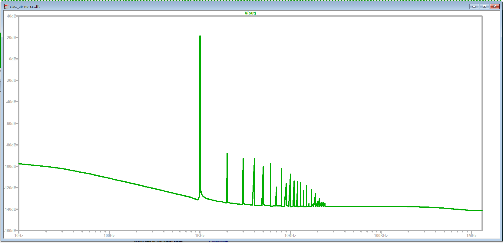

I tried to replace the CCS with a simple resistor for the LTP and got some interesting results. The total THD is about the same, but there's a significant (albeit probably inaudible) difference in H3. It's a fair bit lower without the CCS. The quiescent current through the LTP is about 1.4mA in both cases.
Conventional wisdom seems to be that a CCS improves OLG and therefore helps smoothing out crossover distortion, but I guess there's something else going on here.
