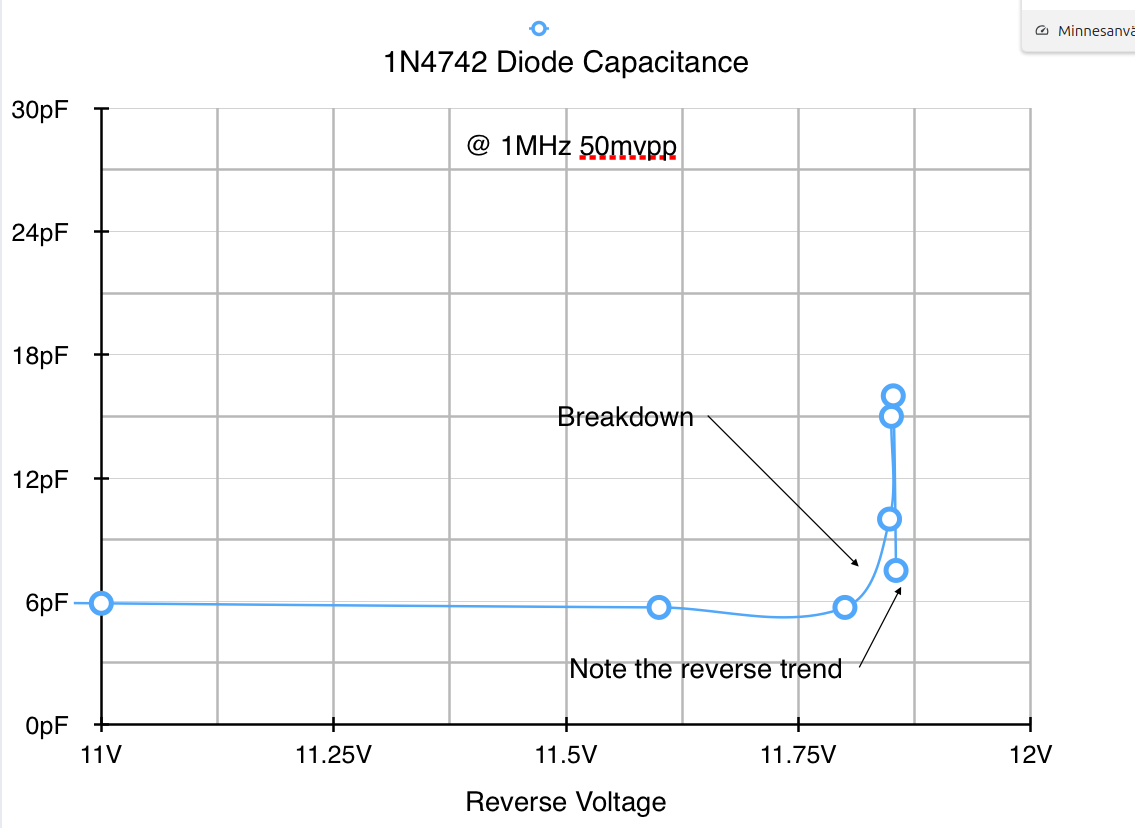

This is not necessarily. Zener diode series with switching diode is pretty much industrial standard. Hafler Lateral MOSFET amps all use this practice without issues.
Switching diodes have less junction capacitance comparing to Zener. Thus, it has less load on the gate signal.
Reactions: njswede
Compare the capacitance of the zener with the 1660pF input capacitance of the transistor.
Here is the capacitance of another zener diode. It could be more or less for the one used in this circuit.

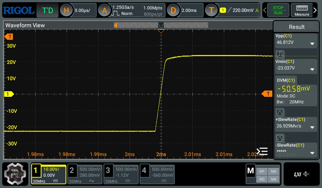

input filter is 10MHz ! - that serves no purpose - re-check slew with a proper filter

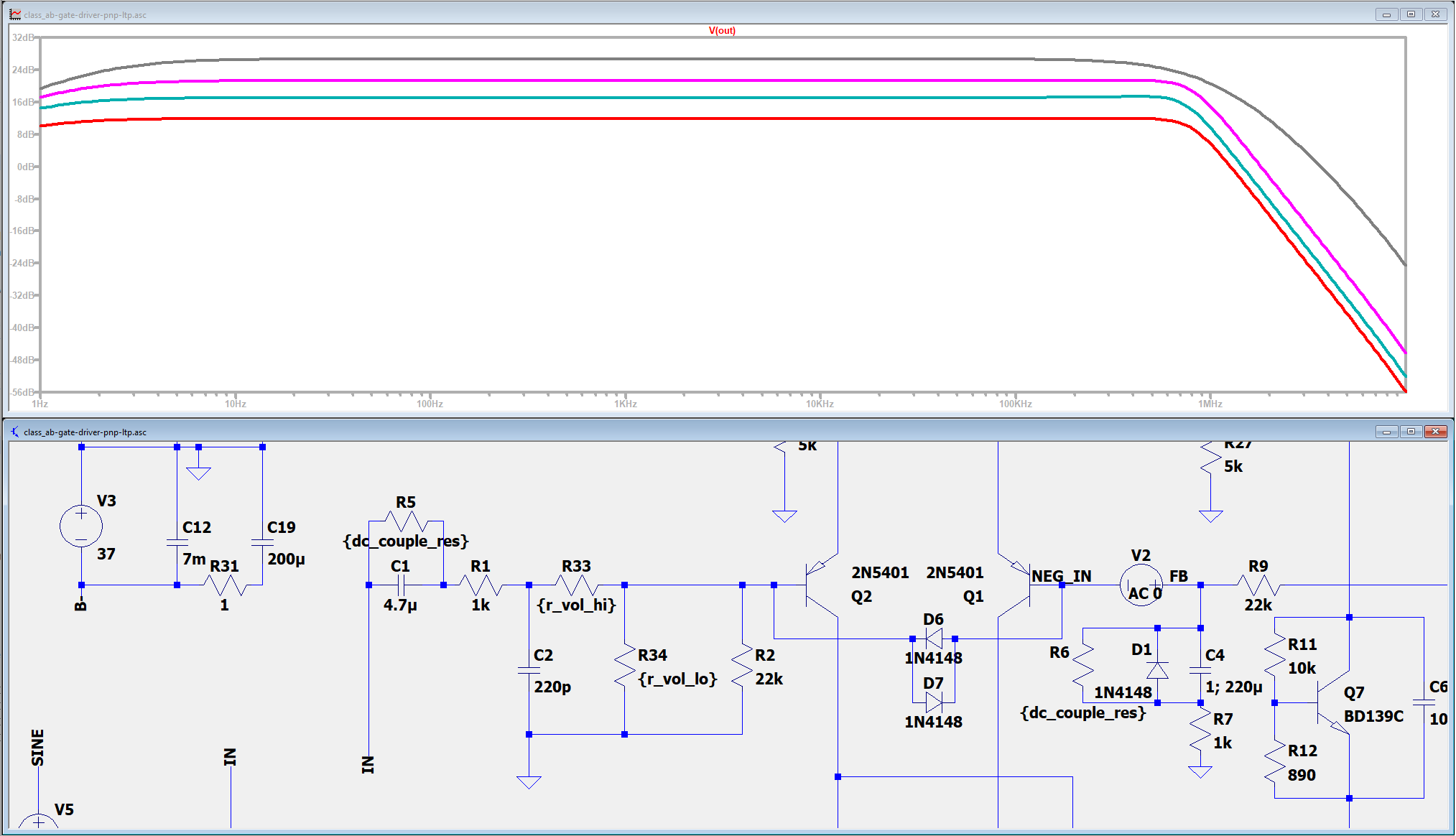

The output impedance of the signal source is unknown. It could be a volume pot. That position is not good for input filtering. However, the RC network is still beneficial. It keeps the input capacitive. A capacitive input has less chance to oscillate than an inductive source.
You're absolutely correct and this is something I should have addressed. The way my amp is set up right now causes the frequency response to vary with volume. It's well above audible range, but it's bad practice nonetheless.
I redesigned it and placed the pot after the filter. This is what I get with a 50k pot for 25%, 50%, 75% and 100%. The PCB will have connectors for the pot and if you don't need it, you just short it out.

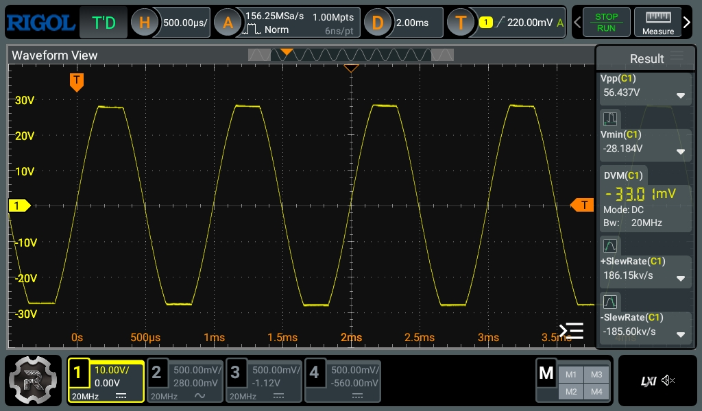

re-check clipping at 10KHz
I've installed it and hooked it up to speakers, so I can't test it right now. But it clips perfectly fine at 10kHz in the simulation, which has proven to be almost scary similar to the physical build, so I have no reason to believe it would have a problem at 10kHz. I'll test it next time I'm messing with the amp!
I changed that cap to 220pF when I built it but forgot to update the schematic, so it's 5MHz. I also redesigned the whole input section as shown above.

Q2's base current flows into the wiper of the potmeter, so when the contact resistance varies when you change the volume setting, it won't just modulate the signal but also cause cracking noises during silence. It's better than direct current out of the wiper, which can cause anodization of the wiper of a carbon potmeter according to an application note I read long ago, but still, I'd reserve space for an AC coupling capacitor between the wiper and R2.
