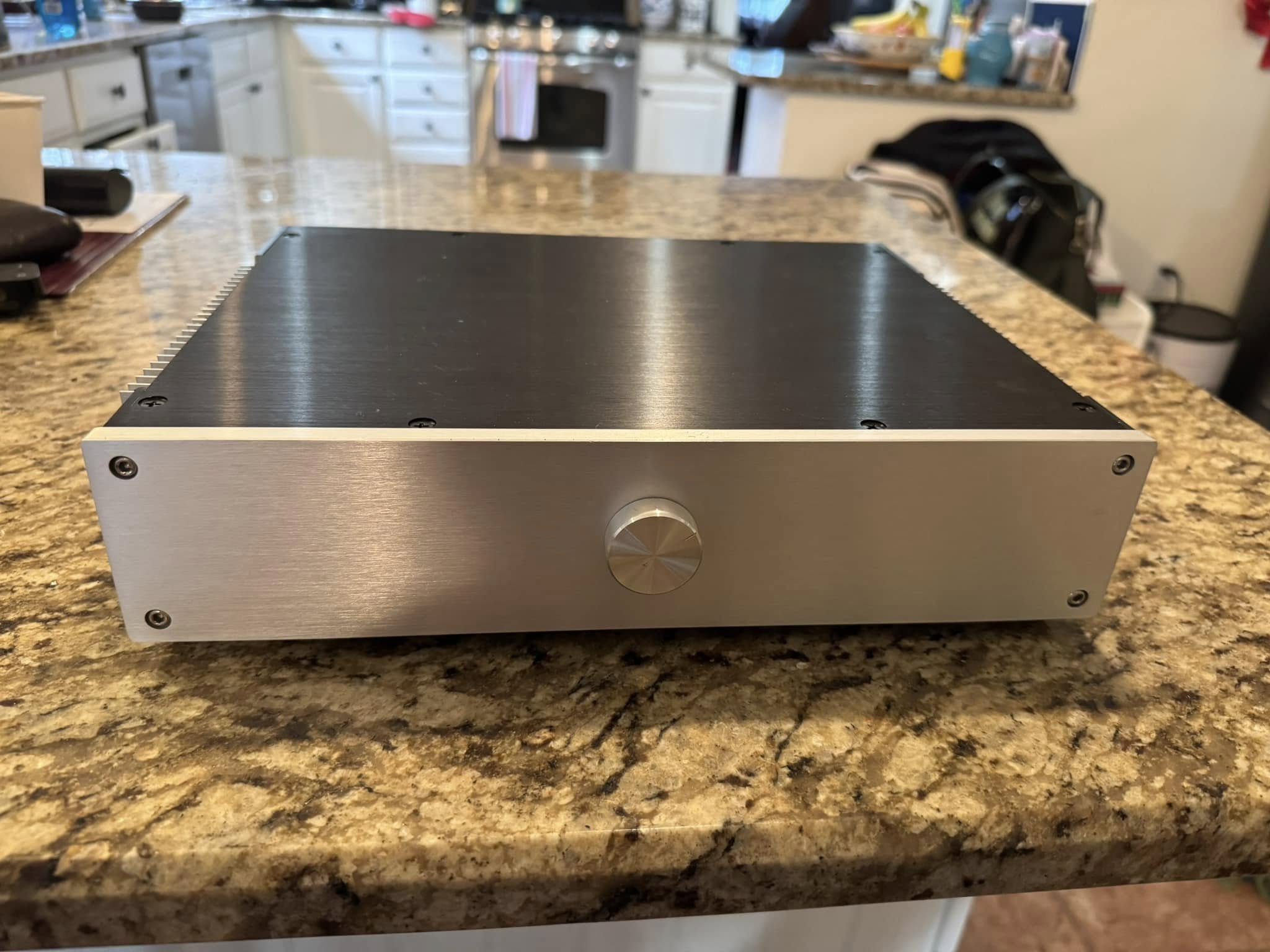

I should get a case for it this week so we can check out the final result. I'm very pleased with what I'm seeing and HEARING so far.

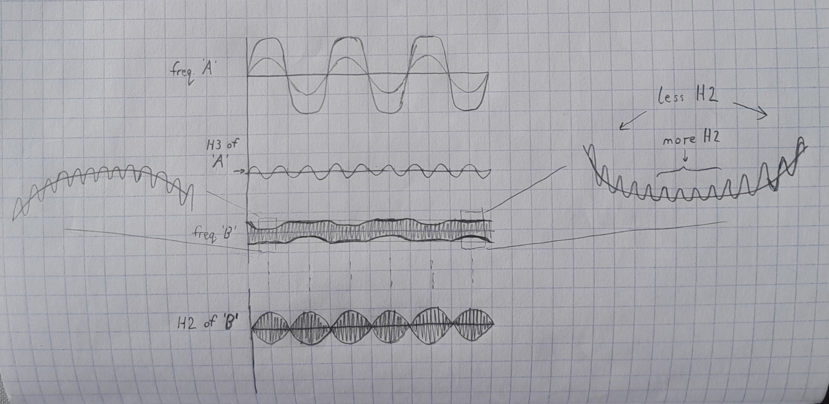

I've finally gotten round to drawing a diagram....
Top:
Distortion of low frequency A is exaggerated for visibility.
Below that is what I call harmonic number 3. So I'm going with the convention that the fundamental starts at 1, not 0.
Below that is the envelope of a higher frequency, B, which is starting to get modulated. As A approaches clipping, B's gain goes down, but it's asymmetric: one half cycle gets squished as it tries to clip harder, while the other half returns closer to centre.
So if we look at the harmonic content of B, over time, we can see H2 undulating up and down in amplitude.
Obviously the total amplitude of B is getting modulated by maybe 3dB (and in normal usage, far less). However, the harmonics of B are heavily modulated: you basically get a divide-by-zero error when calculating the dynamic range of the H2 "ringing".
So this all ties in with adding a small amount of H2 at the input stage, to make the amplitude more stable. What that should do is shift the balance point, so H2 no longer goes to zero at 0Vout, but gets offset by some amount, similar to crossover distortion.

Looking at the mechanism of distortion in relation to the transfer function that created it ultimately helps to understand the basics to interpret the frequency spectra existing in the frequency domain. It's a good exercise.

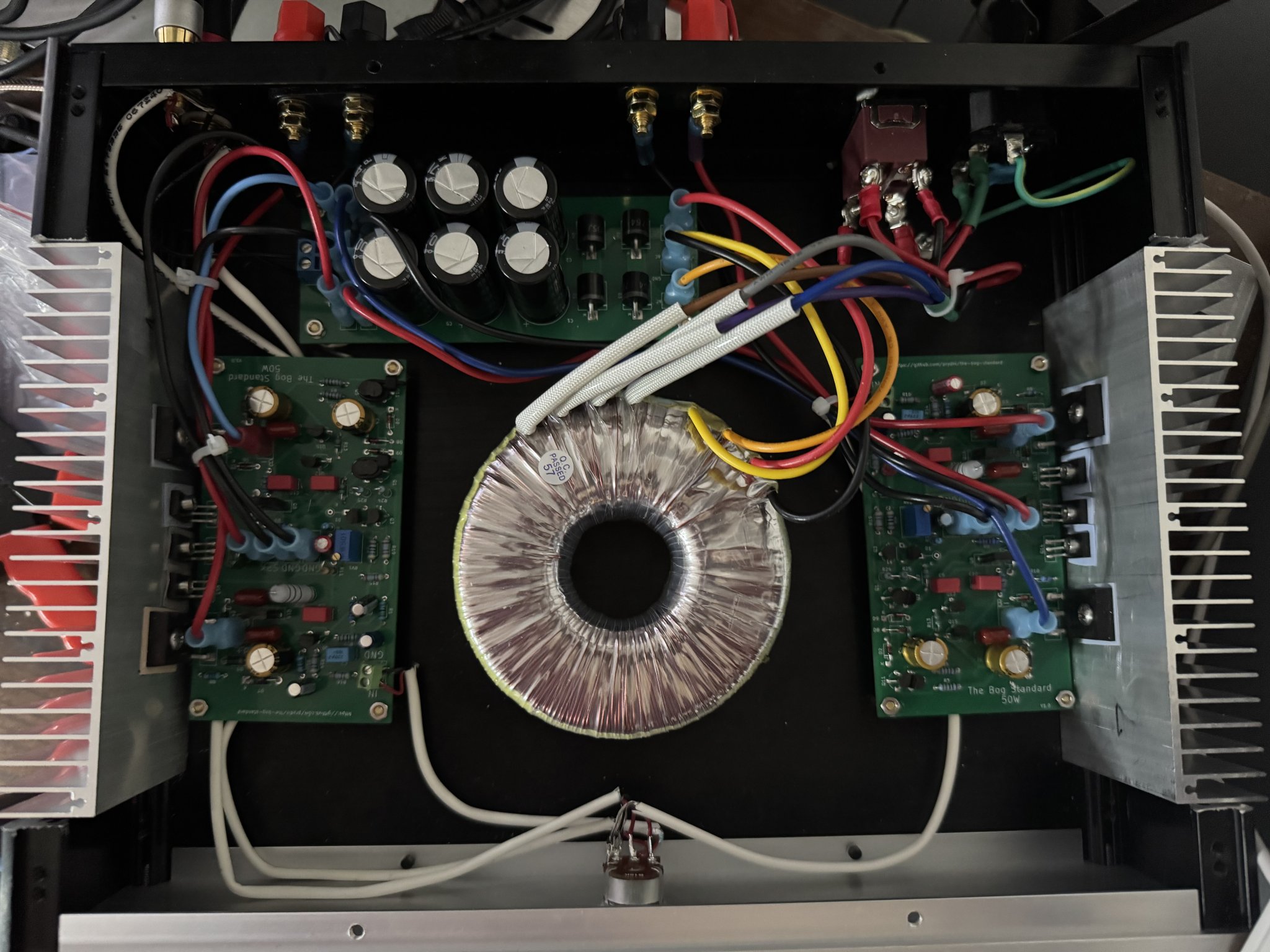

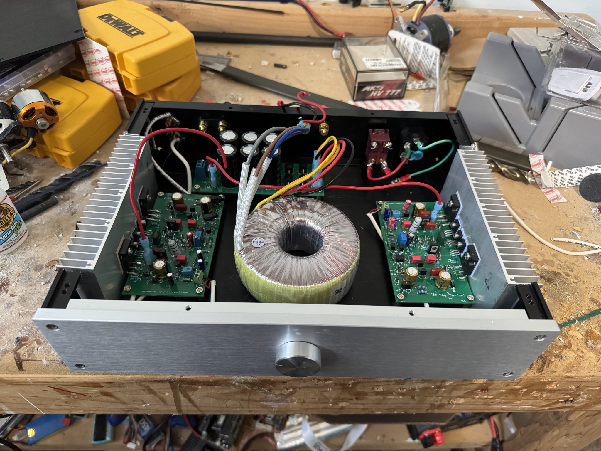

It works really well so far. The only issue is that the BD139 /140 pair in the VAS get really hot. I think they're dissipating about 500mW, so I should have put them on a heatsink. I might reduce the current a little bit or see if I can squeeze in a little heatsink.
THD is 0.005%, which is at the limit of what my soundcard can measure.
I had to make some compromises to fit everything in this small case, but there’s no audible hum, so it can’t be that terrible.

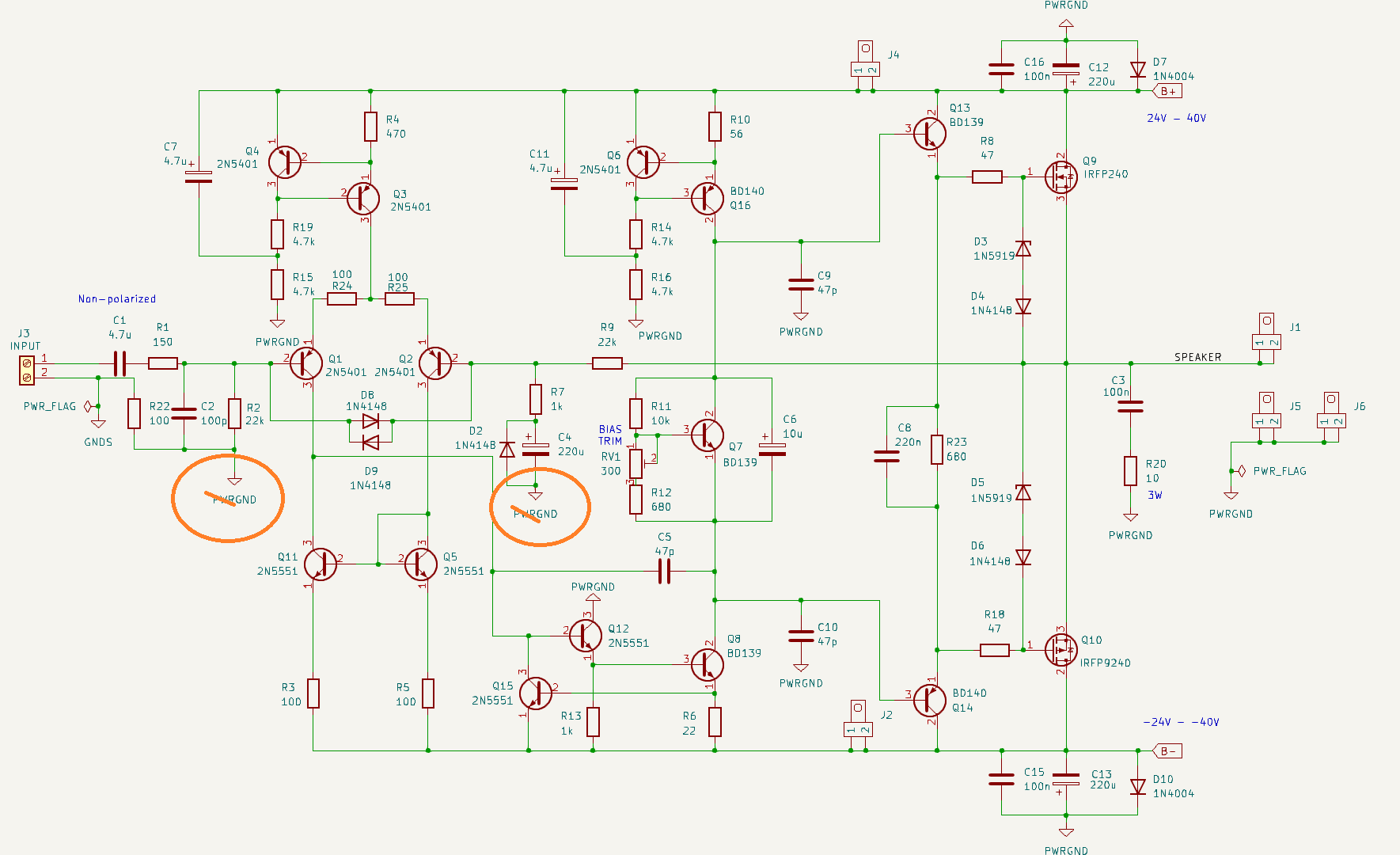

It's been heavily modified since then. 500mA through a BD139/140 without a heatsink SHOULD be OK, but it feels pretty hot. Not like burning my finger to a crisp hot, but unpleasant to touch for an extended period of time. I might just find a little piece of sheet metal to attach to it to get some more surface area to dissipate the heat. Latest version of the schematic below. And a minor correction: They should be dissipating about 400mW.
Reactions: jxdking
They are fine. They are rated 1.25W naked. You got 3x times headroom.

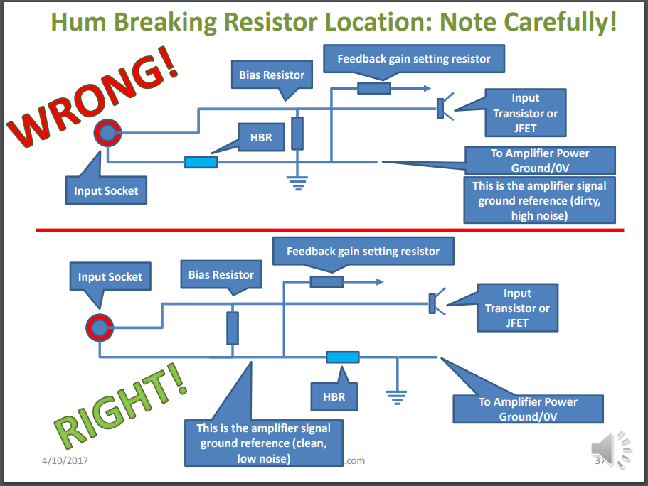

One suggestion, to reject hum properly, these 2 grounds marked below should be the signal ground, not the power ground. The input jack should be isolated from the chassis. Bridge 2 grounds with a 10 Ohm resistor on the amp board.

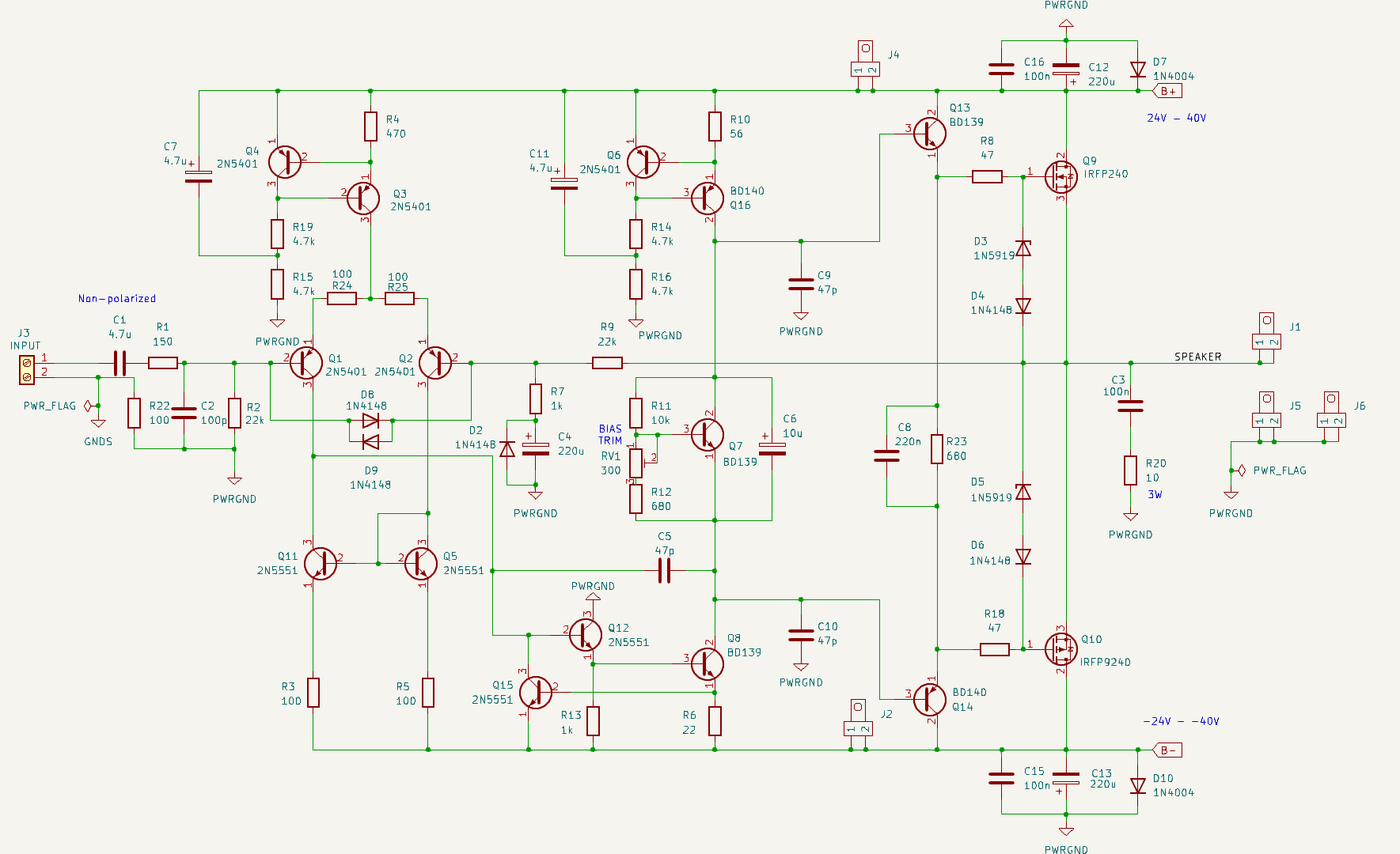

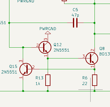

LOL! I let the magic smoke out. Can anyone see my mistake? This is my VAS. There's about 11mA through it (not even sure that's relevant). I tested driving the amplifier into clipping (using the drum beats from Blue Monday, what else?) and something popped. I haven't torn it apart yet, but I'm fairly sure what the problem is... Who's the first to spot it? 🙂
