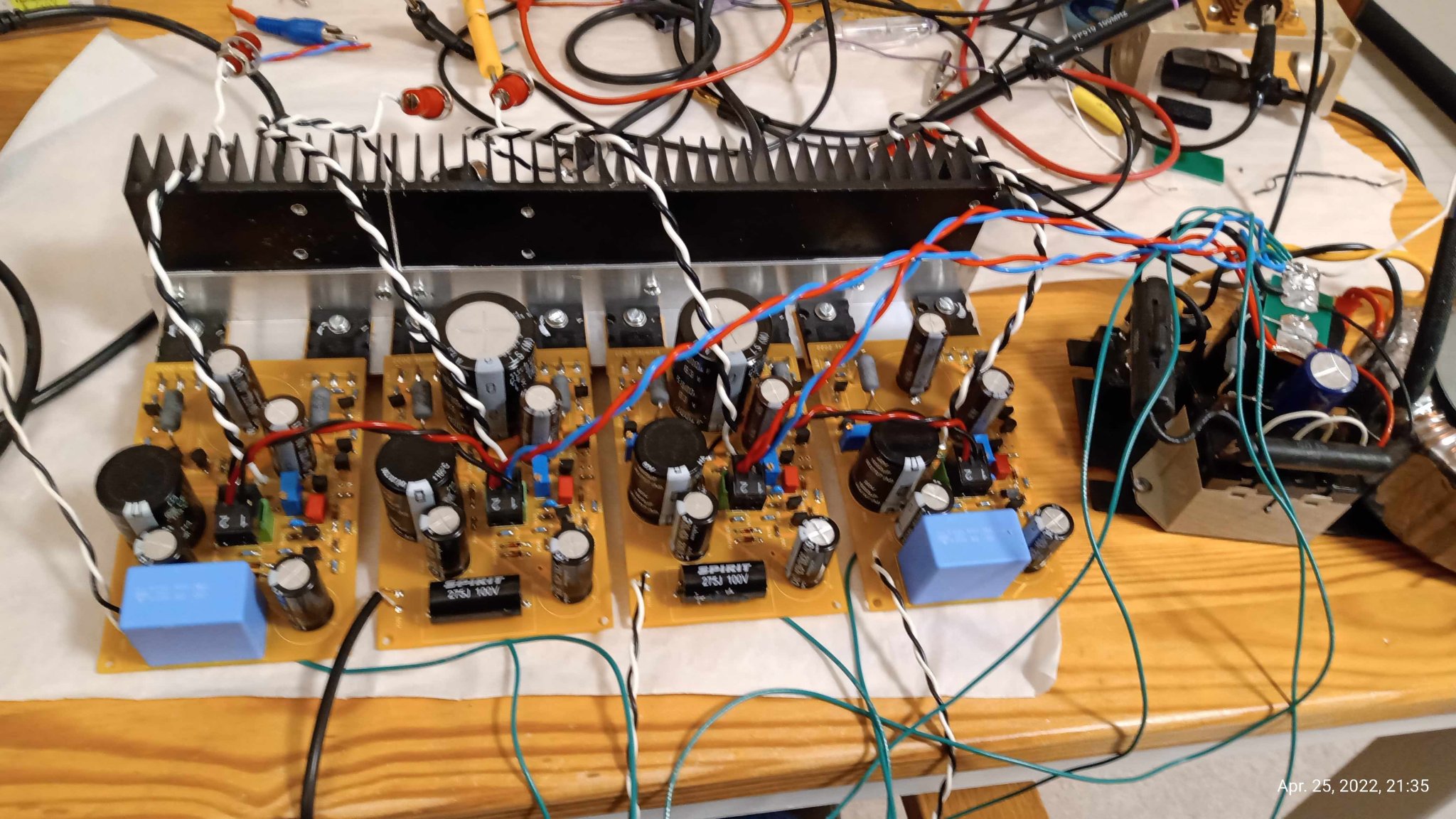

My 4 channels are ready and stable. I think I'll leave them as is for now and in the next few days will post my updated schematic. My goal was just to try the amp, but also to modify a little for 4-ohm load capability. Looks OK to me. The 2A set by Blomley is not enough to drive 4-ohm speakers when close to full voltage swing.

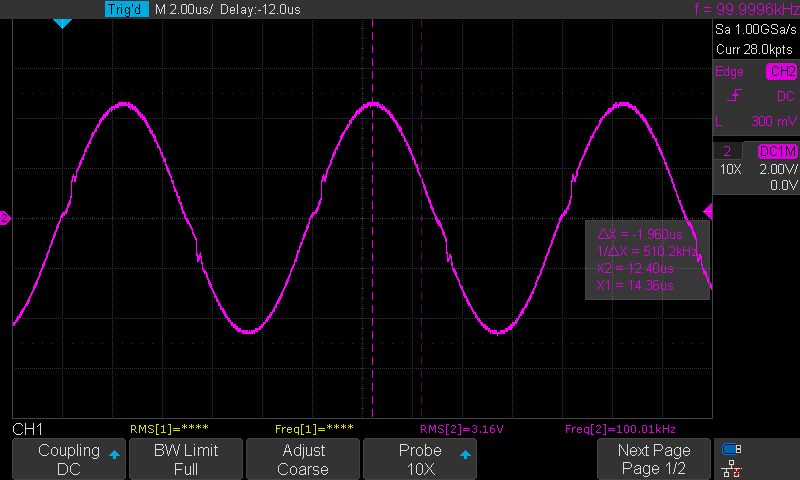

The 20kHz performance is not bad in the real amp. But if you try 100kHz, the trimmers would be to a much higher current than 38mA. I find that some 80mA make the 100kHz performance better. Interesting that setting the trimers depends also on the power level. Adjusting at, say, 15W requires more DC current to remove the crossover distortion than adjusting at 1W output power. Must be something related to dynamic parasitic effects... Interesting schematic, no doubt. I like dissecting its performance.
There are two main issues:
- the inputs cannot be left floating
- the start-up mess.

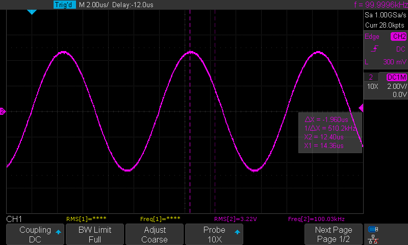

For future builders I attach 2 snapshots showing the crossover distortion at 100kHz/3Vrms/4ohm load. One is with no DC current and the second is with about 80mA.

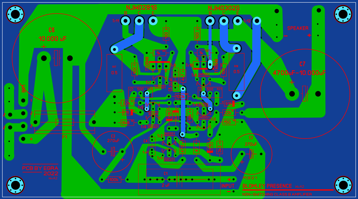

I have been looking at the beautiful printed circuit board that EGRA has develloped. It is a very compact design, but I saw some points of improvement. First of all I would like an option to choose differtent types of input capacitors, so provision is made for MKP capacitors with a 27,5 mm pitch. In the past, my Linsley-Hood Class A amp performed better with a high quality input capacitor. Furthermore the printed circuit track from the 33pF capacitor ( C5) should be as short as possible. So I changed the layout to accomodate a shorter track. Eventually the input of the amplifier and the output were quite close to each other, so the loudspeaker connectors now are located next to the power transistors. Finally I thickened the printerd cicuit tracks as much as possible and groundplanes are present on the top and bottom layer; these grondplanes need to be earthed by the user. If anyone has comments, please let me know
- Hi Willem , I like your PCB/ Amplifier ideas!
- I have been interested in this amplifier having read some of the articles about it over the years. At one point I was even emailing back and forth with a fellow named Ken who had a website about the Blomley Amplifier called Thundernerd - he was going to build the amp and sell PCBs to others who were interested in the Amp... but after a while of sending emails back and forth he stop emailing me back -- I think he is okay because His website is still up, maybe he just got busy with life....
- So I was wondering if there was any posibility that you might have a few extra PCBs made up that I could buy from you?
- Thank you,
- Best regards, Dean
Hi Dean, first of all I want to test this version of the pcb, to make sure it is correct. If so, I am willing to share the Gerber and Excellon files, needed to manufacture the pcb's. But If you are interested in these files for now, I can share them, no problem.

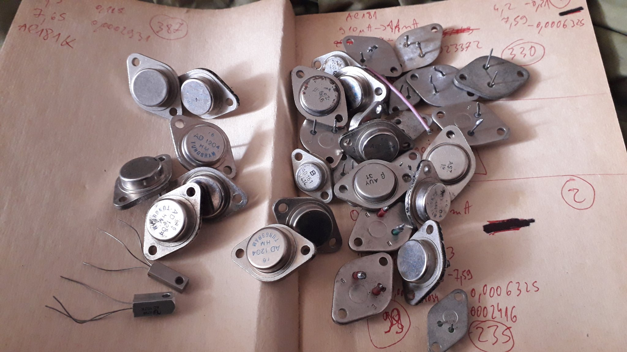

Hi Hallon83; I am a newby also, in relation to letting pcb's be made somewhere on the other end of the world. I used to make them myself with all kinds of chemicals. Regarding the pcb I have ordered a small batch (5 pcs) of a preliminary version. Then I was not satisfied and made other changes to the pcb. If this new version is OK, I will order for some more pcb's, but that will take several weeks as I am very busy at the moment.
2. Diode OA47 replaced by BAT46 low drop Schottky for obvious reasons of "unobtainium".
Thankfully I have a 2L (~ half gallon) plastic ice cream container full of stuff that I've saved since the 60's and I'm sure there will be the odd OA47 in there. However, you could also consider using a germanium transistor as a diode here.

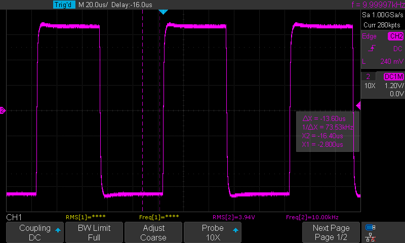

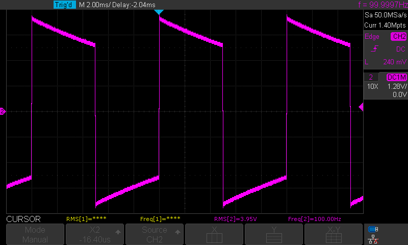

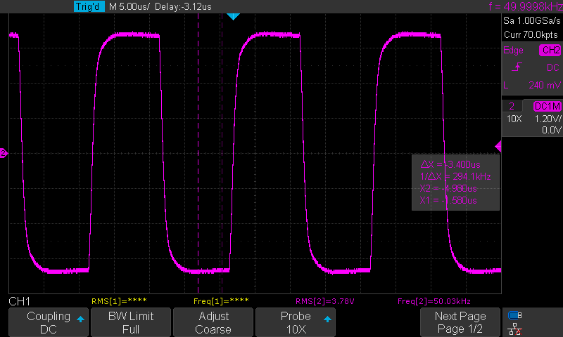

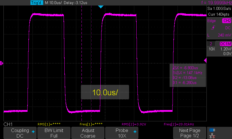

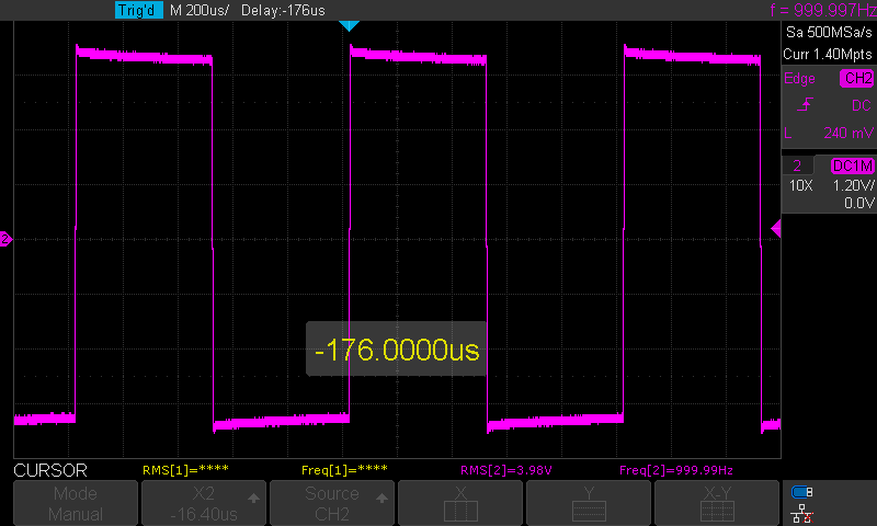

OK, this is my final schematic. I consider this project finished. It’s time to put it in a box.
I uploaded the square wave response at several frequencies.
There are few small changes from the original, visible in the schematic. I made them mostly with the idea to drive better 4 ohm loads and to improve stability (which was not great with 1/2 closed loop gain than the original). The amp had a tendency to oscillate badly without load and/or without connected inputs. With the input RC circuit and the output Zobel I have pretty stable behaviour even with floating inputs and no load.
Another issue was hum. That required to split the input ground from the output/supply return. I did it as you’ll see in the schematic, which was the easy way for me. You can find better way to do it. Just be prepared that you’ll need it. Also some tests with different grounding arrangements will be necessary. This is not a quiet circuit!
Next issue was horrible start-up bang. Really scary and with expensive speakers not recommended. Actually, with any speakers is a bad, bad idea! I added slow start resistor/relay on the power supply... Slightly better, but issue was not solved. Unfortunately, this amp needs mandatory delay protection at the output to the speakers. Partially the issue is the DC bias of the input capacitor. Capacitors with DC bias are problem in audio and make the inputs extremely sensitive and ready to discharge where they are not supposed to. The RC circuit that I implemented tamed that at the expense of some input impedance drop.
Clipping behaviour is not very good. The circuit tends “to stick” into clipping. It doesn’t leave it unless the signal drops significantly. This is another good reason to protect your speakers or to play with the proposed circuit for soft clipping somewhere in this thread. I haven't try it, but it’s not bad to include it.
