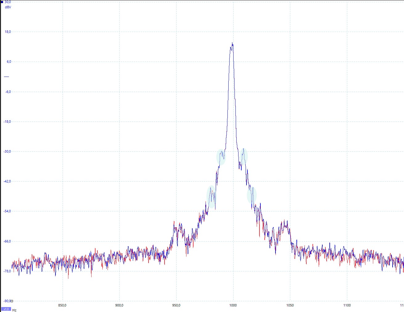

This well known effect called "scrubbing", happens at the Cart's Fres and causes intermodulation distortion.Very nice. Thanks Hans
Have you considered that the cutter head is a tangential acting device and that cartridges operate as an arc from their fulcrum. This suggests time/phase shifting variations dependant upon the cantilever length and physical sideways displacement. In other words it seems the contact point moves forward in time on the vinyl on an arc from the time at the centre zero position. Don't know how much of an issue this can be, although this suggests a longer cantilever to diminish this effect. I never liked the Dynavector Ruby 23R much. It had a suspiciously short cantilever.
See attachment below, where the blue blobs are showing +/- 10Hz and +/-20Hz IM products when playing a 1Khz test tone with a cart having its Fres at 10Hz.

I don’t see any problem in the movement in the transversal direction other than a small error in the tracking angle
I find it hard to believe that this can produce any measurable IM or change the generators gain.
The scrubbing on the other hand takes place over a much larger distance creating pitch changes with corresponding measurable IM product.
But it's probably better to look at the combined IM products, you want to keep them as low as possible, whether from longitudinal or transversal movement.
An Fres between 10Hz and 13Hz is seen as an optimum. Lower and the IM products increase.
Hans

Thinking again, I realised that the shape if a waveform may become slightly distorted because of the differing movement between cutter and cantilever, but not the pitch.
And symmetric waveform distortion leads to uneven harmonics but not to IMD.
So all IMD must be generated by scuffing and speed variations in the record because of excentricity imperfections.
Hans
