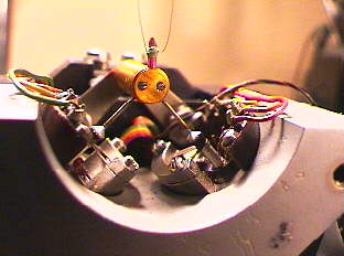

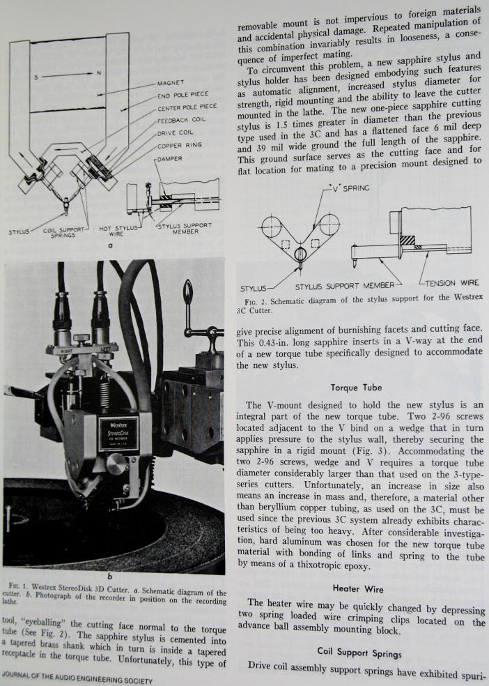

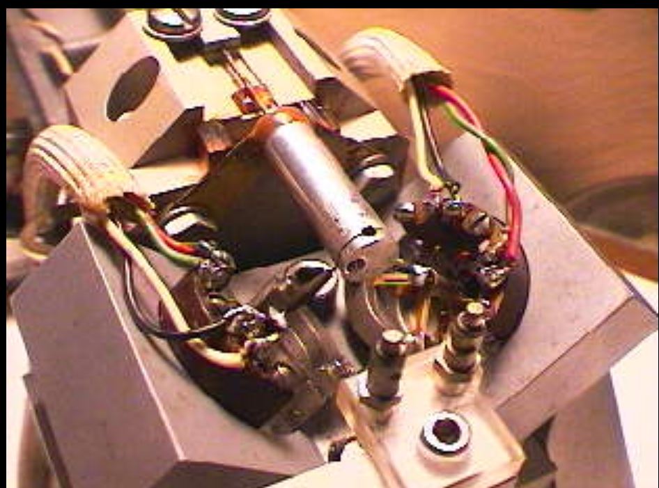

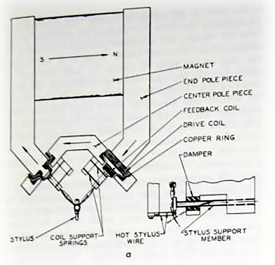

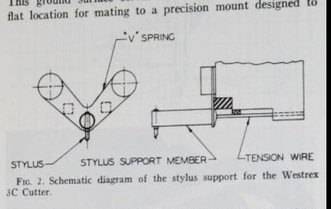

It is simply a thought experiment Bodyslam. I didn't know about the "torque tube" in cutter heads. Thanks. To further this thinking a little further. Are you aware if the torque tube is pivoted in line with the groove, or at a tangent to the groove. In order to neutralize(?) the affect requires a torque tube with equal length to the cartridge and with an axis along the groove line, being also pivoted on the same side as the cartridge. I don't really care about things I can't do anything about Bodyslam, just some general principles that might help in some DIY way. Yet thanks.
Here's some info on cutter head/torque tube/stylus support member. Possibly From Narma & Anderson, 1959(?) https://www.aes.org/publications/anthologies/downloads/jaes_disk-anthology-1.pdf
See also https://www.lathetrolls.com/viewtopic.php?t=796 for more from AES archives.

Yes Thx Dagfinn. Look at all those tubes!... how can all (please excuse the language) this **** work it looks so crude?
Expanding on thoughts of arcing of the stylus shank leaves me to think about a cutter head mimicking a 9" pivoted "standard" tonearm. In other words pivot the cutter head assembly at 9". This seems would fix up all those tracking angle errors. The hell with those tangential trackers and 12" tonearms.

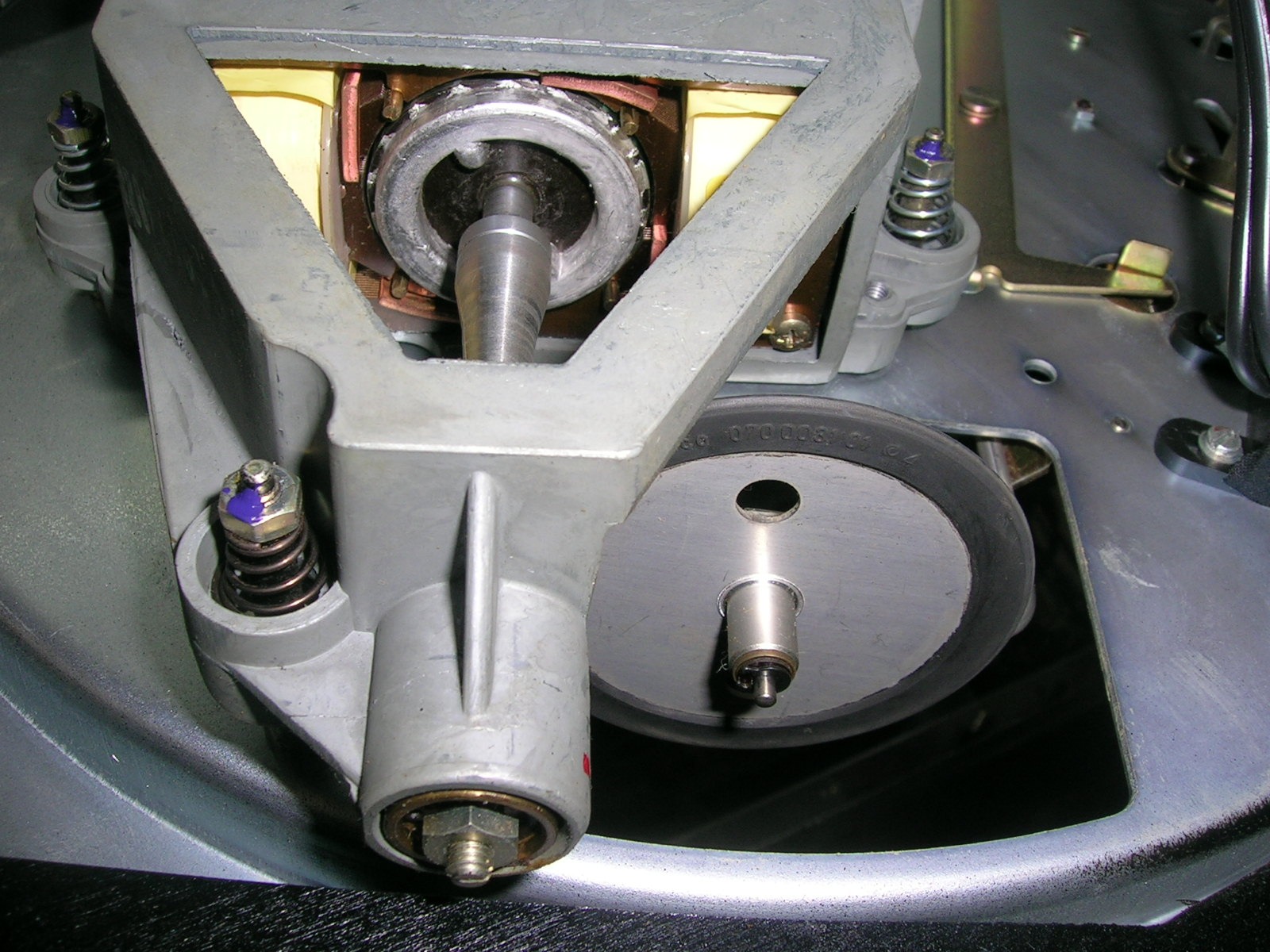

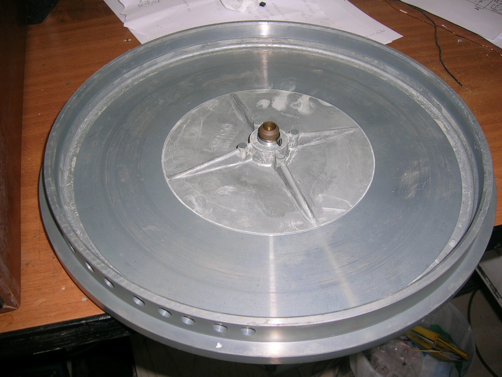

You find me in agreement, the gyro effect included.
Only Lenco idlers, from the L78 and older had their idle wheel touching not the inner perimeter but the inner horizontal surface of the platter. It didn't cause side thrust but it could cause wobling, spindle bearing condition permitting.

Nice photo's. There is a distinction between mechanical wobbling from poor mechanics and wobbling from a gyro effect.
A vertically contacting idler may be the best, as the horizontal contact can provide a vertical force upward in direct opposition to the downward force of the stylus. Having two points of contact between the moving mass and the stationary mass creates two moments around those contact points. Depending on the stylus contact in relation to the line between the contact points on the platter this can substantively reduce the gyro effect. There still remains a tipping moment where the contact of stylus isn't along the line between the pivotal points of the two platter supports.

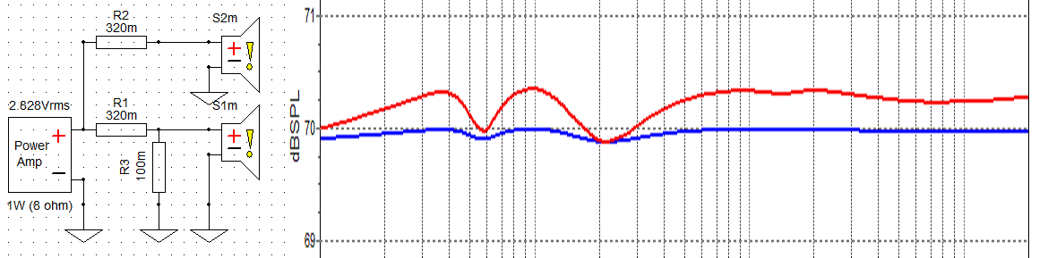

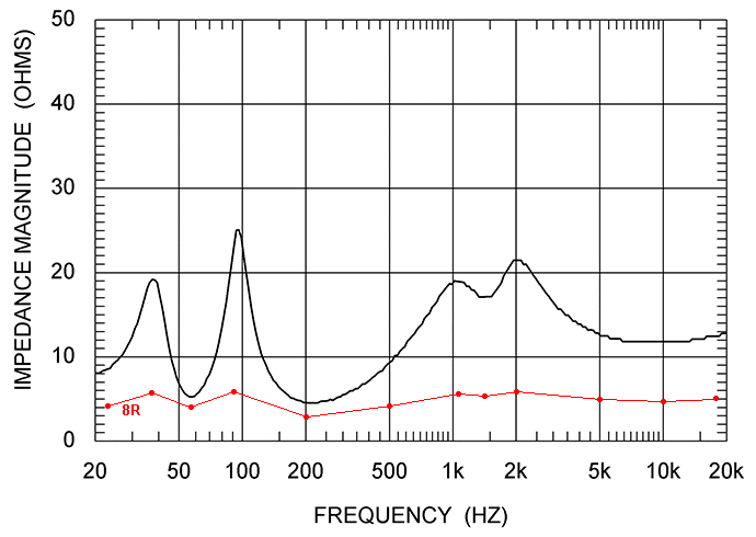

I took the impedance plot of the Revel speaker that you have mentioned..
let us use Isaac's Revel M126Be speaker (the Z above) and not a single P17WJ-00-08 driver. Make the resistor 0.1R which is 80 times lower than nominal 8 Ohm of the speaker. Now the amplifier would hardly see the speaker at all,
Then I simulated it with my 320mΩ output impedance, with and without your 0.1Ω resistor in parallel (levels adjusted).
It's clear that the response has the potential to be affected enough that it could become audible. Certainly at the amounts suggested below, it would be.
