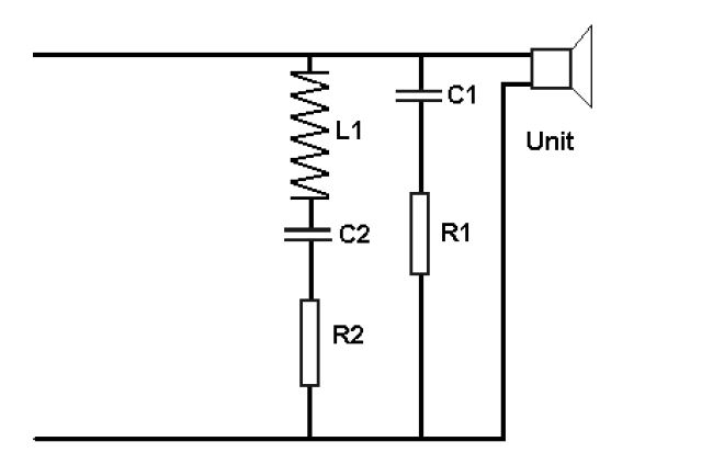

You might equalise the impedance of a loudspeaker:
591332d1484052292-flat-impedance-flat-power-response-design-steen-duelund-simple-zobel-plus-lcr-jpg
And you can play with parallelling series first filters as we often do:
591255d1484013729-flat-impedance-flat-power-response-design-flat-impedance-circuit-png
Or shunt first filters in series:
591258d1484013729-flat-impedance-flat-power-response-design-flat-impedance-series-filter-circuit-png
Both around 8 ohms flat except for the bass Fs peak which is expensive to fix. They end up looking identical on response!
Flat Impedance and Flat Power response design.

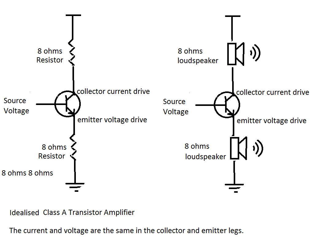

Thought experiment I did was to imagine a very idealised Class A amplifier. The top loudspeaker gets current drive, the bottom one voltage drive. They end up in the same place to me! 😀

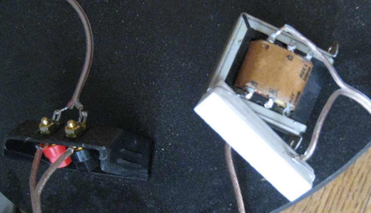

Well...I did it and The Sound is pretty marvelous. Nothing I'd "kick out of bed" anytime soon! It was pretty good before I did this, I might note. Unsure if I dare say it's better, but it's definitely no worse as far as I can tell. The foot taps...
Could someone please explain "how it works"? I used an 8 Ohm non-inductive in series with the 8 Ohm tap; which is supposedly 0.7 Ohms looking into it with my 8 Ohm Pluvias connected to the 90 Ohm secondary tap.
I'm 3 clicks down from WFO on the amp volume to get to a pleasant listening level. The directly connected 4 ohm driver H frames are ~15 db below the 8 ohm FR drive level, to get near balanced and maybe can go lower still. Lucky for me I dont enjoy listening loudly - I'd need a new amp. It's stretched to where I cant compensate for different modulation levels across media.
I did the "Clean-Current Full-Range Speaker CCS-7", but without all the EQ parts - just the transformer. I used a different transformer as well, with an 8 to 90 ohm primary to secondary. Idea courtesy of Esa Merilainan (sorry I dont know how to code the umlaut; alt+0228 doesnt work for me)
