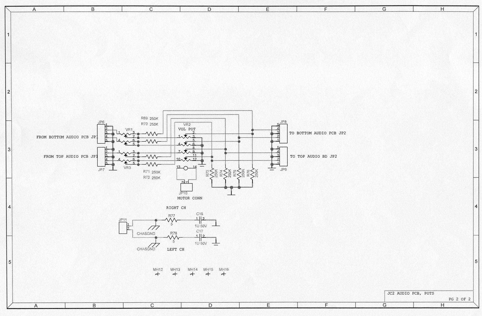

Please bear with me, the schematics from the past show a 10K volume control pot. The situation without any more knowledge would be that to get pass through operation at 4V you turn the pot down to attenuate by the same amount as the fixed gain. At 20dB this would mean ~0.4V at the input with ~1K input resistance. I don't see this causing that much distortion simply due to the input capacitance modulation especially since Vgd is relatively high. The SK170/SJ74 pair has values for the capacitances on the data sheet and they obey the theoretical 1/3 power law, for this effect simulation will give reasonable results.
There is a divider pot (gain) in front of the volume pot.

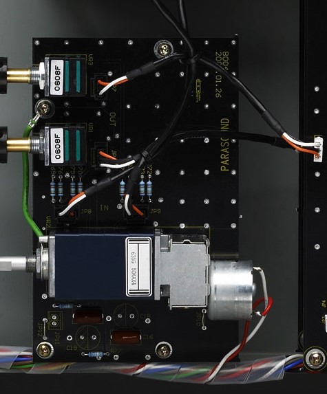

Main volume pot is 50K, not 10K.
OK, I've been looking at the 70's/80's schematic posted in the 2008 thread on the Chinese clones.
