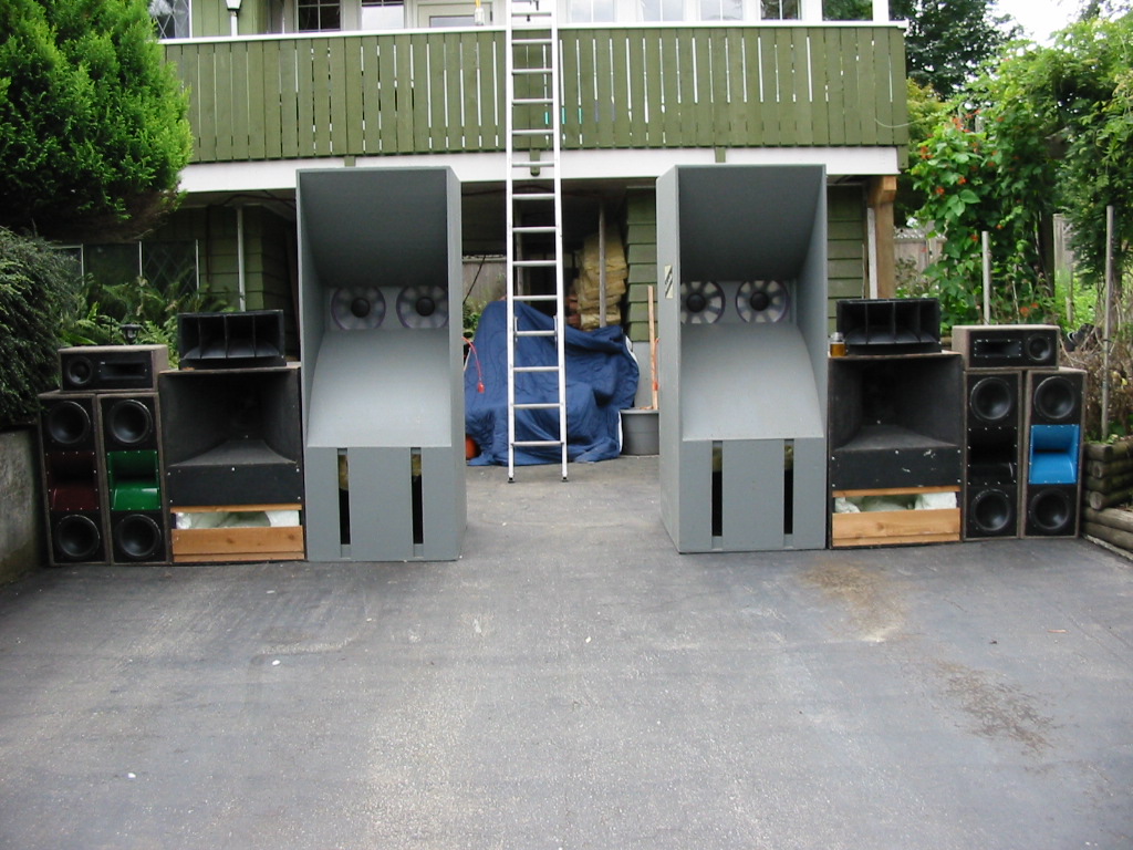

Ya but she makes me take them out to the driveway if I want to turn them up.And I am secretly jealous of those with room in their house for Fridge sized cabinets and 15" drive units whilst remaining married.
I have two out of six bedrooms taken up by speakers and drivers, and none of what you see in the driveway pic are kept in those rooms. I don't refer to it as a dedication but an addiction.Edit: some people have dedication well beyond what I could get away with.
My name is Cal and I'm a Speakerholic.
The ladder is for when he "sneaks" those big grey jobs up onto the deck. Unbeknownst to wife, 4 of the boards in the railing are removable, and align nicely with the vertical ports!
Wouldnt want to effect that reflex tuning with a board blocking the port, now would we
The bedroom turntable was veto'd so I just have 2 in the lounge and 4 in the shedTurntables.
I must have an exremely tolerant other half, 1 in the lounge, 2 in the front room (3rd bedroom) and 1 in our bedroom
I dare not ask why Cal has what looks like a pair of stadium Subs in his garage.
