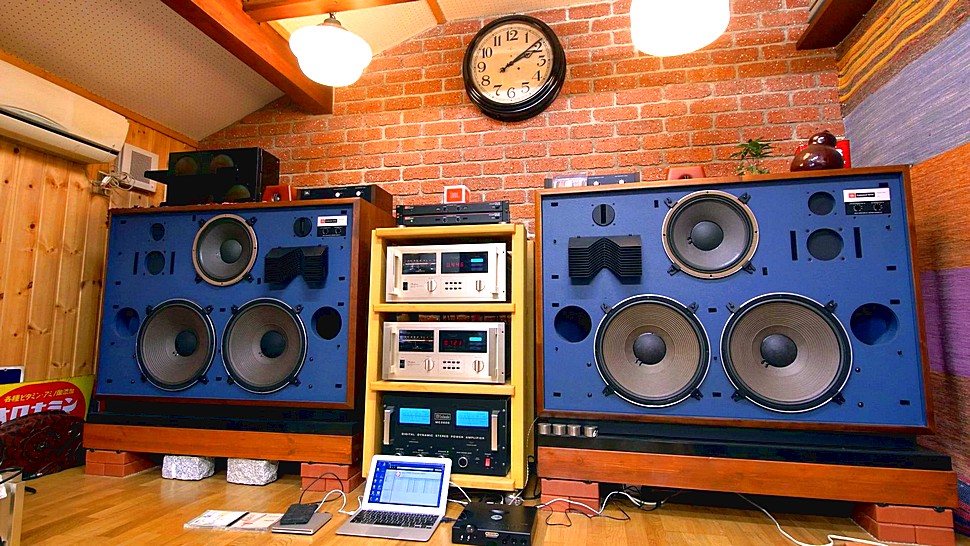

Although there is some very good stuff going on using the purifi woofer in the multi-way forum here. It's expensive but you can get some very impressive performance from a 6.5" woofer in the right cabinet. Handy for those of us without room for larger speakers. And I am secretly jealous of those with room in their house for Fridge sized cabinets and 15" drive units whilst remaining married.
Edit: some people have dedication well beyond what I could get away with.
