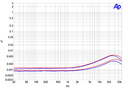

Looking at the stereophile numbers distortion starts to rise after 3.5v output but JA got numbers 1/10th of ASR. I think drive level too high and waaaaaaay above domestic audio levels. Different gain settings, very low load for ASR (Does anyone expect a domestic unit to drive 300 Ohm power amplifiers?)
Or maybe they want their preferred reference to look better?
300 Ohm is a typo, it was 200K. They have an edit with the correction. But testing at 4V is just wrong IMO. Hopefully John can comment on that.

I hoped you not looked at 1kHz only. 1kHz result is pointless. I care about that rapid rise of distortion with frequency.
https://www.audiosciencereview.com/...-n-vs-frequency-audio-measurements-png.74050/
This shows poor engineering, and reflects in IM and multitone plots. This may add some color.

Depends on your definition of "engineering". To me, the topology and the design are good, so I see only 2 options:This shows poor engineering, and reflects in IM and multitone plots. This may add some color.
- Either ASR did something wrong
- Or it's a faulty unit, maybe mismatched JFets: I've seen it happen, once (not with Parasound); so it could be a production issue.
Without a harmonic structure it is hard to tell, could be a mis-biased output stage too.
... I will see if I can find the significant increase in distortion with frequency. If I find it also, then I will look for the problem...
JA didn't, at least not to such dramatic extend as ASR, hence my option #1: maybe ASR did something wrong.

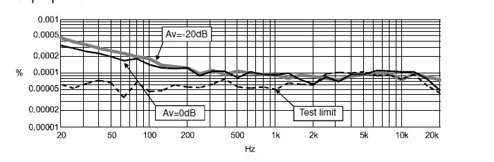

Simon: The challenge as you know is meausuring the THD* on its own as you are generally noise floor limited at that level. But the LM3886 based amps TomChr does are one example. Hans has just published his amplifier schematic that does fractional ppm. I still prefer to look at the 32 tone test results.
Attached some measurements from Bruno's G_word preamp at +18dBu. Basically measuring the AP noise floor. That is what I would like my preamps to do. Total and utter overkill but if you can...
* Whilst accepting that some of the greybeards here just think thats yoof being lazy and expecting the analyser to do it all with no brain required.
