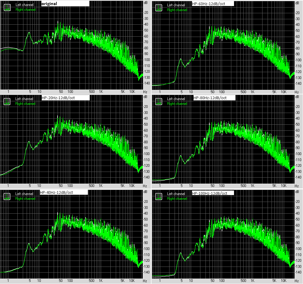

Now in an attempt to check the behavior of the elephant in the room, I used Bill’s link YouTube
Then using Audacity I applied 12dB/oct HP filter at 20,40,60,80,100Hz as a crude way of emulating the low cut-off effect of progressively smaller sealed loudspeakers (listen through headphones at first).

I wonder what that 4.5Hz blip was caused by? I need to lash up a new CD ripping setup so will see is that is on the CD.
Likely HVAC?
Why 4.5 Hz for HVAC though? Maybe a resonant mode in one of the pipes? The6 May be using a 2nd overtone fo4 the audible fundamental. Just guessing here of course.
With the 70Hz high Q smallish sealed loudspeakers I don’t lose anything compared to the OB+W sub, only sense of space.Hi George,
The 40Hz version is good enough for me to get the message from the composer.
The missing fundamental effect is very strong with organ notes (proper harmonic structure).
It seems to be a well build-up resonance in the Hall (maybe a mechanical resonace of the organ). I checked another Tonhalle Zurich organ recording and it is there. Same shape at 4.7Hz.>Edit also the one at 15Hz.I wonder what that 4.5Hz blip was caused by
There's always the mostly folklore articles about 10Hz resonances.😀
Maybe, but when the signal is flat to 1Hz I do wonder about the analysis. I've had some results with audacity I just didn't believe in the infrasonic region. In that case the analysis was slightly out but there was still some strange non-music down there.
Edit: Missed your post George. Interesting. Will google around to see if I can find out more.
Second Edit: Tonhalle got a new organ in 2017. less than 30 years for an organ is almost unheard of!

Ahh just thought about it again. Maybe a HVAC fan blade causing air turbulence - that would be circa 250 RPM?
