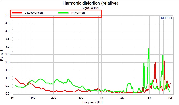

Things are moving slowly ahead. Sample 2 was clearly better than sample 1. We are currently working on sample 3.
attachment.php

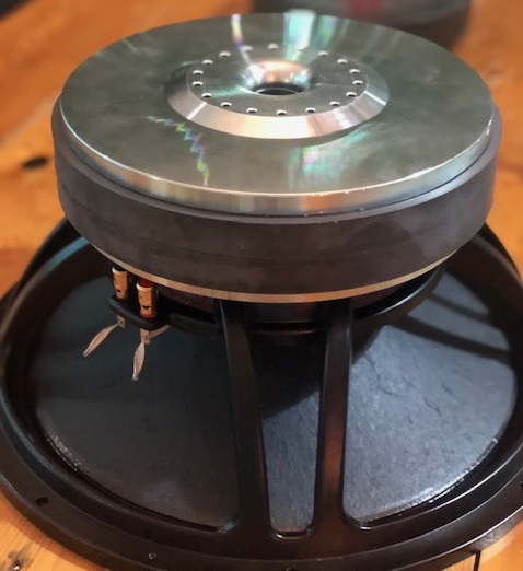

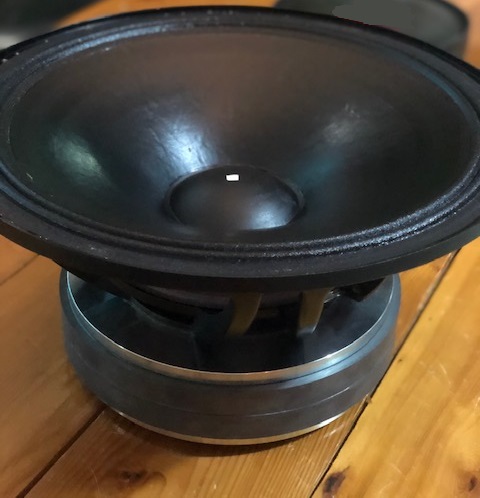

Sure!
This is the ferrite version. We consider a neo version a bit later, but the ferrite version turned out quite a bit better than we originally expected it to.
attachment.php
attachment.php

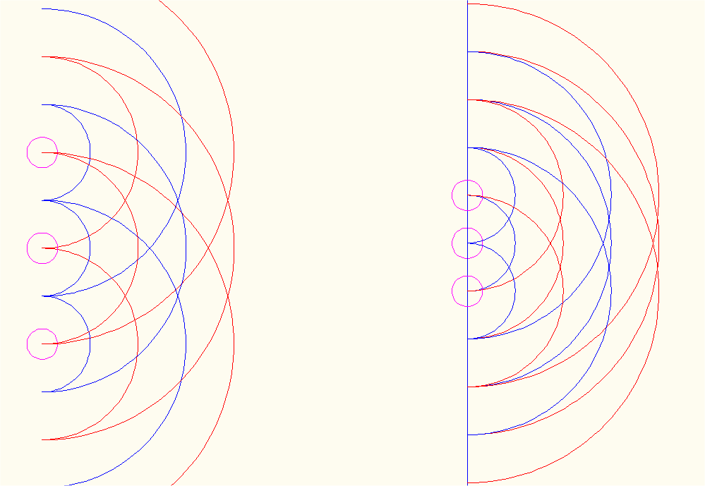

Uh-huh. You can't use a 15" in a line array above ~250Hz because of the comb filter effect forming at such great distances from the middle of the driver to the next.
I think I'd be more lenient than that (although only measurements would tell for sure). For one thing, the cones would be almost touching. If you wanted to argue that cone width is inconsistent with height, I'd suggest the regions between where the cone is 60-100% (+/-20%) of maximum is a half wavelength at 1500Hz.
Below is a drawing of wavefronts with 1 wavelength spacing vs 1/2 wavelength spacing.

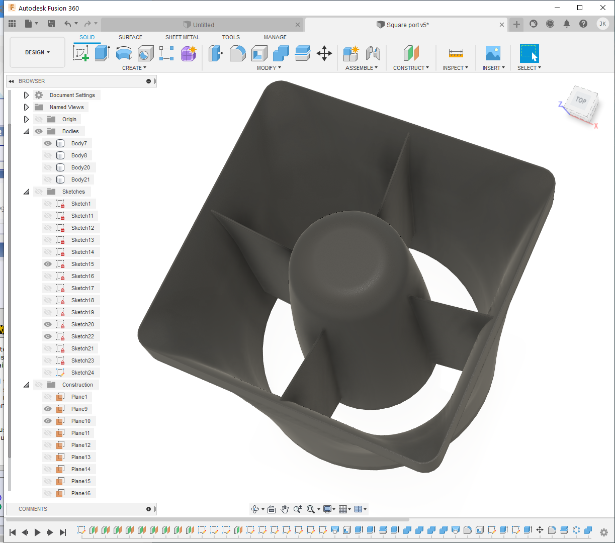

The idea is as follows:
- The system is compatible with standard ABS plumbing tubes.
- It is a concentric port with a core element to give the entire exit a larger circumference so that it can withstand higher flow speeds.
- The flare has a cross section profile that is exponential with a low coefficient so that the air speed is gradually reduced until it reaches the roundover. The cross section of the exit is therefore around 3 times the cross section of the tube itself.
- The core of the concentric tube is a closed ends quarter wave resonator that is designed to absorb the main mode of the main tube. It does this through a diffused part mid way through the tube. At this point the main tube has a pressure maximum while the inner tube has a node.
- The system allows for a slightly smaller tube, thus shorter, compared to typical ports. This raises the fundamental mode of the entire port. And since the fundamental mode is absorbed, the secondary mode, which is also raised due to the shortened port, will be around 2,5 times higher than comparable solutions.
I am planning to make documentation that describes the effective acoustic length of each part. I also plan to make laminar bends with separate ducts and larger radius to make the air less turbulent through the bend.
This is what the flare looks like at this point. It uses a 90mm + a 50mm tube, and the flare is 99x99mm with 5mm corner radius:
attachment.php
The flow out of the tube is different from the flow in a tube the same size without the inner tube. In a normal tube the airspeed is highest along the edge of the tube so in the turbulent region the airspeed is much greater than in the center of the tube. The core displacement tube makes another turbulent region distributing the high velocity airflow between two regions. The total high velocity edge of this tube is around 520mm while for a typical tube with the same cross section the edge is around 230mm. This means it can handle a higher mean velocity allowing for a smaller cross section of the tube. This in turn makes the tube shorter for a given tuning frequency.
