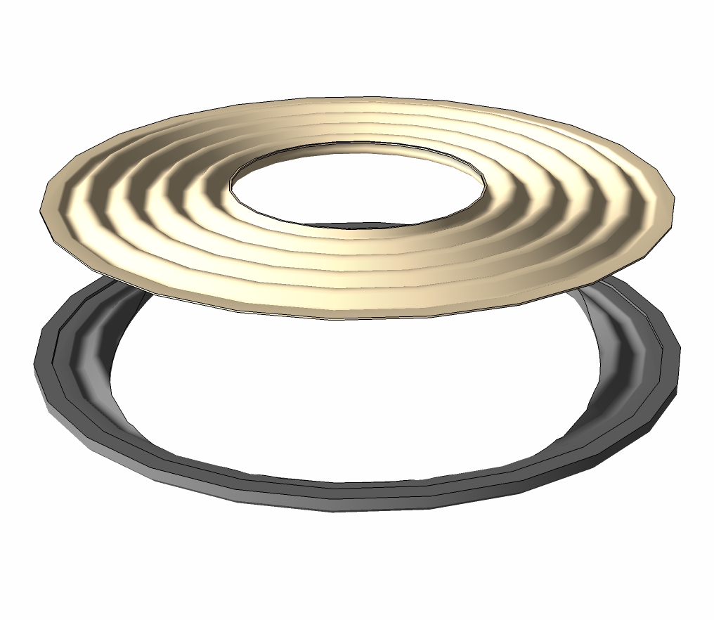

By adding this oval ring, and gluing the spider completely to it,
The only challenge I'd have would be to ensure sufficient glue area and strength, and enough overlap past the ring to ensure that it doesn't rub, but this is certainly an interesting idea.

I have been thinking about this, and I think the solution is pretty safe:
As you can see, the shape of the ring (where it is in contact with the spider) has the exact same shape as the spider. The spider should, off course, be fully glued to the ring. Any missing glue could quickly turn into some noise.

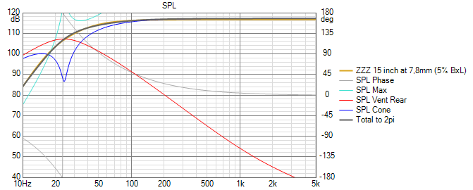

So, while the first samples are finally being built, I would like to clearify for those who might still be confused about doppler and IMD:
Doppler distortion vs IMD? - PURIFI
First sample has been built. Magnets are off, mass is off and suspension is slightly off. But the response is not that bad after all.
The dip at 320 is measurement chamber related. This is a driver with too thin cone, and extremely low damping.
