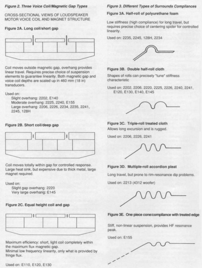

Then we should turn our focus to the suspension itself, and here we have some choices to make, two of them being especially important for the effect of jumping resonances:
1: The compliance of the suspension decides the drivers Fs. It also decides how well the driver controls DC components in the driver. By selecting a motor geometry that removes DC components we are left with a more free choice of Fs. We could lower it to an extremely low number, but it could create some issues with the midbass, as well as making the driver vulnerable to transients. A well balanced response is what we get when Fs is placed around 20-25Hz. However, the combined resonance is 48Hz, so the box dominates the capacitive components. So at low excursion, the suspension contributes very little to the total resonance.
2: The progressiveness of the suspension is another factor. If the suspension is very progressive, it will quickly become the dominant capacitive factor. Achieving a constant compliance over a large excursion range is therefore a crucial goal. The easiest way to achieve this is to use suspension with fairly long excursion capacity. The spider has a large outer diameter of 8 inches, and, off course, a 3 inch inner diameter. The distance from the bobbin to the edge of the suspension area on the spider is 60mm. The surround is not that wide. It has around 35mm between inner and outer fixed points, which is not bad either, but far from the 60mm of the spider. If the surround is stiffer than the spider, it will become the dominant capacitive component of the suspension. But since it is not as wide as the spider, it will also typically be more progressive. Therefore, the spider should be the stiffer suspension component, while the surround should be the softer one.
There are also many different profiles to choose from on surrounds. The so called "Double half roll" type is one of the more suitable variant for drivers that are intended to deliver both bass and midrange performance. This is the one selected so far, but I am awaiting some adjustments on this. JBL has also made some pointers on this issue. You can read about them in the right column here:

So I made a quick rendering, just to see what it will look like with a conical trim ring. I think that could be beneficial for the high end of the frequency range too...:

So the frame I went for is not the kind you would think of for a "5000W car audio competition subwoofer", but rather a transparent one that is far more sturdy than we would ever need, and in addition has some decent openings for air to escape from under the spider. It also has the necessary depth I need from surround landing to spider landing for a 15 inch cone with 3 inch voice coil (which naturally has a deeper profile than what it would with a 4 inch coil), good height from spider landing to motor mount to allow some serious excursion before something is damaged, and last but not least, a spider landing of respectable 204mm to allow for a more linear suspension.

I am curious where we can find that aluminium basket and woofers as shown in the pictures, do you have any web link or name of product/manufacturer to share with us?
